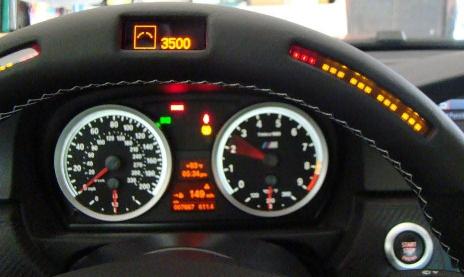

It' a pity 6MTs don't get them too.
Try the BMW Performance Steering wheel.

Are you happy with yours? It looks pretty cool and is the only way I know of getting a real oil temperatue reading.

Mine start coming on at 7000 rpm. DCT FTMFW with shift lights.
If the shift lights are real important to the 6MT guys, they just need to get a PW and the DCT shift lights MFW becomes equalized! :D

Make sure that you have enabled Shift lights to be On in iDrive. I forgot which menu it is exactly, though. And the others are right, they only appear at the high rpm range...and when they appear, they light up green, yellow, red...incredibly fast that it's probably time to shift as soon as you see the first yellow light, because of your late body reaction time.
i have used them but problem is that you need to be paying attention as it goes green/yellow/red instantaneously assuming you have floored it...sometimes I leave it on D5 instead of S5...let the transmission shift at 8300+ ...
Poppin Fresh wrote
It won't light up till you hit the 8 mark but when you do, just hang on.

This is what the PSW is for.
