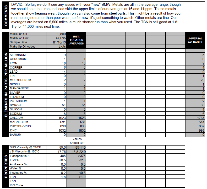

Just had my first oil change and test done after picking up my '08 this summer.
47,695 miles on engine and 9,800 miles on the oil. I drive it hard, but no track (yet).
Comments: DAVID: So far, we don't see any issues with your "new" BMW. Metals are all in the average range, though we should note that iron and lead skirt the upper limits of our averages at 16 and 14 ppm. These metals together show bearing wear, though iron can also come from steel parts. This might be a result of how you run the engine rather than poor wear, so for now, it's just something to watch. Other metals are fine. Our averages are based on 5,500 miles, a much shorter run than what you used. The TBN is still good at 1.8. Try for 11,000 miles next time.
I feel like 10k miles is the sweet spot to get good value out of our oil without over-using the filter, so that's probably the interval I'll stick with.

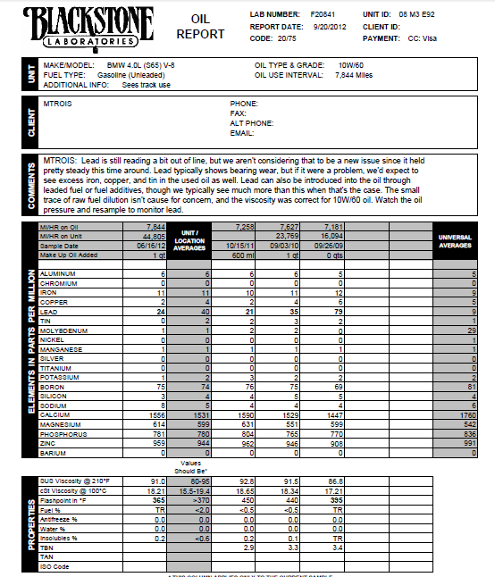

MTROIS wroteThanks for posting.Here is my latest report at 37,000 miles
What is to be inferred by the continual drop in lead ppm in successive measurements? 79 @ 16k miles, 35 @ 24k, 21 @ 37k.
"Lead is still a bit high to be considered normal, but
we'll certainly take the improvement--especially considering where it started out back in 2009."
Going to send mine out shortly... Not looking forward to seeing the lead score.. This seems to be high in a lot of these oil reports.

Here is an update (note that I had about 6 track days on this one):
MTROIS: Lead is still reading a bit out of line, but we aren't considering that to be a new issue since it held pretty steady this time around. Lead typically shows bearing wear, but if it were a problem, we'd expect to see excess iron, copper, and tin in the used oil as well. Lead can also be introduced into the oil through leaded fuel or fuel additives, though we typically see much more than this when that's the case. The small trace of raw fuel dilution isn't cause for concern, and the viscosity was correct for 10W/60 oil. Watch the oil pressure and resample to monitor lead.

davesaddiction wroteGood question!Thanks for posting.
On the one hand, I think that the very high value was due to my using of a few galons of leaded fuel at the track because of a stupid mistake.
On the other hand, the Lead content has been high all along....
See comments from Blackstone in my next report.
I just hope that this is not a sign of excessive wear with the '08 model year.

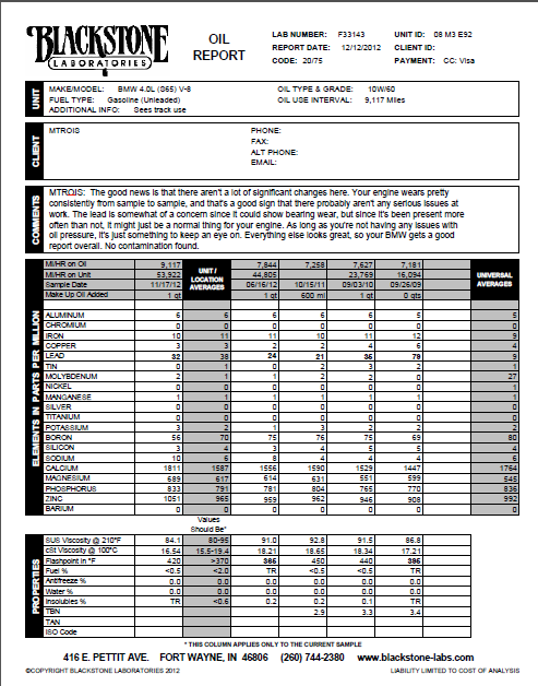

Latest report at ~54,000 miles (note that I had about 5 track days on this one)
MTROIS: The good news is that there aren't a lot of significant changes here. Your engine wears pretty consistently from sample to sample, and that's a good sign that there probably aren't any serious issues at work. The lead is somewhat of a concern since it could show bearing wear, but since it's been present more often than not, it might just be a normal thing for your engine. As long as you're not having any issues with oil pressure, it's just something to keep an eye on. Everything else looks great, so your BMW gets a good report overall. No contamination found.
Wow that's great flip, 1 lead!!

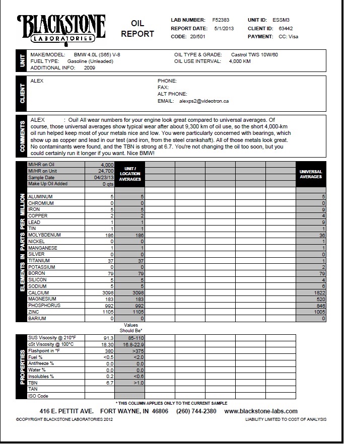

Time to start a flame war.
Has anyone else noticed that almost all of the Castrol TWS 10W-60 UOAs come back showing lead (bearings) in the wear metals? I've had three analyses of Redline and never a detectable level of lead.
