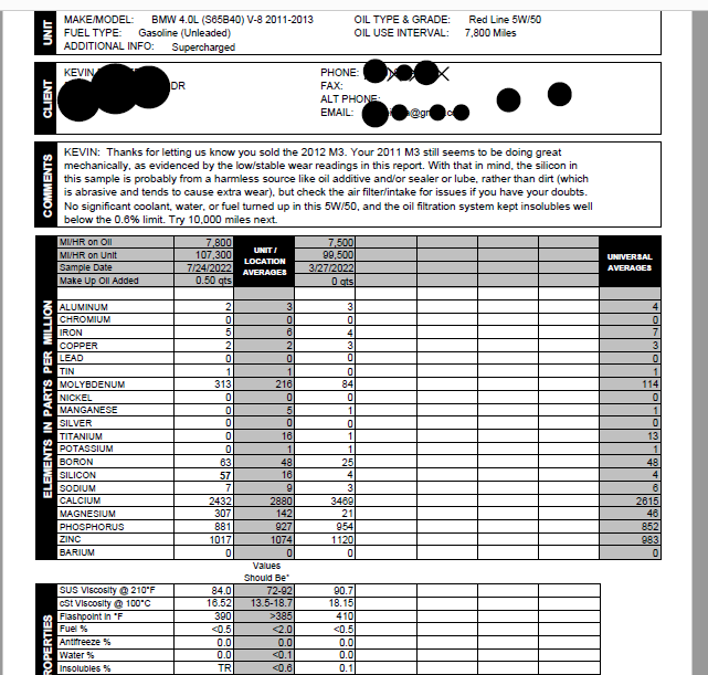

Just got my first oil report back on Rocky since moving the car from BMW 10w60 to Red Line 5w50. Seeing high silicon levels which can either be due to an additive in the Red Line oil or dirt passing the filter. I am using a Pipercross foam filter and wondering if anyone else has run into high silicon levels, and whether they are running a foam air filter or using Red Line. Or in my case both. I perused the thread and didn't see anything to guide me. Have a question into Red Line and sometimes they do respond.
Pipercross has some guidance for track use only on some of their filter products but my understanding is it doesn't apply to the one I've got installed.

Spoke with Pipercross and they confirmed the px1828 is designed for daily driving and that they do run into counterfeit parts on the market. I had purchased mine from an eBay reseller and it's a risk.
Spoke with Red Line and they confirmed that the expected value of silicon in 5w50 is 20 for the additives they use and that because they don't disperse a sample may measure higher. Similar narrative from Blackstone.

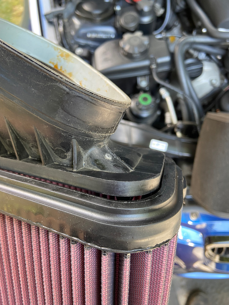

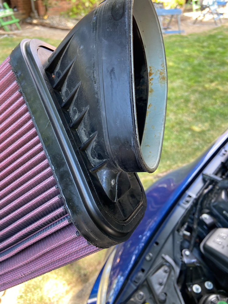

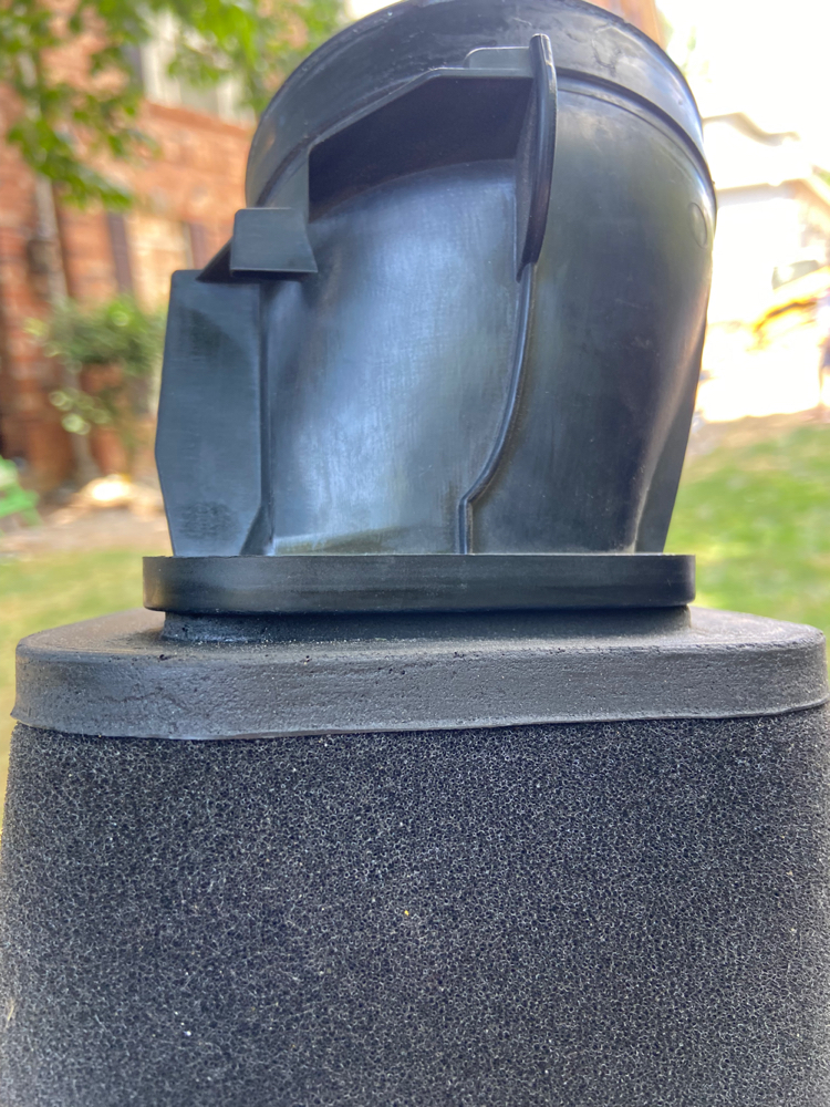

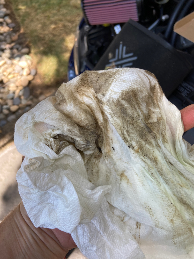

I have never liked the design of the air filter and how it essentially presses against the plastic adapter on the engine side of the intake and is sealed and held into place by a spring tension on the edge of the airbox. I decided that 70ish on the silicon was a little too high for my comfort (meaning I felt the risk I was pulling in unfiltered air and dirt was too high ) and purchased a K&N filter as an alternative.
Pulled the airbox and filter mechanism apart this morning and put my hand inside the intake elbow: Grit. No bueno. Cleaned that out and installed the new filter. Was pleased to see the K&N has a different design and snaps into the plastic adapter with a rubbery seal and I think significantly reduces the chance for unfiltered air to get sucked into the intake. Now I wonder if this is the OEM design. Glad I follow my oil reports, this condition could have gone on a lot longer.
Pictures show the dirty towel from the intake, how the Pipercross as purchased simply presses against the intake adapter, and how the K&N fits snugly into the adapter well enough to defy gravity and then some.

Nice job finding and eliminating the source of all that dirt getting into your engine. I always hated foam filters for any kind of street use for this reason. I've seen way worse levels of junk getting through foam filters even when they had zero leaks around them, the typical JDM brand ones are the worst.

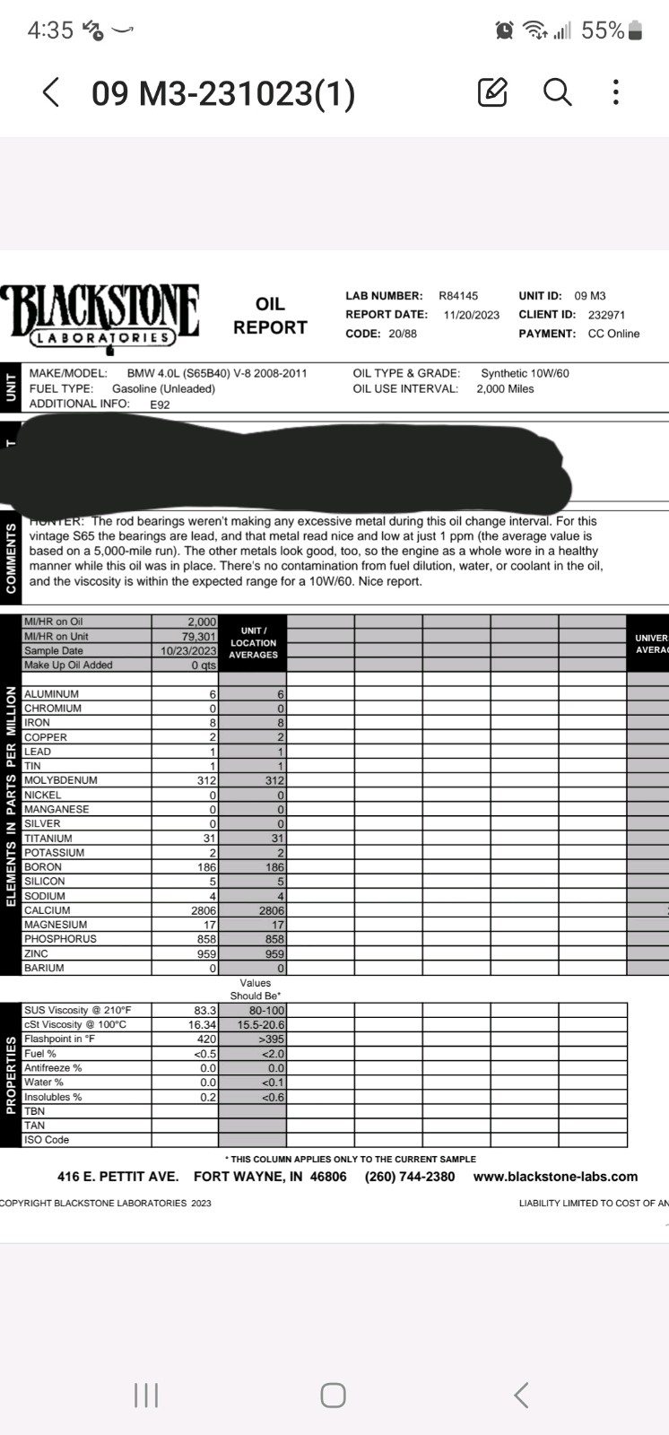

Hasn't been alot of activity on this thread lately so hopefully I'm posting in the correct thread... here's my results, from blackstone as you can see they said everything seems A Okay. Just wanted to get M3post's take. Thanks
The numbers don't show any obvious signs of trouble. That doesn't necessarily mean everything's fine; just that there's no evidence of a problem on the oil analysis.

On a real note, I was mainly just interested to know about the wear on the RBs. They were replaced a couple thousand miles prior to me purchasing it but they had used OEM bearings so I was just interested to see what the analysis said.
AlpineE93 wrote
Don't rain on my parade :bellyroll
Since 2010/2011, OE BMW bearings have been of a lead-free type. You'll see a lot of people saying oil analysis can't tell wear on these bearings, but that's an overstatement; the truth is we don't know either way.
That might be because these rod bearings don't seem to wear significantly. People assumed they did because they discolor with use, but it's recently been shown that the discoloration is superficial. It doesn't seem like we've ever seen a set of these rod bearings in a critical wear state in anything like normal use.
The thing to look for would be aluminum and tin spiking together in a roughly 9:1 ratio. Theoretically, lots of other things in the engine could produce those metals; in practice, these engines don't seem to spike aluminum for any other reason. And, let's be honest – if you see an aluminum spike, you know you'll be opening up your engine anyway no matter where you think the aluminum is coming from.
Or you could wait for copper. That'd mean the top layer of the rod bearing has worn away, exposing the last-ditch intermediate layer. Though, if recent evidence is any indication, you'd be waiting a VERY long time for that.
Either way, the current OE rod bearings seem fine, so... you're probably fine. Go ahead and send it!

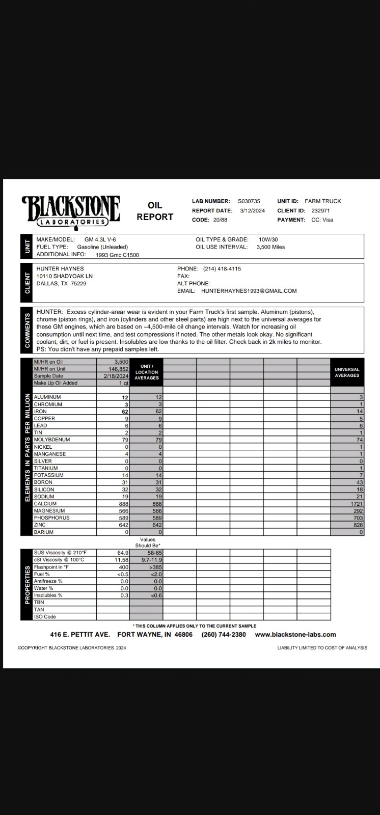

For shits and giggles, here's my oil analysis for my 93 GMC C1500
