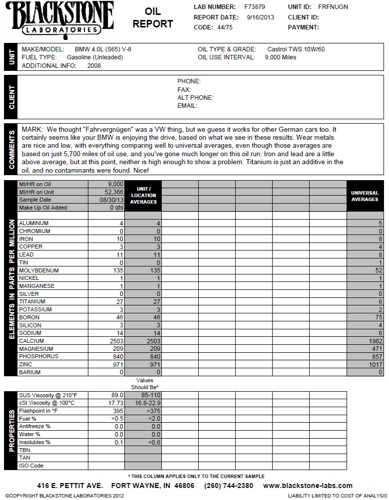

Blackstone report was received today, copper/lead readings are abnormally high as expected:

The Blackstone report says it all, good to know, thanks for posting Tom.
Last oil report. Pretty much identical, which I guess is a good thing. Now switched to Mobil1 0W-40 and will run it for 5k miles.

Just changed my oil today and will be sending in sample to black stone. 2008 with 68k miles and this will be my first sample.
Just got mine today. Only been doing 15,000 mile oil intervals. This makes me wonder if I should shorten the interval to 7500 at all :confused2

Received my oil report today. After 4000 km on the oil and nine months later, viscosity at both 40c and 100c is lower than specified by Castrol in their whitepaper. Disregard the reports comments on viscosity. Apart from that, it's all good.
Are you being sarcastic? The report says that even at 15k miles your oil looks great and they suggest running even longer.
Here is mine I just got back. 68k+ miles on my engine. Little worried about the lead but Ill see what the next report says.

Because your copper level is above average, that's why. I never pay attention to what they say about extending the oil mileage.

Yea that lead is a little high for sure. IMHO, I'd shorten the interval to 5k and send a sample again and see what the levels are. If it goes up (copper too), then it's time to save for a rod bearing job unfortunately.

I'm not a pro by any means, but from what I've read here, the rod bearings are coated with lead and copper.
If the rod bearing is really worn down like int he picture, it'll show up as high copper level. If you look to the left, that other set is also worn, but not all the way down to the copper yet.
In summary, usually lead and copper should go hand in hand if you have rod bearing issues. But if the copper is way high, then you really are in the critical area.
I'd recommend either going to a lighter oil, or if you want to stick to TWS for warranty reasons, lower interval to 7500mi. Just keep doing the lab tests and keep an eye out on those 2 items.
