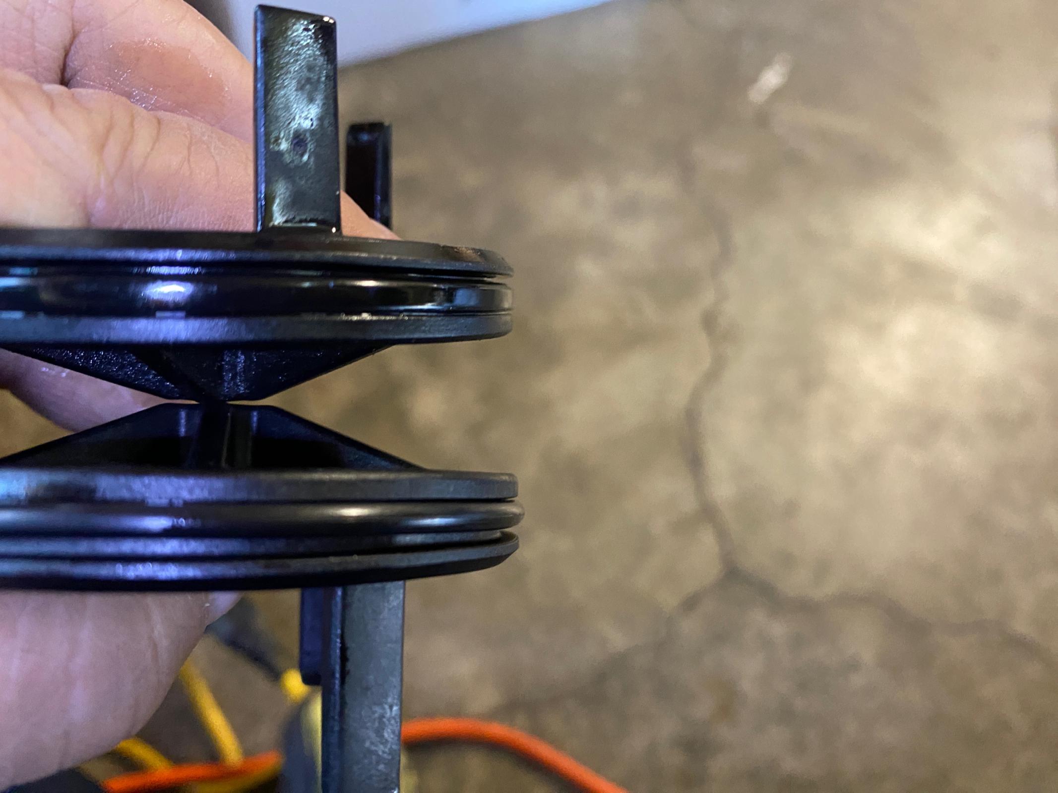

Tip: never re-use the filter cap, the o-ring will eventually harden up and go flat. The pressure filter was leaking bad enough that I would drop about three tablespoons of fluid at startup and God only knows how much I dribbled all over creation before I parked it in October.
That is one flat o ring!
