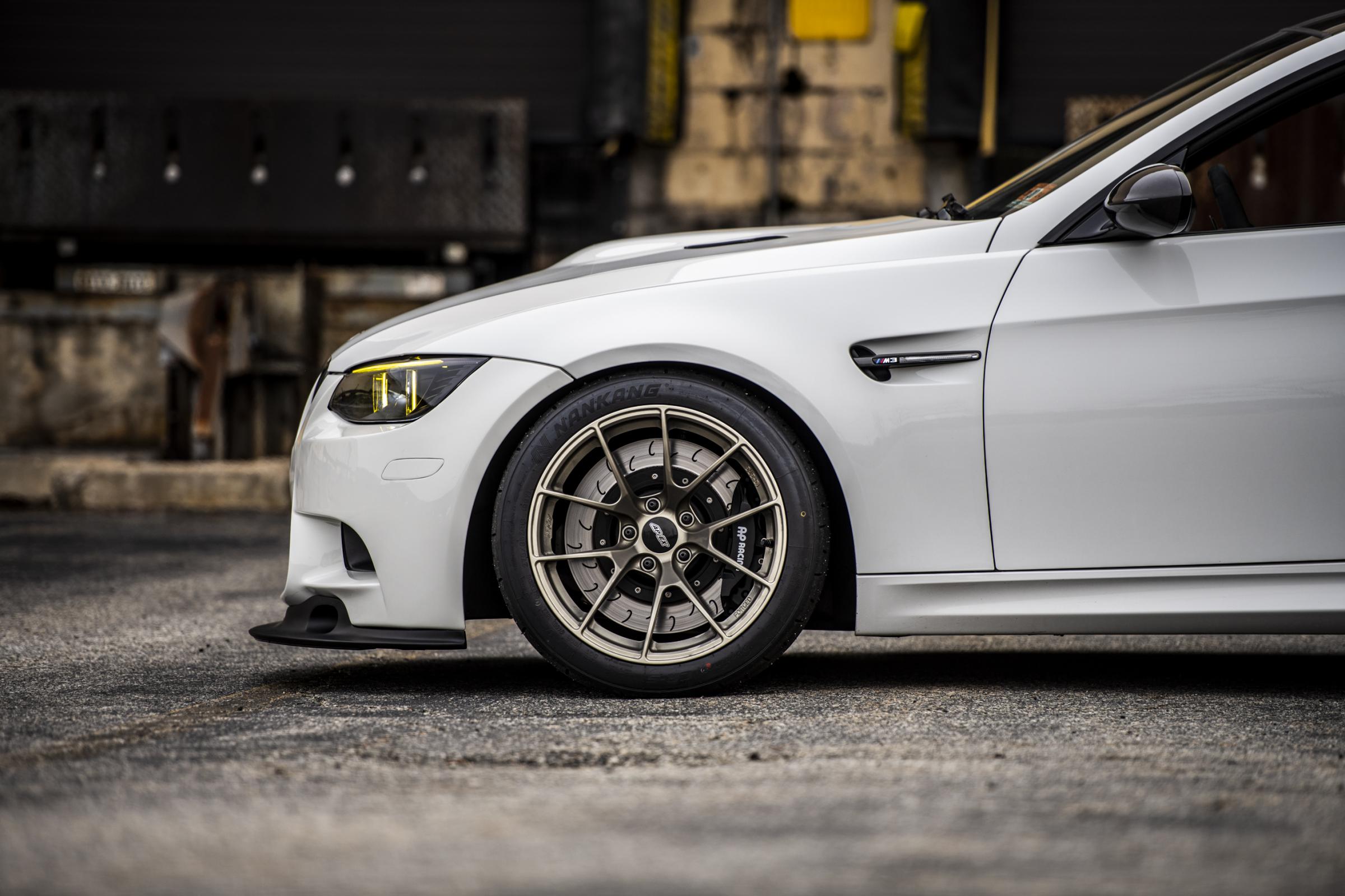

M3atman wroteSorry for the delayed response here. Any Idea if the STR60 Trophy kit uses the same brake clearance template as the ST60 380mm kit?Do the 18x10 et25 ARC8s clear the Stoptech STR60 Trophy kit?
Anyone running this?
I can’t for the life of me source a solid template for the new trophy kits. Our V1 ARC-8 (used wheels) needed a 2mm or larger spacer for spoke clearance against the standard ST60 380mm. I can check the V2 wheel which we sell currently to verify clearances if you’d like that info, but it applies only to the ST60 kit: https://centricparts.com/SiteData/media/MediaLibrary/Files/WheelFitment/98-160-26D0-01_FP.pdf

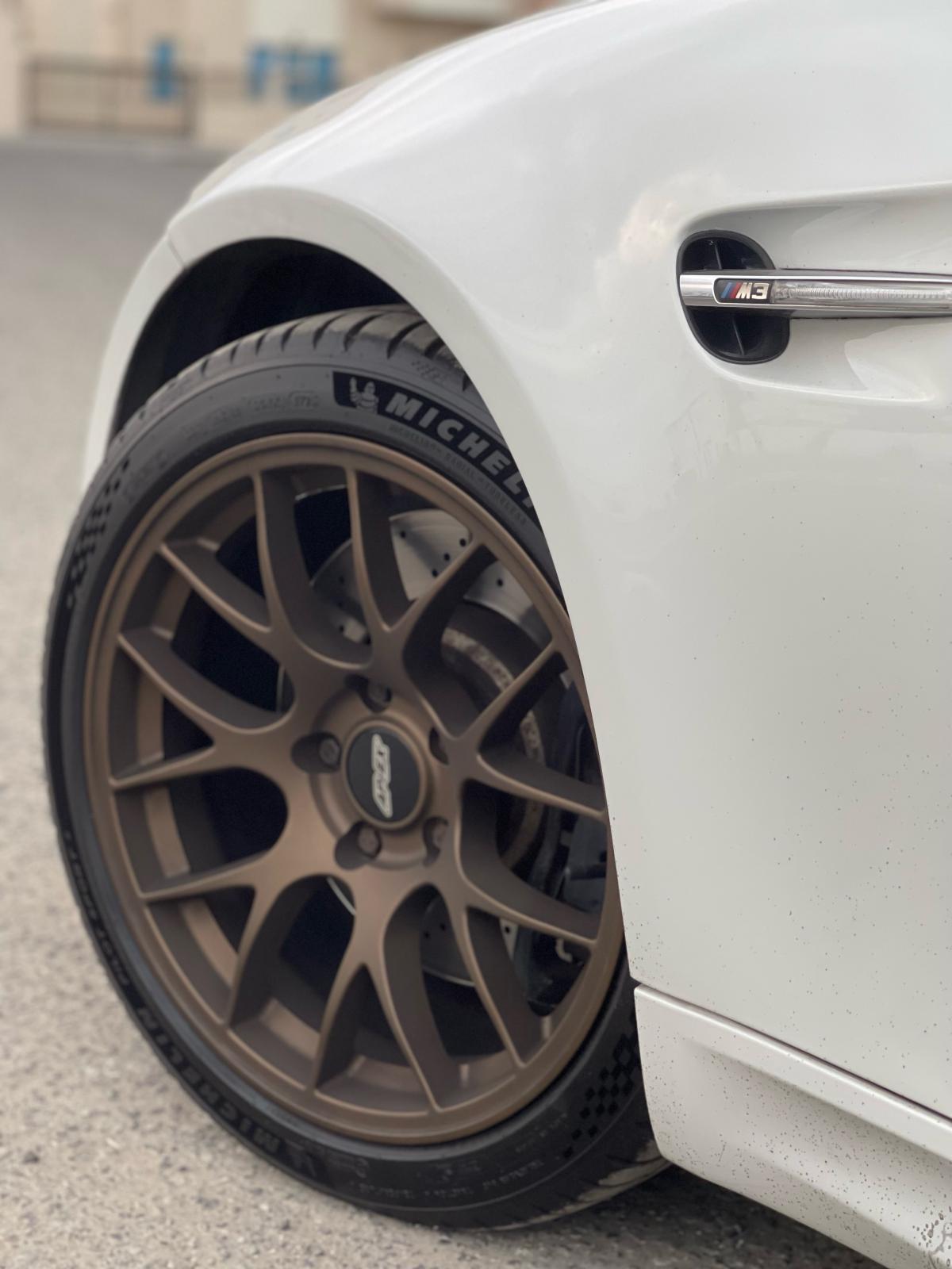

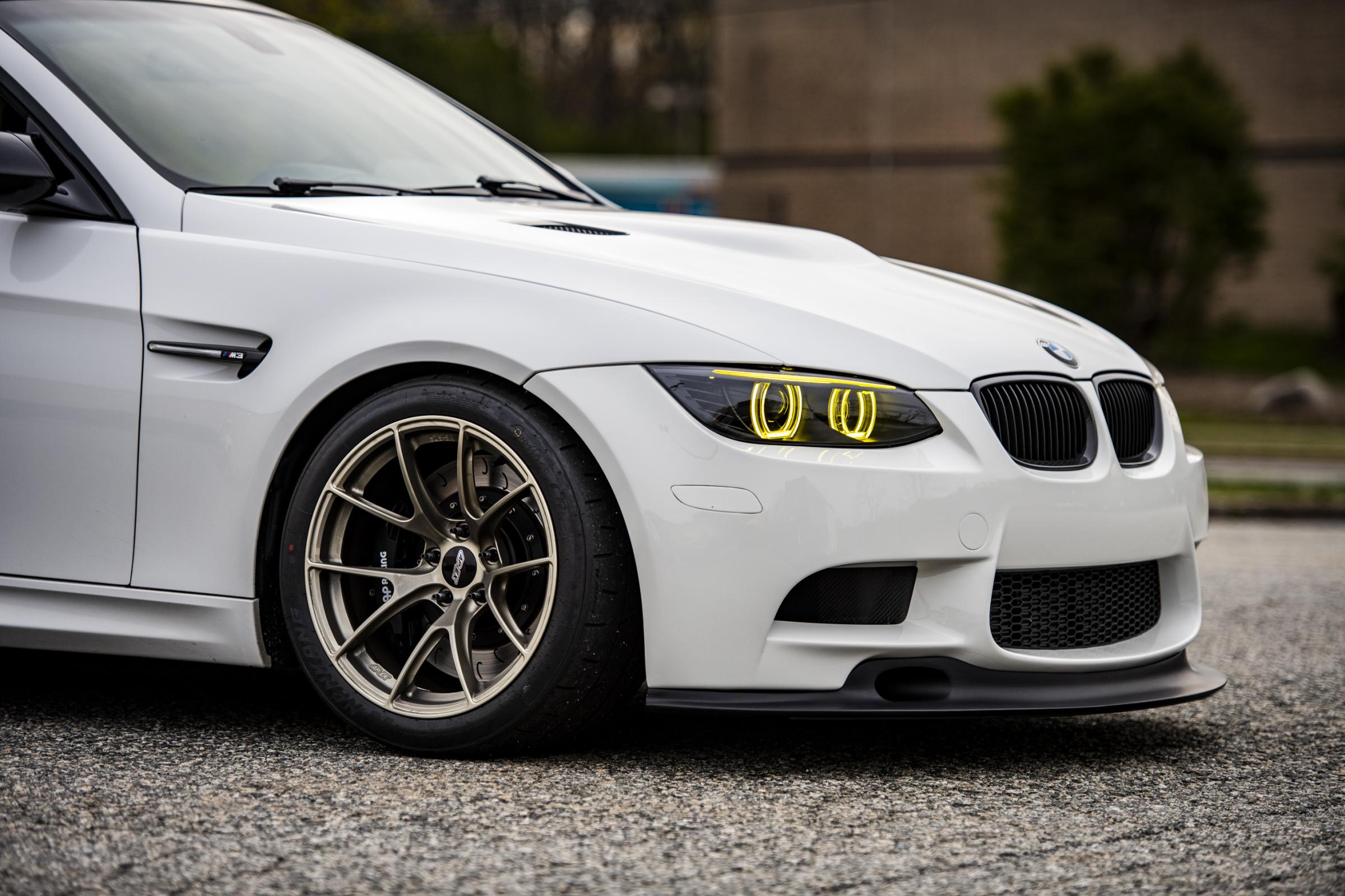

Both square and staggered setups will be more flush than the OE, although some customers still choose to run spacers as you can see from this gallery thread.
