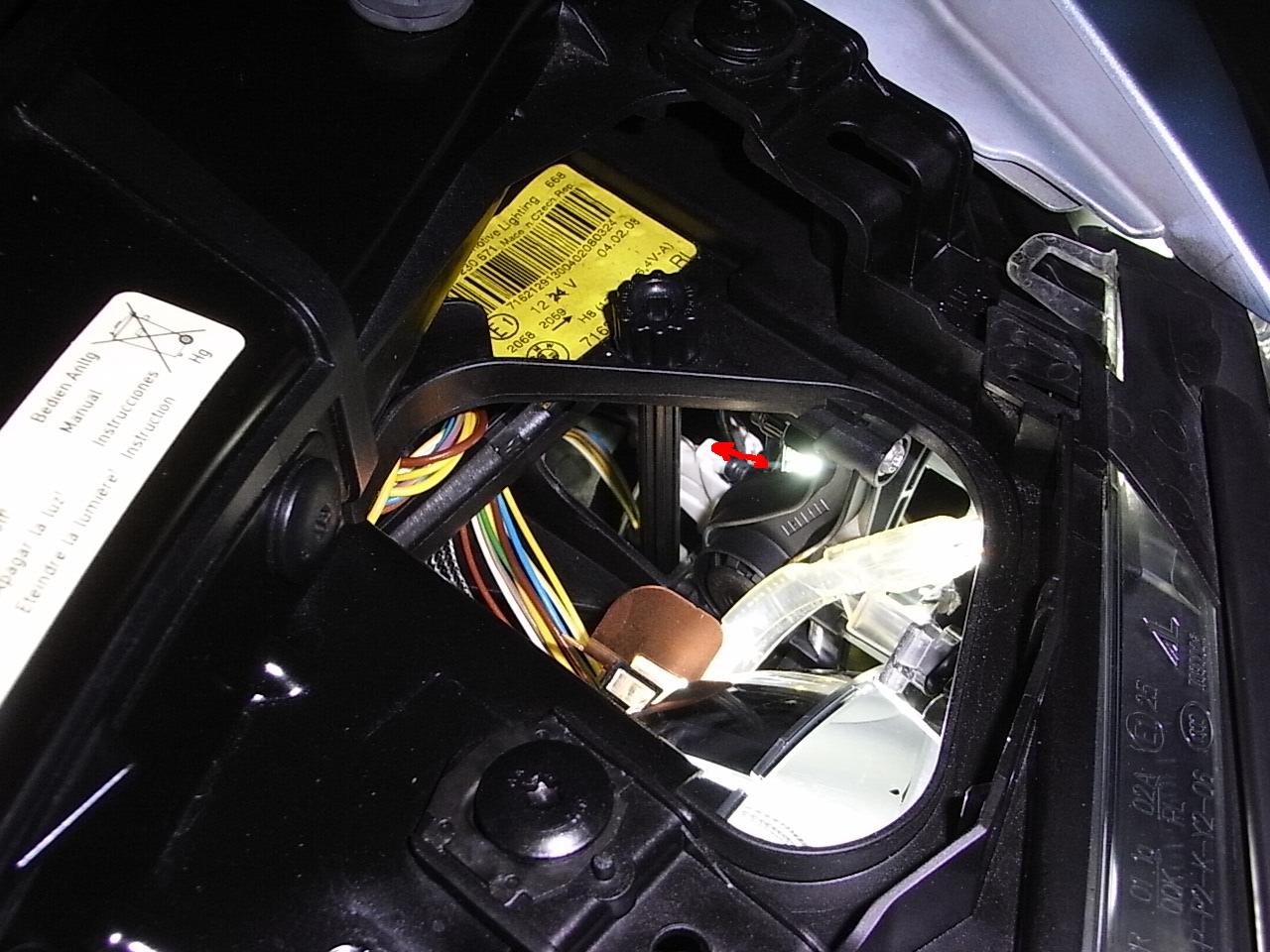

Open the cover on top of the headlight.
Pull or push the white lever up or down until you hear a small click!
Do it gentle, the part seems not solid.

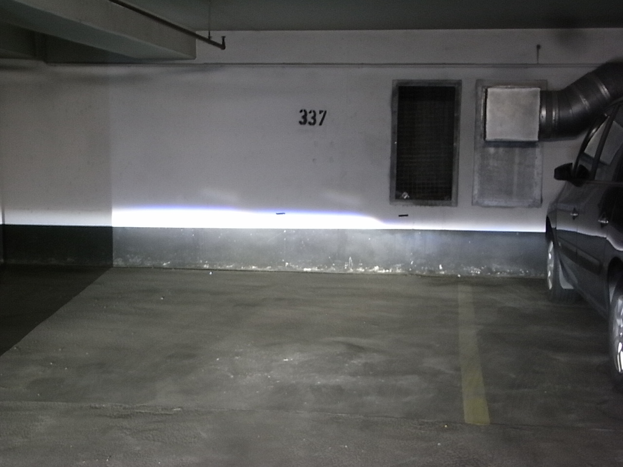

Your lights should be like this at the beginning (mine is a RHD so the left side is high).

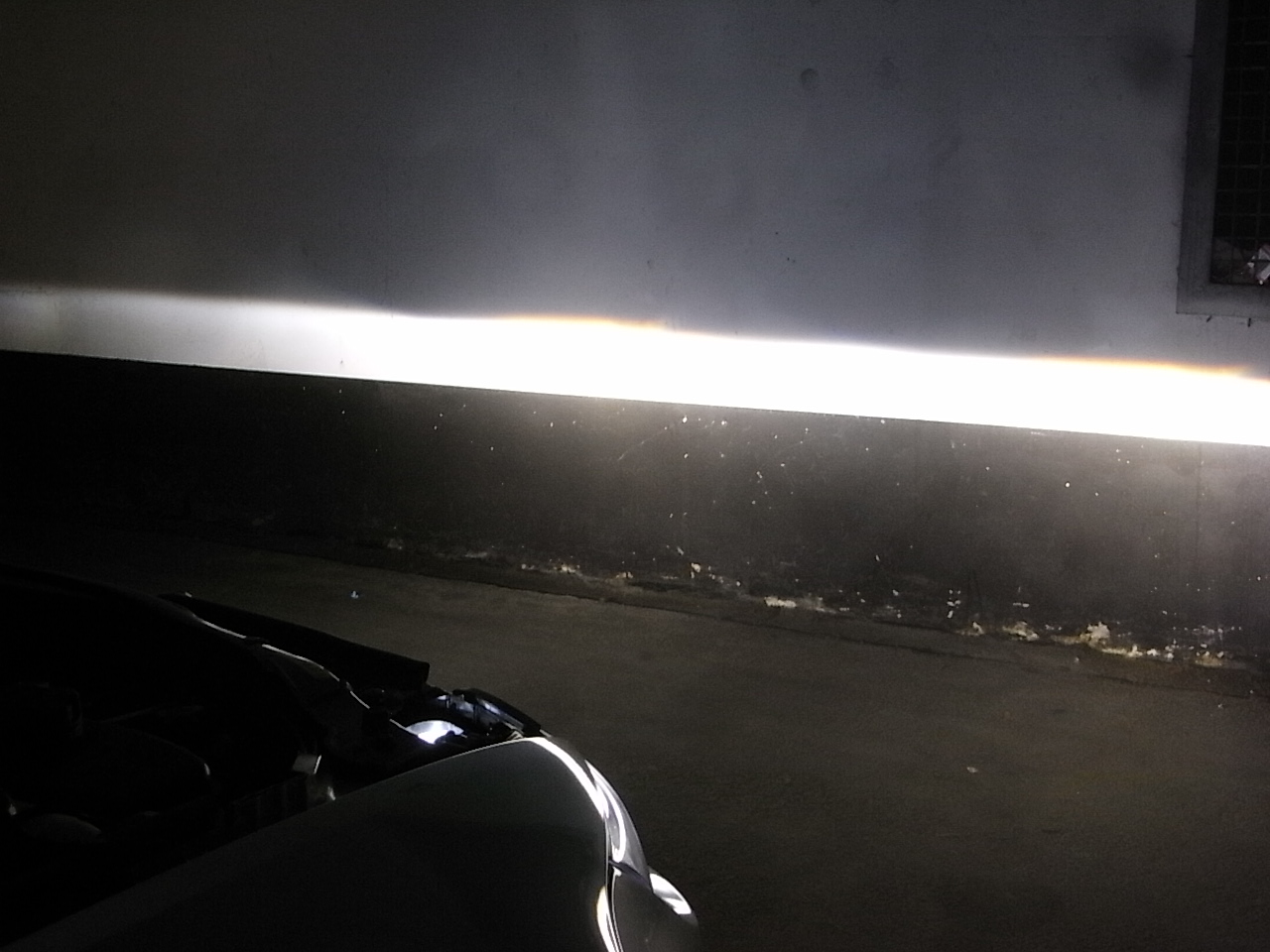

and after moving the lever on both sides, the cut become like this.
If you find the lever, it is a 1 minute thing.
