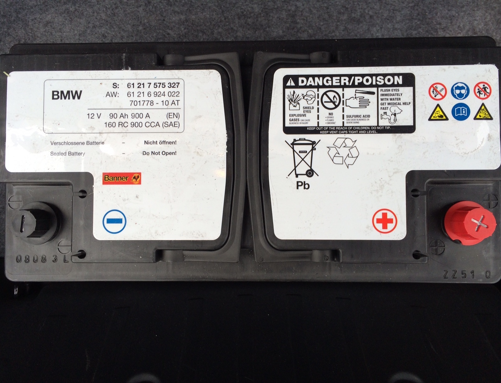

Ok so I'll just put my 2 cents on this older forum, I recently purchased a 2009 e93 and one thing that I have been noticing is the thing kept dying if I left the door open for less than 5 minutes, so I decided today to go get a new battery. I have a local indy I started using with this car and he is the best! He recently installed 2 new front control arms, a new leveller sensor and back plus alignment for $550! Anyways, I pulled apart the rear panels in the back and noticed my battery is :
S: 61 21 7 575 327
AW: 61 21 6 924 022
Which I have gathered is an AGM battery so I went over to my local autozone and bought the following:
http://www.autozone.com/batteries-starting-and-charging/battery/duralast-platinum-battery/319459_0_0/
Was a perfect fit and was the same 900 CCA as the oem battery I was replacing, only difference is the autozone battery is 95 ah whereas the oam battery was 90 ah, hope that's not a problem. I went to the great indy I mentioned earlier and he registered for me for free! I tipped him of course and will definitely be using him in the future!
Anyways, just wanted to share my story and hopefully help others going forward!
