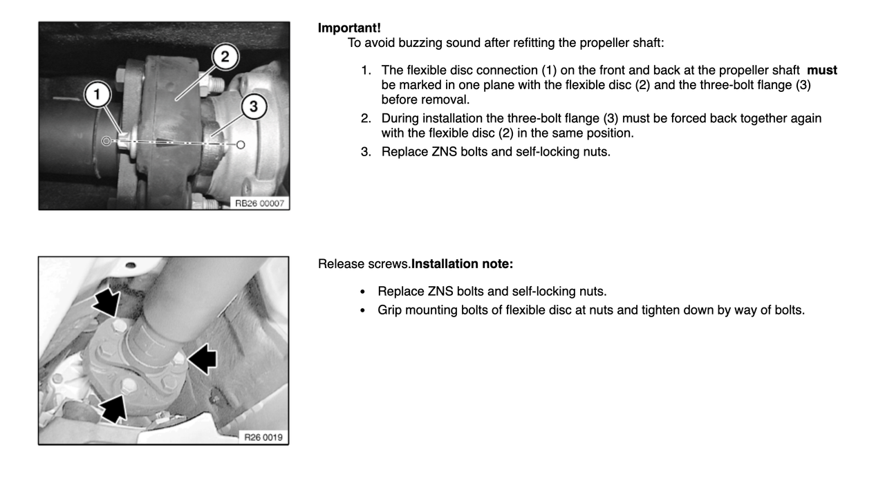

I can't say if this will help but have a look here:
https://www.newtis.info/tisv2/a/en/e...-shaft/GdAZqXJ
(you need to register to view manuals, it's free)
It says one should replace the ZNS (zink plated) bolts.

That TIS refers to installing the old DS with the old flex discs. The metal inserts must crush a tiny bit into the output flange and they want it pit back to the same spot. I have a brand new shaft, flex discs and bolts... No way to mark those and install in the same place as old one. Plus I don't have a buzzing.. it's a whirring or howling noise.
I am going to put it on the lift and run it cold to 30 mph and see if I can pin point the noise
