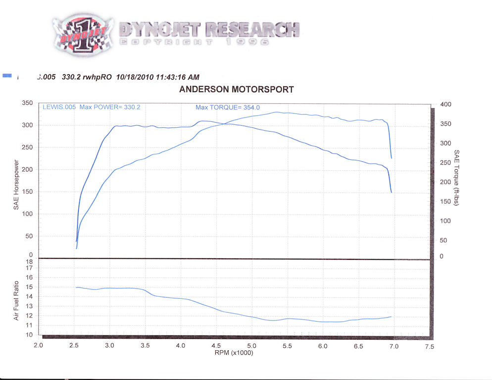

I notice a few of the dynos have the torque and HP crossing lower than others. It seems most cross at 5250 rpm(I heard the reason but cant remember right now) What causes the others to cross at lower rpm?

You're correct that HP and torque cross at 5250...
I believe the answer to this is in the formatting of the dyno graph.. Notice that, on a given horizontal line, HP and TQ values can be about 50 apart.

I guess that makes sense to a degree, but the Dyno Dynamics one crosses under 4000 which wolld mean quite a large variance. Is there some other factor that would chnge the 5250 number?

Are you referring to Qmax's on page 1? If so, the torque is apx. 90 units higher than the HP at the same X-axis. The TQ/HP will always cross at 5250.

they shouldn't ever cross at any other number....
HP is a number derived from Torque (foot pounds) x RPM / 5252
Thus at 5252 on every graph, torque will equal hp
