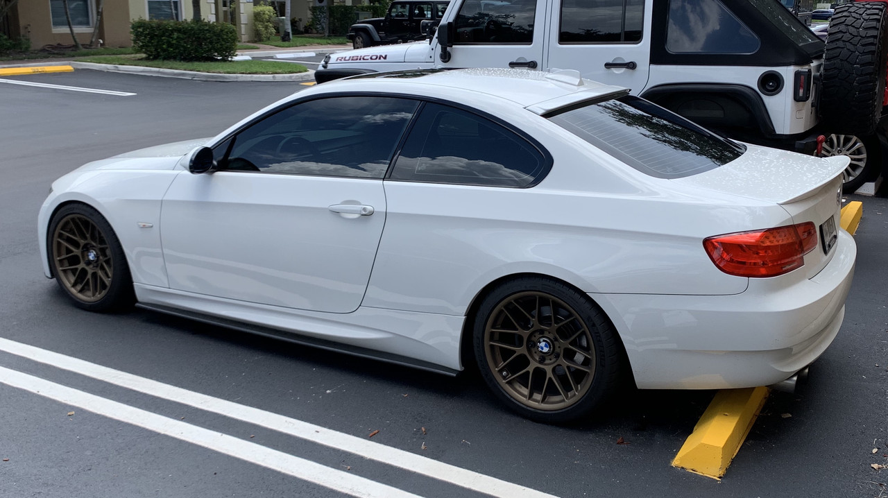

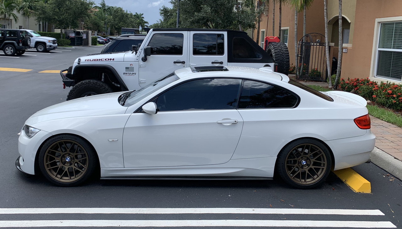

Update: I finally got around to getting the tint (re)done. I did 15% llumar ceramic tint all around. Love the tint... and hated the way it looked in the dot matrix area at the top of the rear window. So also grabbed a $85 pre painted rear window spoiler off eBay which covers most of the dot matrix.
