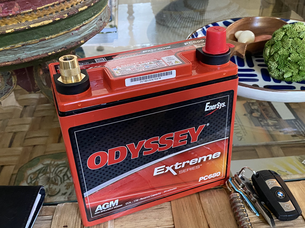

UPDATE!
Ok so time for an update to this thread. I was considering a supercharger but decided to go a different route due to all the tuning issues a lot of guys have had with getting my mod combo to work with superchargers on the n52. Also my car is already as quick as all the supercharged 328i cars I’ve seen posted on YouTube and still completely reliable.
So I rejected the idea of the SC for now at least. I don’t want to take a chance with affecting reliability at all. So having kind of thought I would take it a little father and planned on spending some $$ I went a different direction and started focusing on weight loss.
I didn’t want to take anything from the interior or strip out the car. So I’m focusing on weight loss outside the cabin only. Keeping the tools and all trunk liners, all the seats. Nothing that would compromise the cars use as a daily driver or it’s focus as being the “328is”.
So here’s where I’m at and where I’m headed...
As of where this thread left off I might have added 15lbs with the LSD, 5lbs with the oil cooler, and maybe 10lbs with the front brakes. So probably added 30lbs total to the stock car.
Then I figure I removed probably 60lbs of wheel/tires, 30lbs exhaust, and maybe 5lbs between manifold and Airbox. So removed about 95lbs total from the stock car.
Subtotal for Round 1 Mods which is everything above this post is approximately 95-30 = 65lbs loss from the stock weight. (-65lbs)
Now I’m starting Round 2 mods and currently being installed:
Seibon Stock Look Hood to be Painted Alpine White -17lbs
Seibon CSL Trunk to be Painted Alpine White -13.5lbs
M3 Composite Front Bumper Carrier -8lbs
M3 Composite Rear Bumper Carrier -12lbs
Odyssey PC680MJ 15.5lbs battery -43.5lbs
SUBTOTAL For Round 2 Mods vs Stock = (-94lbs)
Round 3 Mods will likely be installing a salvaged M3 Carbon Roof which takes off 44lbs vs a steel roof with sunroof. (I’m also debating a carbon sunroof delete panel which saves 30lbs, but don’t quite care for it and don’t feel it fits the build of an OEM plus/how bmw would have built it version of a 328is.)
Round 3 Mods = (-44lbs)
TOTAL WEIGHT LOSS
Round 1 = -65lbs
Round 2 = -94lbs
Round 3 = -44lbs
GRAND TOTAL = -203lbs
So once all these mods are completed I’m expecting to have the car down over 200lbs from the stock weight (which for my build should have been approx 3250lbs).
This would get the car lighter than and with a better power to weight ratio vs a stock e46m3, all while still being naturally aspirated. My car will also still have all its original creature comforts and OEM utility.

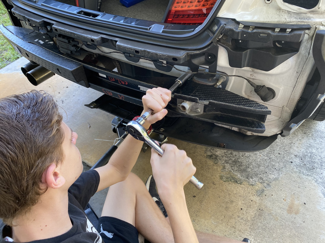

Originally Posted by E92William View Post
Very nice didn't know about these bumper carriers being a different lighter material for the M3. Definitely something to take in count if one can find a wrecked m3 to pick apart. Biggest difference seems to be the battery for the price, wonder if it holds up to the e92s power drain..
The rear bumper carriers are easy to find salvaged and can be had for less than $100 delivered. I got mine for $70 delivered off eBay and it was a direct swap. Definitely recommend this mod!
The front bumper carriers are hard to find, and it took me 2 months to find one. They are definitely in high demand, must be a lot of guys crashing their M3’s lol. On the front one I had to trim the foam inserts to about half their thickness (as shown in my pic) and then remount the horns from the stock bumper carrier. Otherwise it’s straightforward as well.
The battery has been cranking, although it’s a weak crank. My car rarely sits more than 24 hours. Like maybe once a month it sits for 48 hours. It’s been working for me... so far... lol

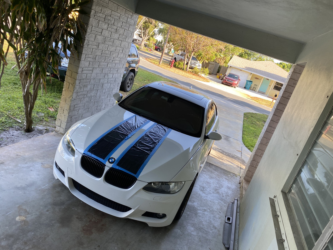

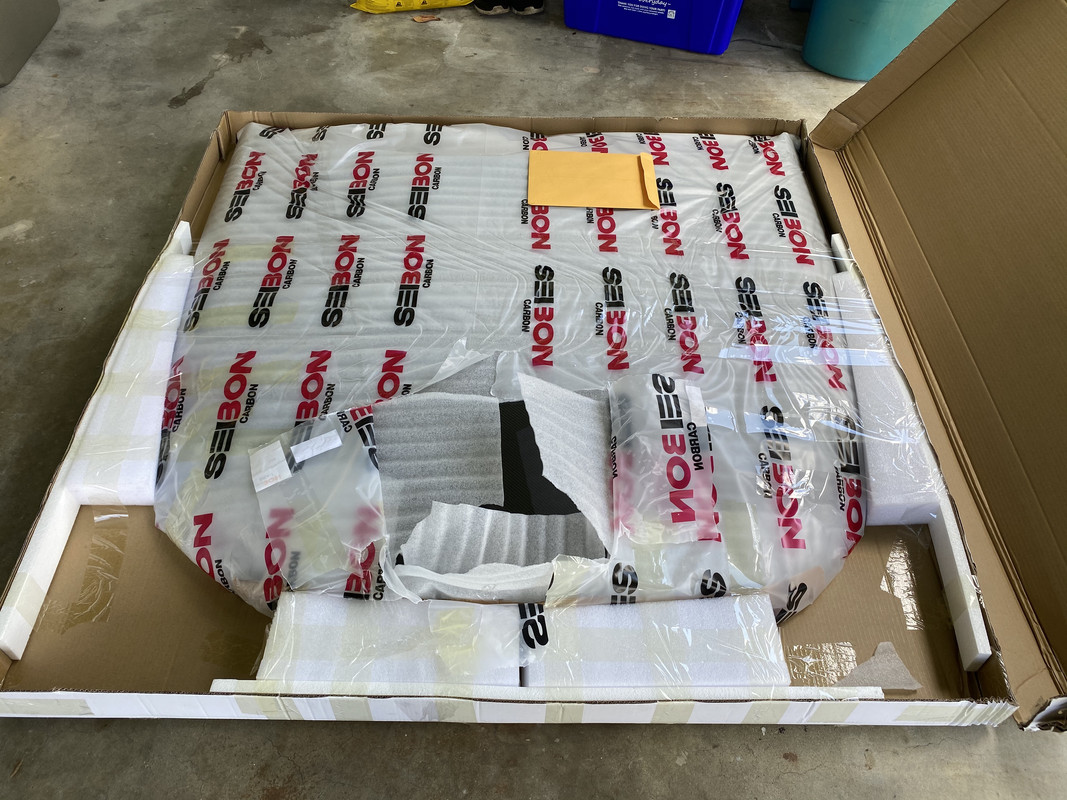

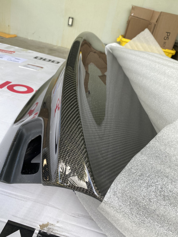

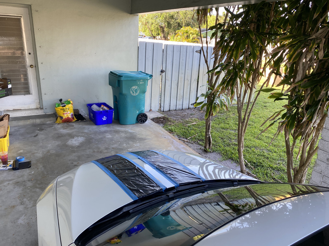

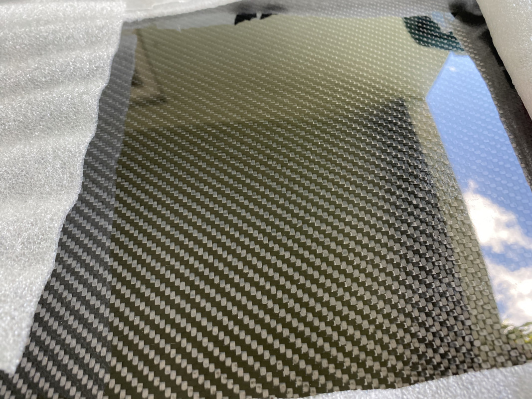

Ok so gearing up for the hood, roof, and trunk install. Thank you Coronavirus for giving me plenty of downtime to work on this
I made a “rendering” the old fashioned way. Tape and trash bags lol
Here’s the carbon hood up close so this is what I’m working with.
I was going to paint everything all white but after seeing the finishing on the carbon, well it’s really nice and kind of a shame to cover it all. So I started thinking about how to expose some of it and began looking at images of other carbon paneled cars to see what they do. So this is what I came up with inspired by what Porsche does with their GT cars:
I even like the blue stripes. I’m thinking I’ll keep some element of a blue border around the carbon area. I found some images where Porsche uses some read around their exposed carbon and like the look...
