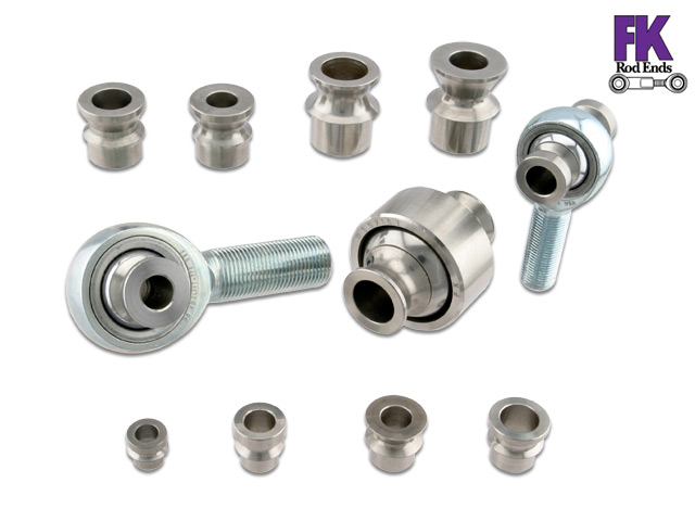

You are trying to compare stock rubber bushing to M3 ball joint bushing. They are different and will have different movement.
From what I can tell the M3 one's inside will look like the one in the middle of this picture, i.e. a spherical bearing:
http://8903e7f0897f2982f439-51d6683c...lay640x480.jpg
If you rotate it enough inside will hit the outside sphere, but when the arm is bolted in the suspension on both ends, it won't be rotating that much.
