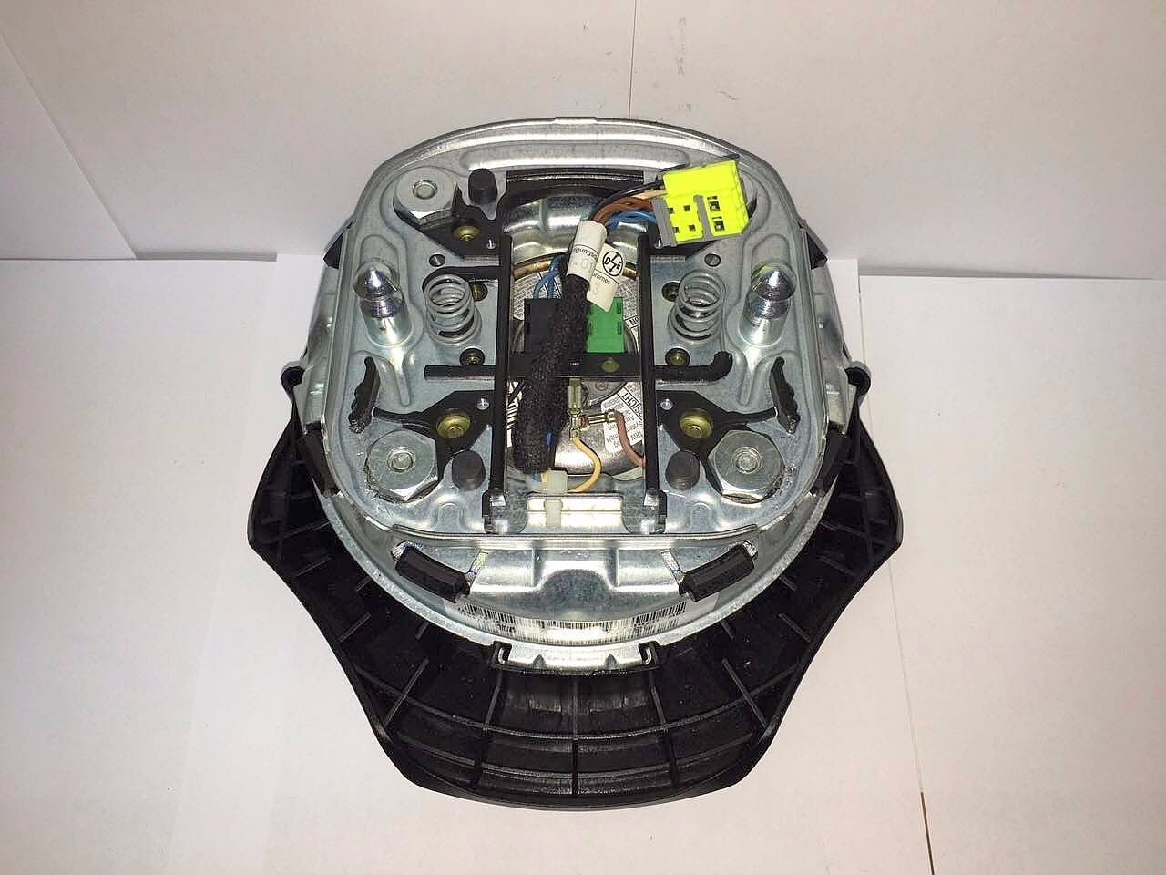

I have just bought Z4 E89 Steering Wheel from Europe to replace my original E90 Steering Wheel, but the Airbag doesn't work. My original is dual stage airbag but the Z4 E89 is single stage airbag
Is there any way except buying another dual stage airbag? Can I swap the core?
My original dual stage airbag
Z4 E89 single airbag
