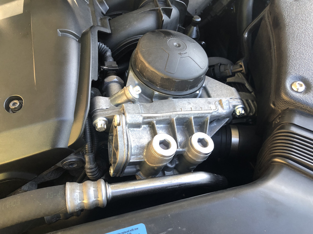

Looking for a replacement for this gasket:

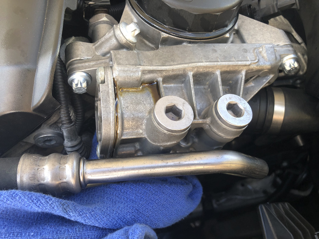

I just installed a used cooler with OFH and T stat and had a leak here:
I’m not surprised it leaked I should never have opened it but I wanted to clean up the parts I bought, lol. Anyway I sealed it with RTV for now and then spent some time googling and can’t find a part number for that gasket.

I was wondering about this as I am starting to develop a leak at that gasket. Have changed both other OFHG gaskets but I can definitely see it is coming from that spot as there is only a little oil residue around around that plate. Looks like I might have to use silicone to try to seal it.

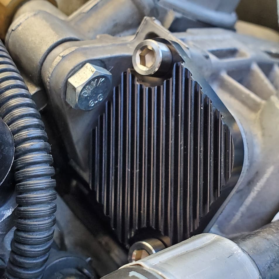

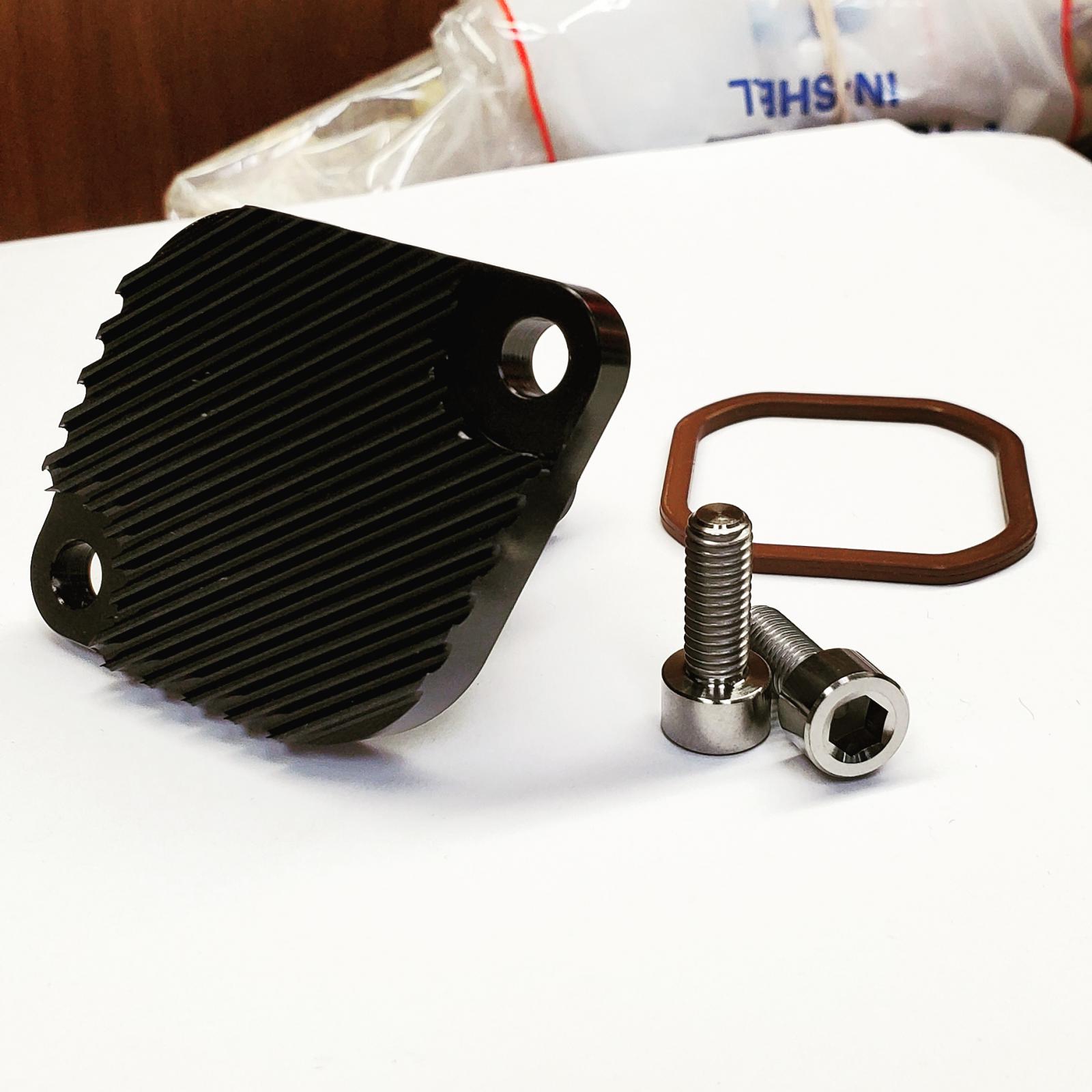

BMW doesn't sell this gasket separately apparently, but there are 3rd party suppliers who sell a neat billet alloy cover which comes with a gasket

here you go
https://www.ftpmotorsport.com.tw/pro...stat-cover-kit

It leaked in less than a week and I ended up buying an aftermarket cover with gasket that hasn’t leaked since.

I had to find this seal when I was installing the Oil tstat on my 128i. A round seal works just fine in the octagon groove. Had it installed since March 2020 with no leaks.
43mm OD, 3mm thick o-ring

FTP cap comes with a new gasket.

I'll have to take a picture tonight of the cover on, but for now here's one showing how far out the oring protrudes when seated in the groove. When I tightened down the cover it sealed up like normal.
They are Viton, resistant to motor oil and good to 400F.

Here's a pic with the cap on, all of the other pictures with the cap off were from when I installed it last year.
