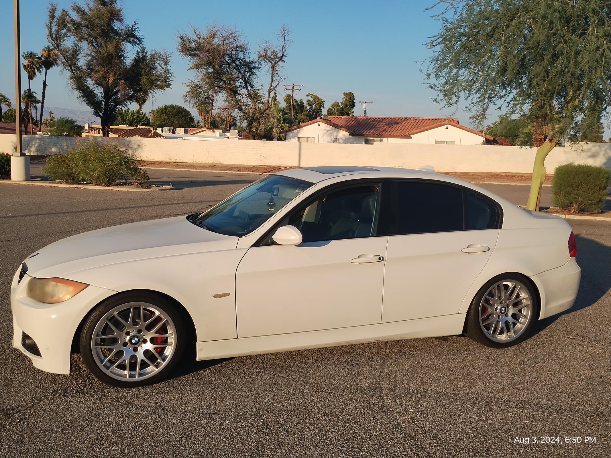

The Tein lowering springs are too low for me. It's even lower than on my E46(13.5 inch front and 13.25 inch rear). Will be getting E30 upper spring seat and pad to raise the car 15mm. For the rear 15mm(E46) spacer between the chassis and upper metal spring seat. The advertise drop is .9 inch front and 1.1 inches rear. I would assume the drop is based and the OEM sport suspension and not the standard suspension.

Your car looks awesome in those pics but I feel your pain.
I'm running the Eibach Pro-Kit on my E92 328i, and was not happy with the front drop until I re-did the setup with the E30 spring seats.
Your solution sounds like an awesome setup to me.

The drop is perfect. For sure it will go down a bit in time, as it will settle. Btw, what rims are those?
E46 CSL replicas 18x9+35 255/35r18 square. The drop is to low. For the rear I'm going to get this 20mm spring pad spacer.
