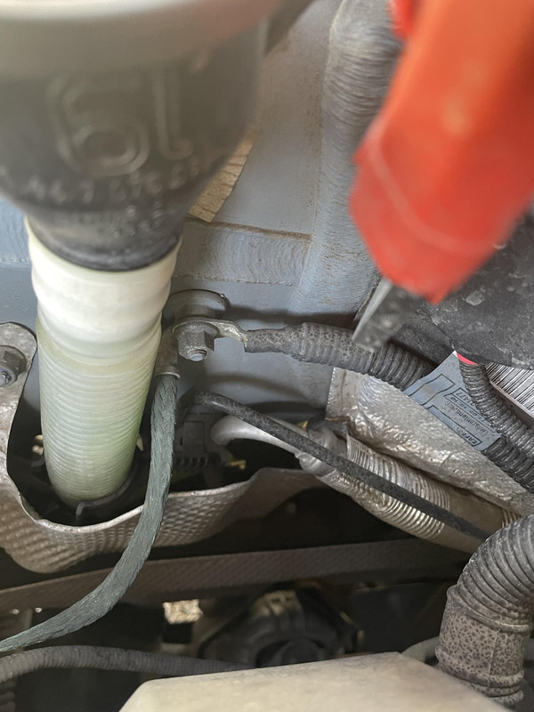

Turned out to be pretty simple and neat. I used Capitan Buumer and Nightman's suggestions. Took me 10 minutes. The tail for the SAE plug is wire tied by the washer fluid fill. Thanks everyone.
