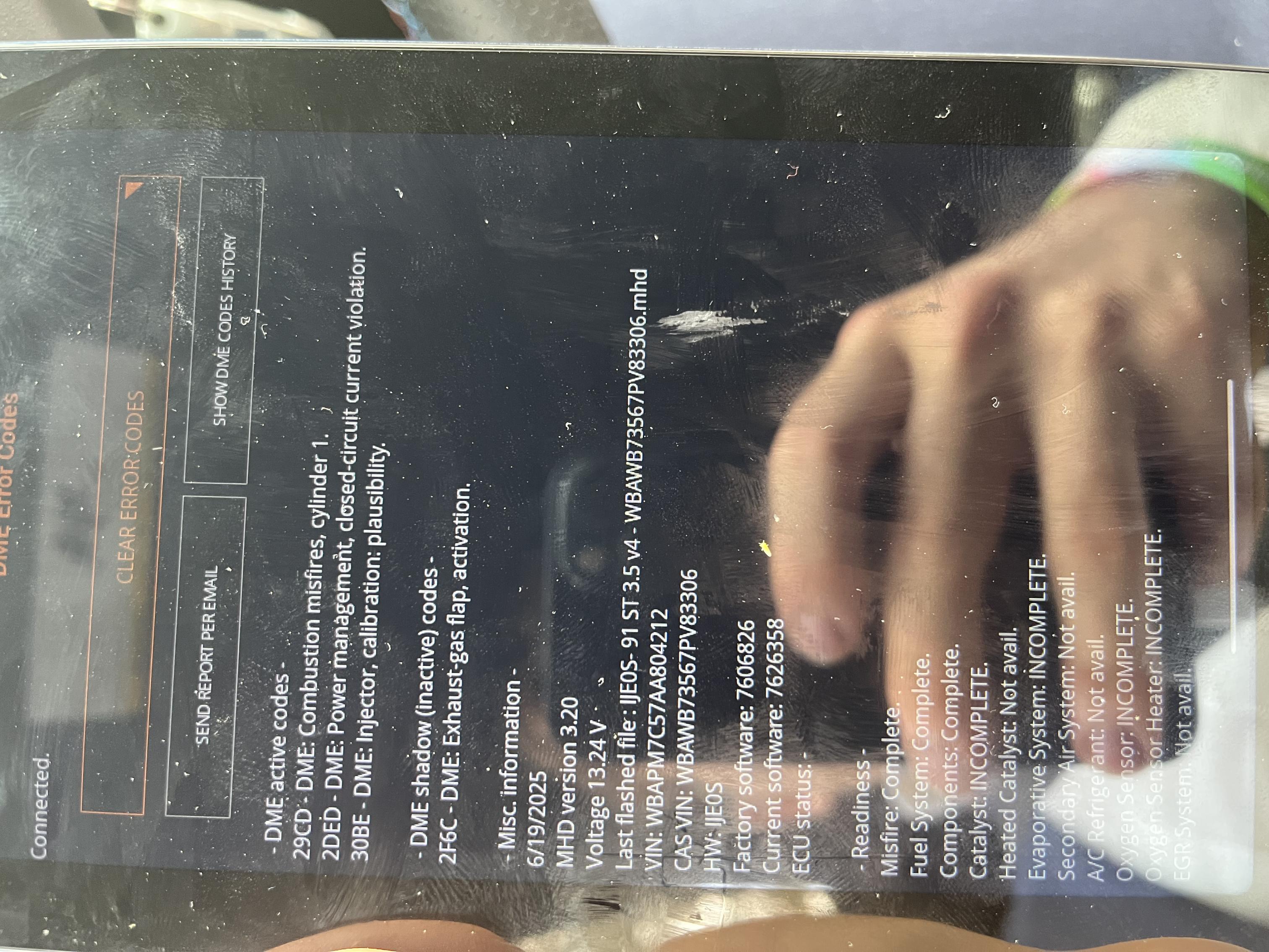

I have moved around the coils and tested different coil packs on cyl 1 and the misfire stays on cyl 1. Today I noticed the voltage through mhd when I scan the car is around 13.2 when running. But when tested on the jump points and on the alternator it’s more like 14.2. Could it possibly be an alternator issue or some parasitic loss I need to track down
I will attach the codes I got from the car this morning. I will also check the injector seals on cyl 1 for a loose fit or anything else. Will most likely swap cyl 1 and 2 injectors.
Photos taken at idle after 20 minutes of driving.
