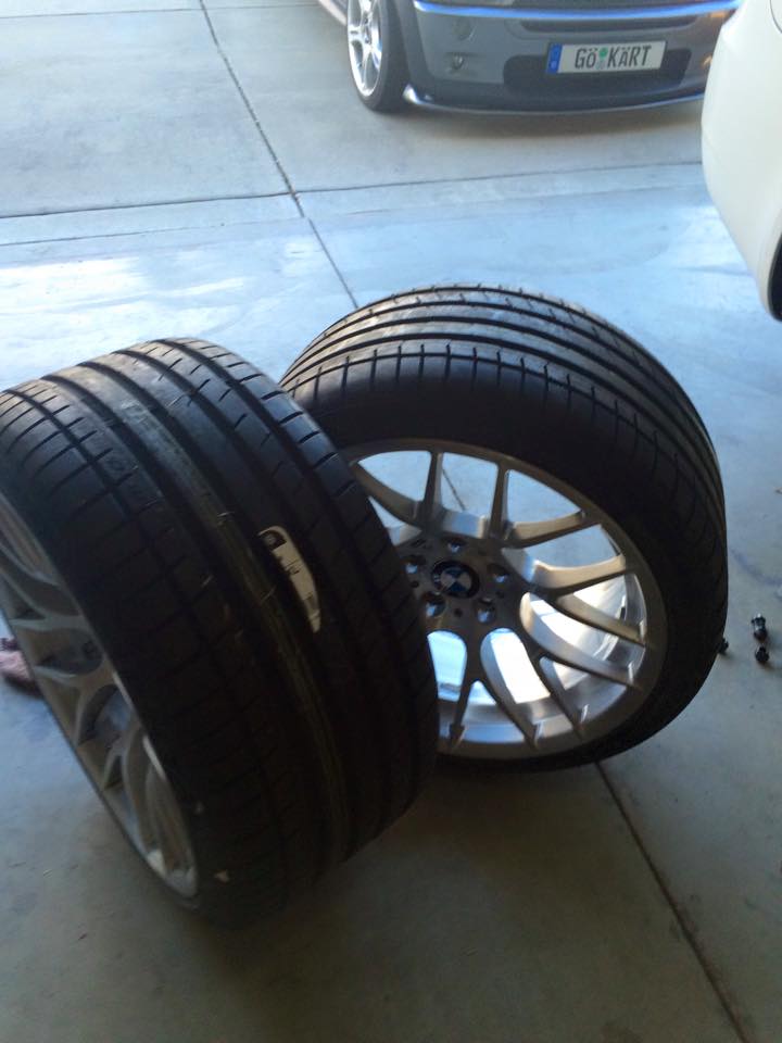

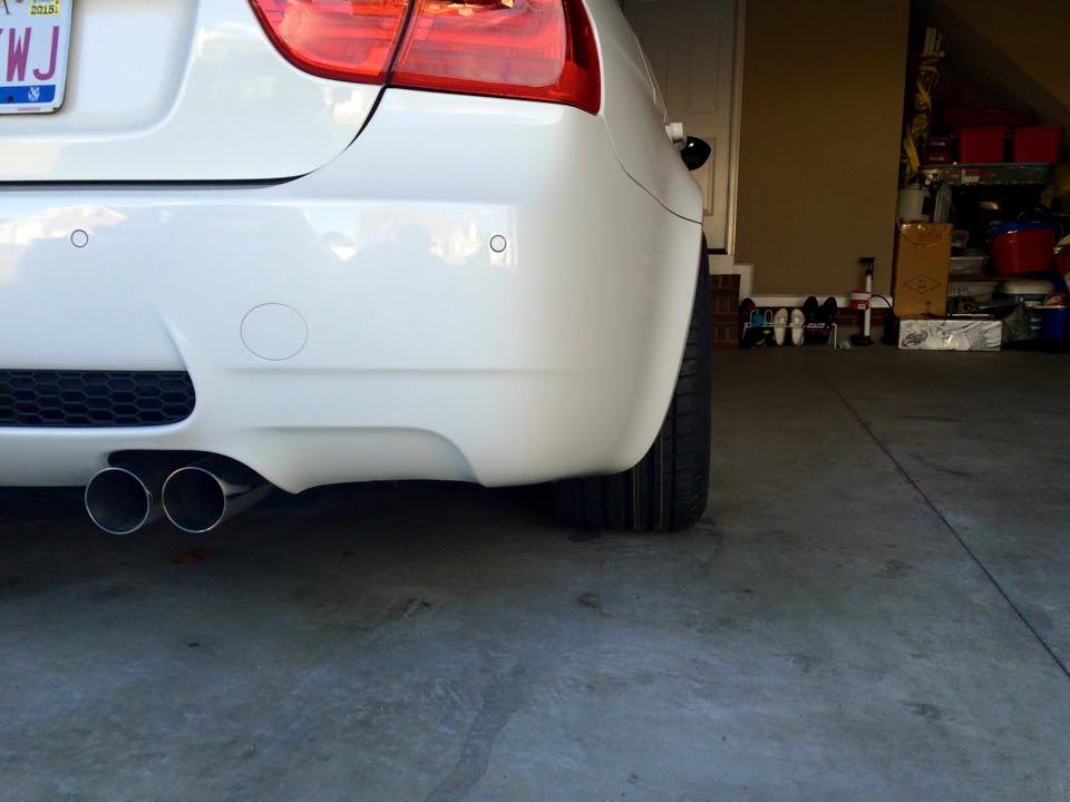

I have this setup, will post a pic when I get home.
EDIT.. Just found this pic on the phone. It is not ideal but Michelin says it is ok so I went with it.

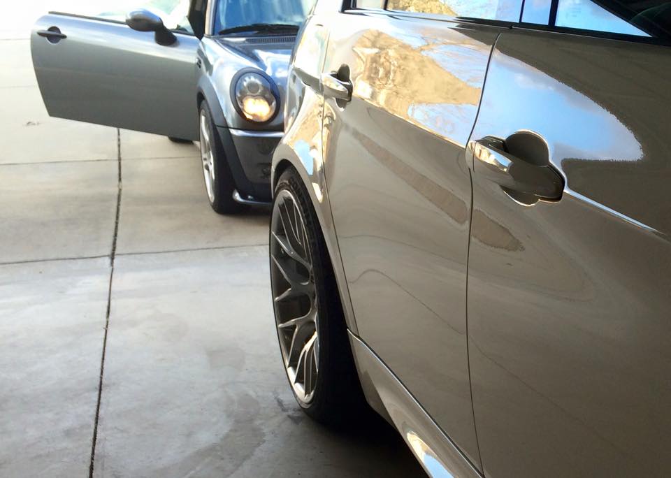

I just recently put 285/30/19 on my factory ZCPs, however my rears have been professionally modified/stretched to a 19x11!:D These pics were taken right after removing my KW sleeves and installing B&G springs so the rear looks high because I just lowered the jack!lol

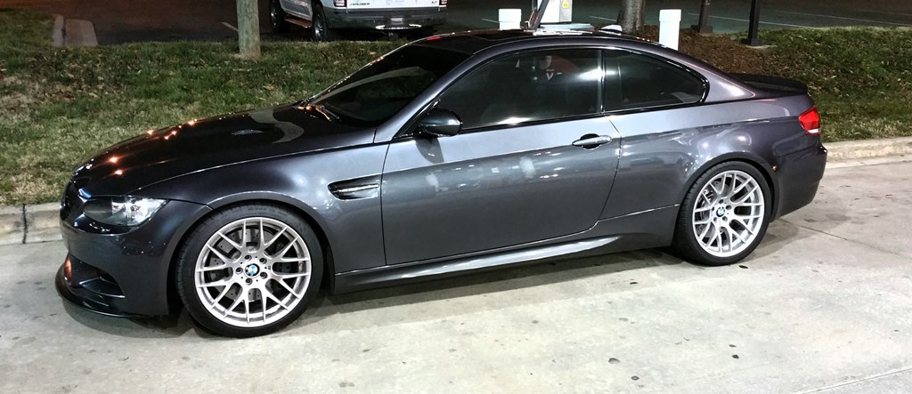

I've been running F255/R295(AD08 and PSS) for +3 years on my stock ZCP wheels and it rides perfectly fine, that's without saying how much more grip I get from this set-up compared to stock PS2s, I also really like the look of it!
That looks OK - not too outrageous from this angle. Thanks.

That looks pretty good - Thanks! No issues with the rears rubbing?
Lowered on Eibach and no rubbing although I did trim that plastic bump off the inside of the liner. That was trimmed off with stock tires and a 12.5 spacer
It server no purpose anyway. But as far as rubbing the fender there is none.
