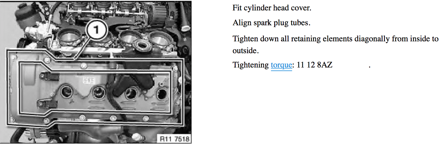

I am planning on replacing my valve covers & associated gaskets this week and was hoping someone could comment on the torque pattern for the valve cover bolts. I came up with three alternatives:
Image hosted on: i438.photobucket.com
Which one looks best?
Also, would it be possible to tie fishing line around the cover to keep the gasket in place, and then to cut/remove the line once the cover is seated in place?

I started on the corners of the valve cover and worked my way in... Worked for me and no leaks. The hardest part was trying the get the valve cover gasket to not fall off when putting back the valve cover. If they are not aligned properly you'll have a leak. I had to redo the passenger side bank twice because of that.

haha that's the opposite way of doing it lol but I"m glad it's not leaking
Lol yeah I saw that part after I tightened valve covers.... I was rushing and didn't bother to read the manual once I put the valve cover back in. After you do it once, its not that terrible. 10mm swivel socket helps a lot with this.
Tighten down all retaining elements
diagonally from inside to outside.
Tightening torque: 11 12 8AZ.

Forgot to add the torque:
11 12 8AZ Decoupling adapter screw to cylinder head cover.
S65 M6 6 Nm

yea I saw that one there but i'm going with 10NM...
in that manual online book one tq says 17NM, one 10NM and this one said 6NM for decoupling... I'll go with 10NM right in between.. and also it may be very hard to tq the back bolts since there is no space for the tq wrench...
I think 10NM is a safe tq
It should be OK with 10Nm. However, I believe the screws touch the bottom. And they are aluminum. Just saying that maybe, just maybe, 10Nm might be a bit excessive. The torque I posted came from BMW AIR (former TIS) for my VIN (2012 car). I can post the document tomorrow when I get to the office if you'd like, just to make sure.

I've completed the replacement and have some notes that might be useful to those of you doing this in the near future.
1) Removing the strut braces and cowl cover gives you more space in the rear to work in. It's only a few screws/bolts/nuts and I think it is worthwhile. With those parts removes, I was able to use a torque wrench on every valve cover bolt. The only exception was the passenger side stud that acts as a ground and onto which the plastic ignition coil cover snaps.
2) I bought replacement valve covers which came with the gaskets, grommets, and bolts all in place. Leaving the bolts in the cover keeps the gasket from falling off of the valve cover during installation. You could even use some little foam pipe spacers to keep the bolts in the raised position.
3) When removing the covers most of the old DreiBond was stuck on the gaskets. But some could stay behind on the heads and could easily fall inside the engine. Keep an eye out for the old DreiBond and make sure you remove all of it and that none fell into the engine.
4) I installed the spark plug tubes onto the heads first and then fitted the valve covers. That seemed to work well.
5) If you are getting new valve covers or are getting your old ones powder coated, keep in mind that all of the fasteners are one time use. For example, the bolts for the cam sensors are one time use and the new ones need to be torqued and stretched (4 Nm + 45 degrees).
6) I used a small torque wrench (graduated in in-lbs and Nm) for everything (except the strut brace nuts/bolts (34 Nm) - also one-time use) and it worked very well - easily getting to the rear bolts without the need for swivel joints. I used that wrench and a variety of extensions and sockets.
