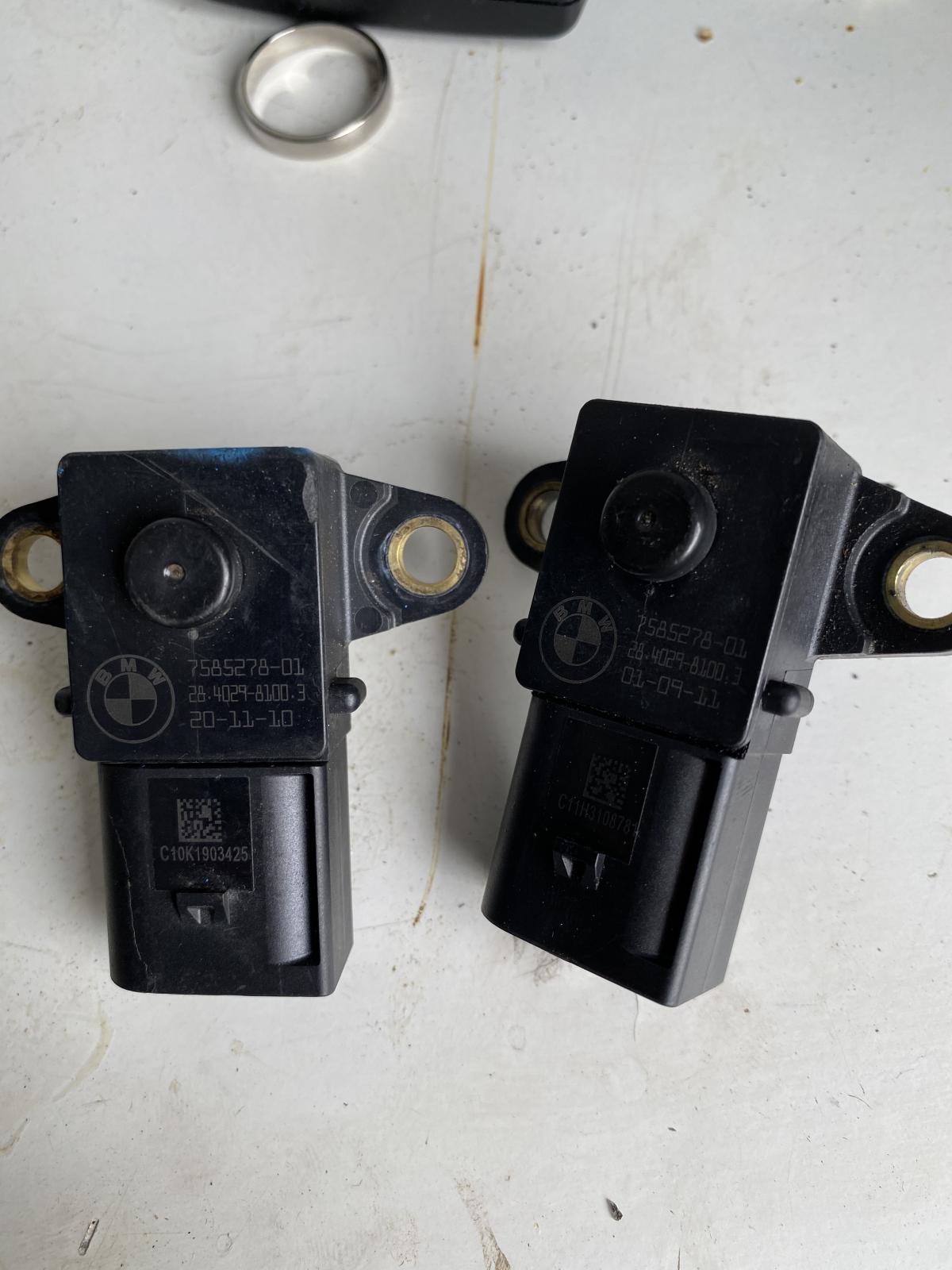

It's a 15 $ fix! Got the sensor out very easily. Remove the torxscrews on the sensor, unbolt the ABS and make some space. Pull the sensorcable and you got it in your hands!
I checked the numbers on my pressure sensor and found a MAP sensor from a Z4 with the exact same number on eBay for 15$ (besides the production date). Immediately I heard that the pump stoped working overtime. Have been driving it for 3 days now, no codes, no limpmode:party0030:
