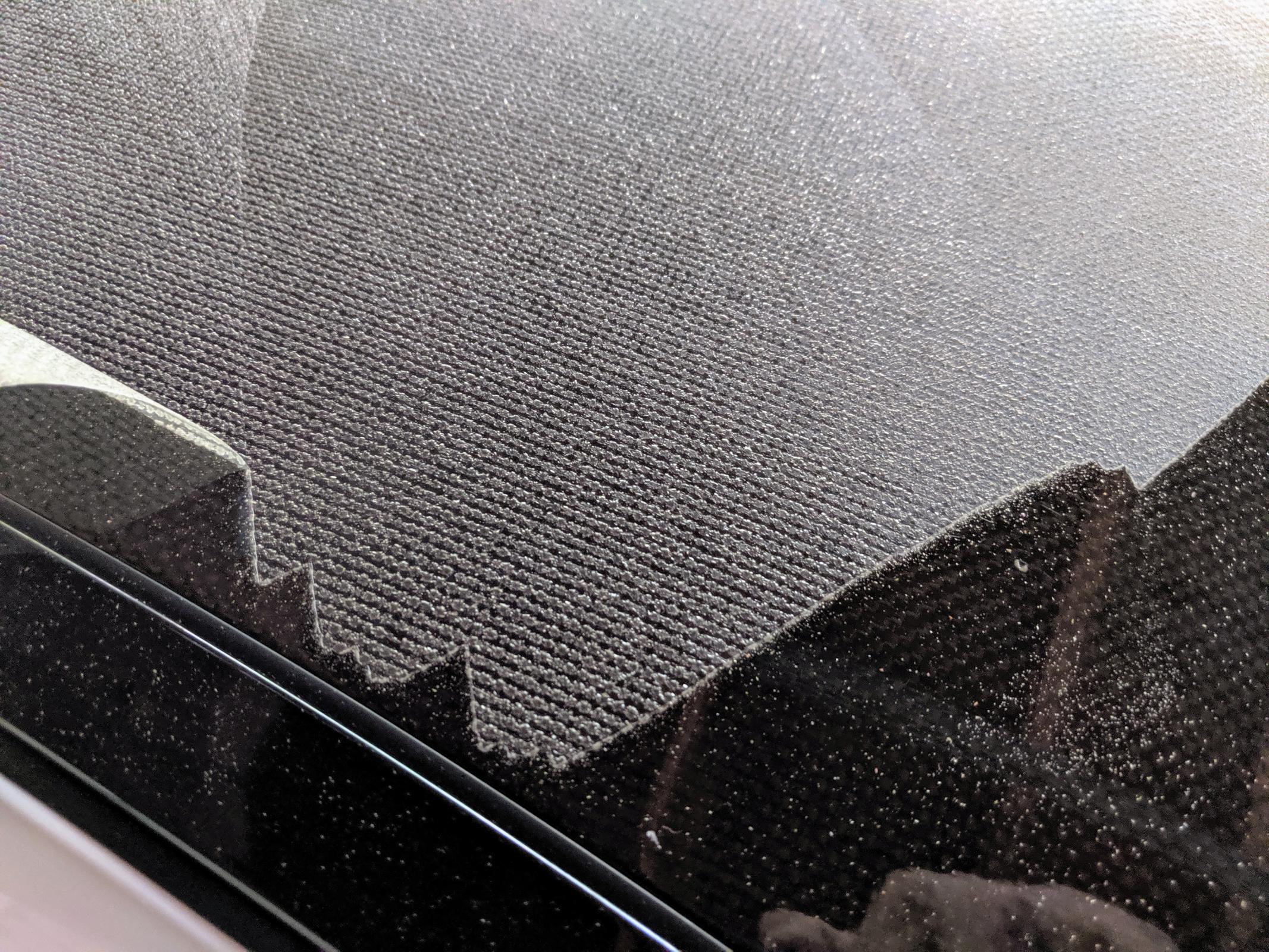

Actually all the yellowness was the clear/gel coat itself. As it peeled off all of the yellowness came with it. What you see still on CF is just like a powder residue from the gel coat. That can just be cleaned off.
From the looks of it the carbon fiber was completely unharmed. Now that it has actual clear and not gel coat should last longer too.

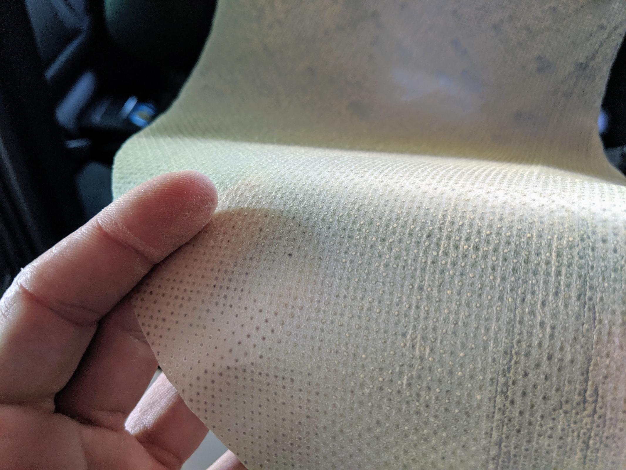

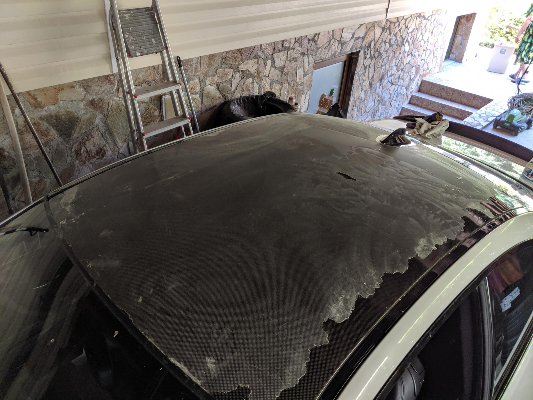

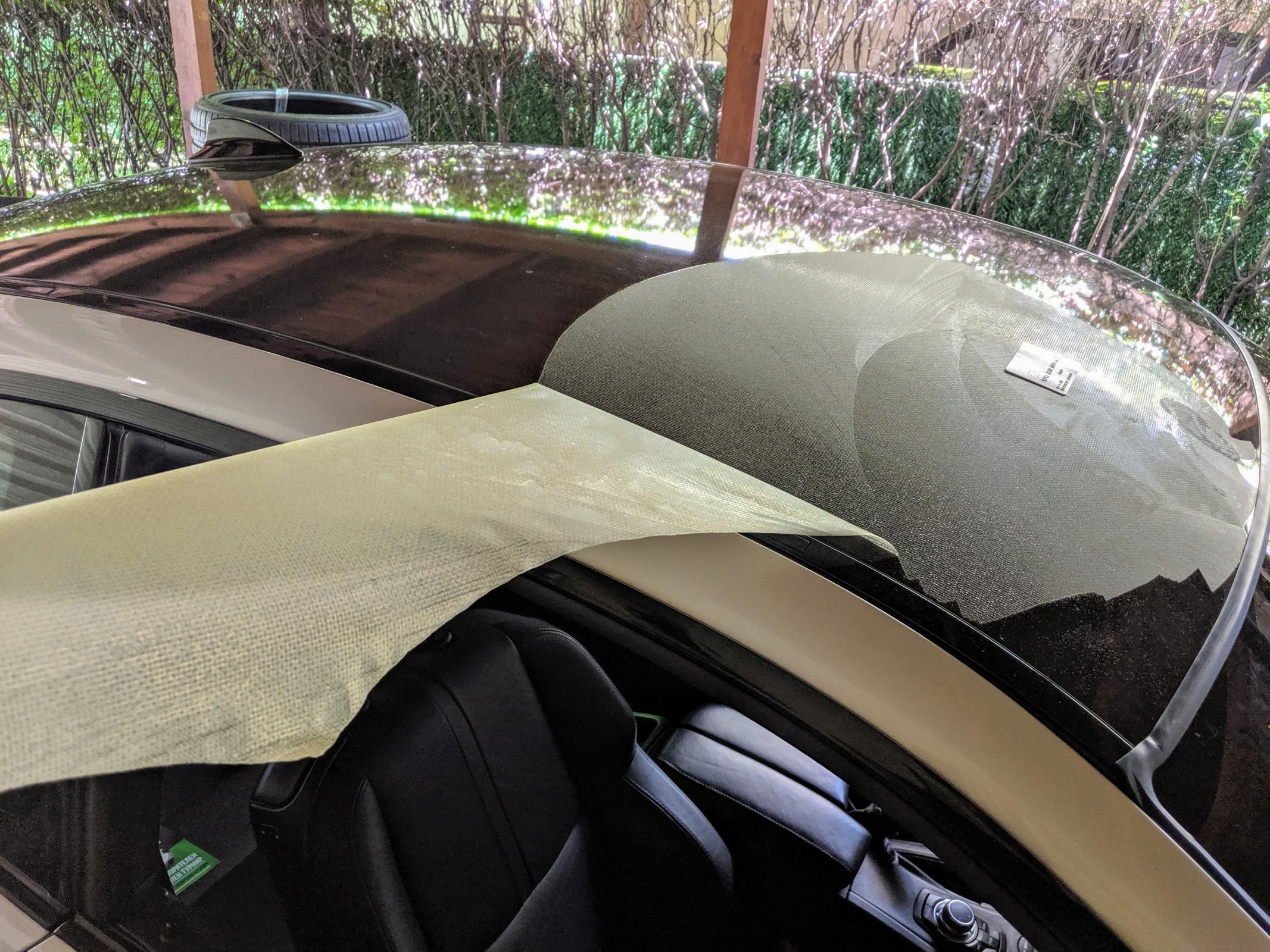

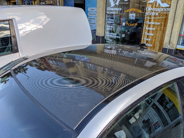

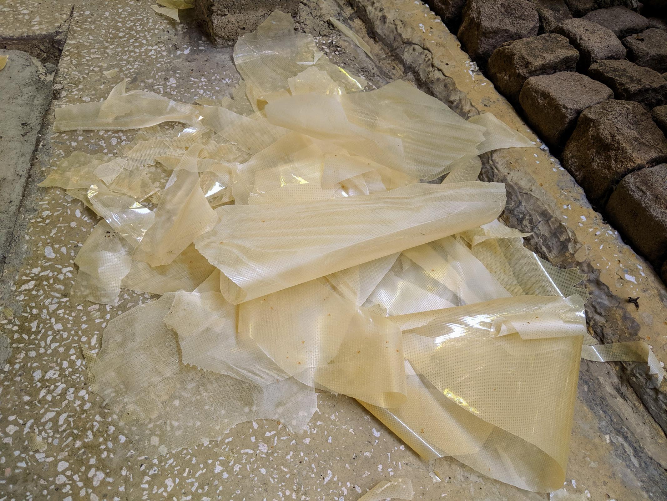

Well the inevitable happened to me yesterday. All started with a little bubble on the front, over the windshield which I didn't even notice.
Went to the car wash and the pressure washer did it's job. And from then on, things escalated quickly. It peeled like it was hardly attached to the roof...
Under it, there was a ton of yellow dust formed by the gel coat.
I'll finish it of with a razor blade for the tough parts and it goes for a clear coat this week. Will keep you updated!
P.S. Here is also a little video of the peeling process. I just used a plastic(credit card) for the job.

Alexand3r wroteThis is the stuff of nightmares.Well the inevitable happened to me yesterday. All started with a little bubble on the front, over the windshield which I didn't even notice.
Looking forward to the results ! It's nice that most of what actually turned yellow is gone....the clearcoat applied over the carbon laminate will enhance the blackness of the carbon weave.

CHE///MIST3 wroteYes, I definitely think that the yellow coloring will disappear now. It was all in the form of dust underneath and in the gel coat itself.Looking forward to the results ! It's nice that most of what actually turned yellow is gone....the clearcoat applied over the carbon laminate will enhance the blackness of the carbon weave.
GM

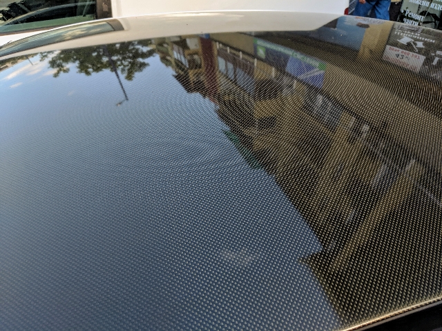

It's in the shop right now for the new clear coat. Will post results in the following days.

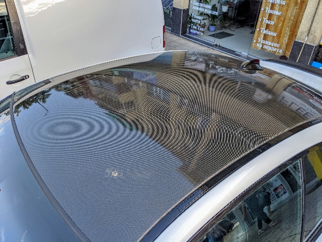

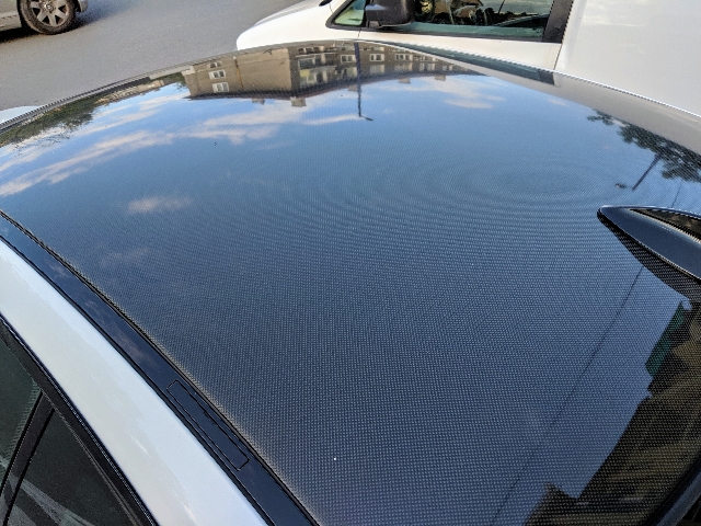

Sorry for the delay! This is the result. MUCH better than before. The carbon fiber weave pops up much better and is more defined, also the yellowish colour is gone. Really happy with the result. So don't be scared when/if that happens to you, because it's for better.
That looks phenomenal. There appears to be plenty of depth. Can you describe approximately what they did? Number of coats, sanding in between, etc ?

As far as I know 3, but I'm not entirely sure about that.
I just know that the first layer just soaked into the carbon fiber and merely left any on the surface. I think they sanded the second one and then put the final layer. Again, not 100% sure, but I at maximum there is a fourth one.
amazing looks brand new!

SoCalRPM wroteI tried using a credit card and a plastic razor blade, it worked just fine but it was taking a long time. I then used compressed air behind a tab of skin to "push" up under the sheet and was able to get it all off very easily in very large sheets. See below.This is the stuff of nightmares.
This link is aspirational and it does not work this easily BUT: using compressed air under the edge while teasing a peel lifts it off in large sheets and works very well.
I just pressure washed my roof and the old polyurethane coating came of so easy! Now to get someone to re-clear it. 👍🏻
