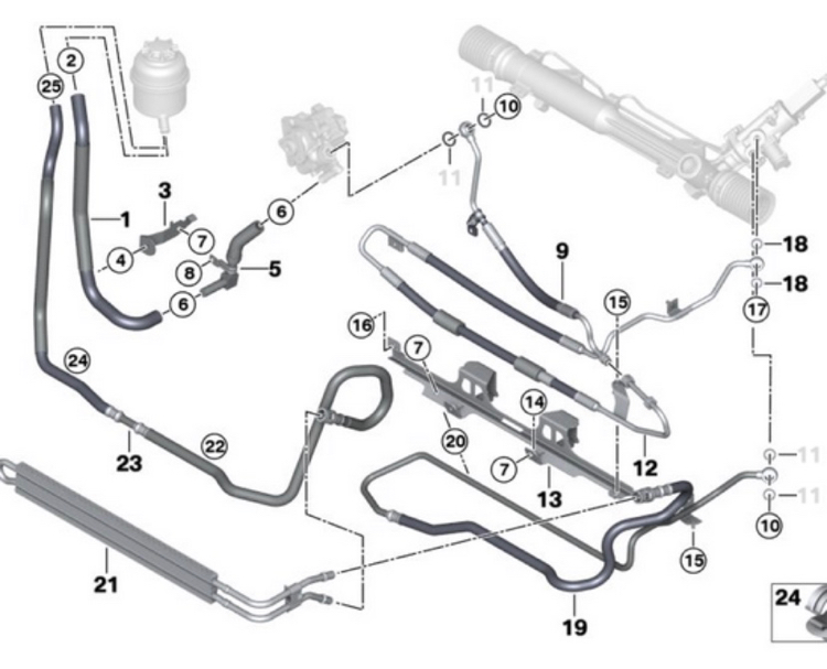

J'ai cherché ici, Google et YouTube, mais je ne trouve pas de DIY sur cette procédure.
Solutions trouvées pour poulies folles, tendeurs et réservoirs PS qui fuient, mais rien pour le remplacement de la pompe elle-même.
Est-ce que quelqu'un sait ce que toutes les « poignées de main secrètes » sont pour le retrait de la pompe ?

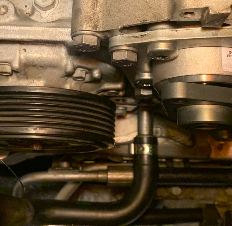

Je l'ai eu de près, mais je ne suis pas assez intelligent pour obtenir la pompe PS tout le chemin.
La ligne d'aspiration est toujours attachée à la pompe et je ne peux pas dire COMMENT elle est attachée.
Quelqu'un connaît la poignée de main secrète pour obtenir la ligne d'aspiration à lâcher la pompe?

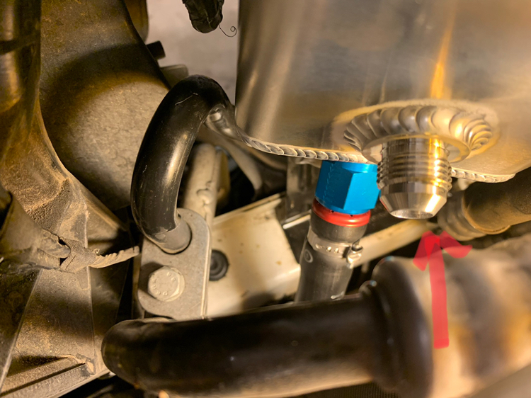

I did find that, but it doesn't have any details about the best way to get at that clamp (Item 3).
It is really buried.
Davisca455 wroteYeah you are going to have to find a way to get to it and cut it off...Much appreciated msan.

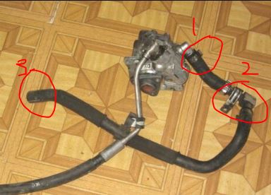

Here's the part if it helps
https://www.fcpeuro.com/products/bmw-hose-clamp-32416751127#reviews
Maybe disconnect that line from the other end....
If you can't reach #1, then maybe try and disconnect from #2 (not sure how accessible this connection is) or #3 (this connection is under the PS reservoir)
I would "guess" #3 removing the pipe from under the reservoir body is the easiest solution. Although #2 has a bolt that will need to be undone somehow. Link to
bolt
bolt

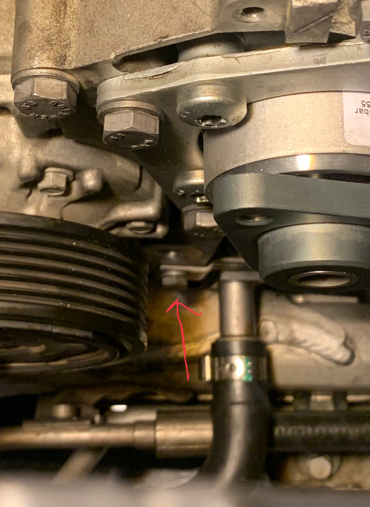

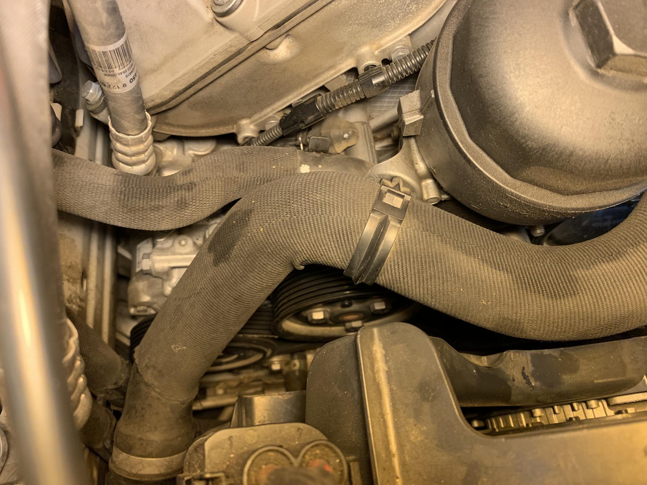

Thanks msan!
I got it.
I didn't realize that the A/C belt tensioner is what the pump was hanging up on.
Once I removed the tensioner, I was able to get at the clamp.
I got it.

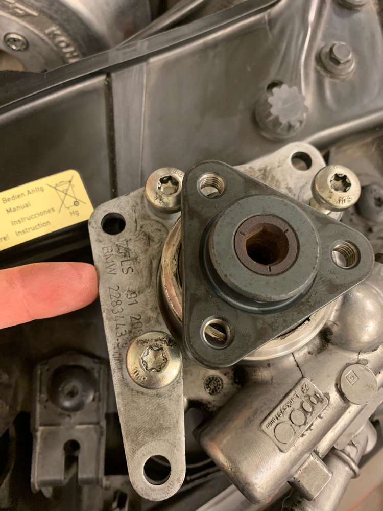

I had to remove the pump mounting bracket (held onto the pump by 3 torx fasteners) in order to wiggle the pump out the bottom of the car.

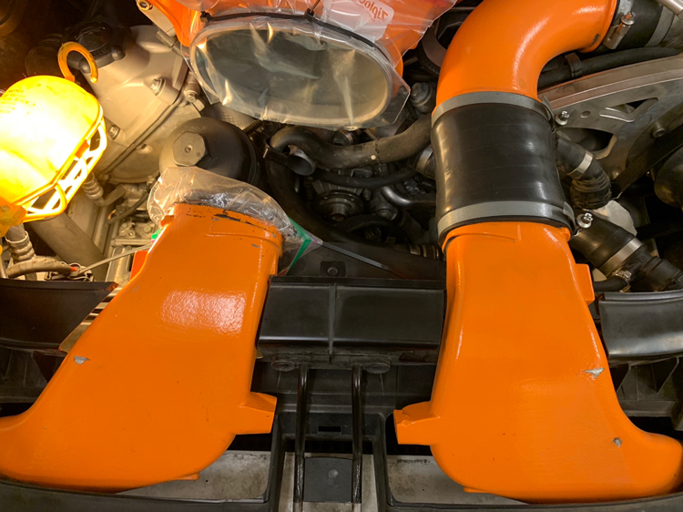

Slight points deduction against G-Power for their 1 piece intercooler design. Impossible to remove the fan assembly with the intercooler in place. Can't remove the intercooler without pulling the front structure off the car.

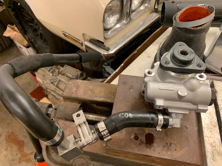

After I got the pump out, I removed this fastener and pulled the Suction hose assembly out of the car.
I removed the pump mounting bracket (3 Torx fasteners) from the new pump.

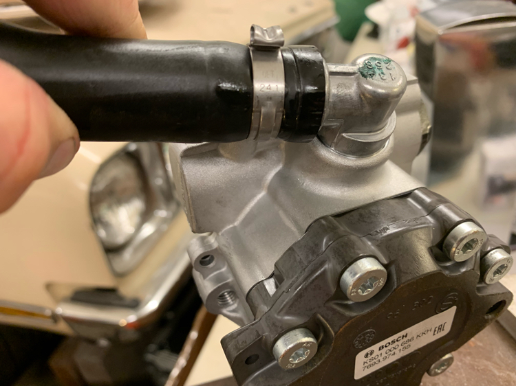

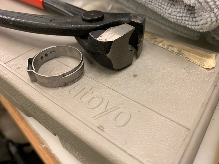

I used a 24.1mm Oetiker clamp to attach the Suction hose assembly to the new pump.

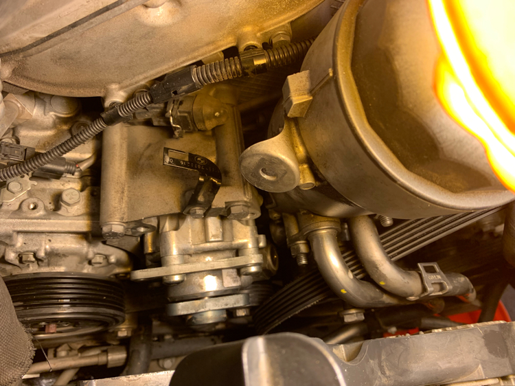

Then was able drop the entire assembly in from above, past the fan.
Wiggled the pump/Suction hose assembly into its approximate place, then re-installed the pump mounting bracket onto the pump with the 3 Torx fasteners, then bolted the pump mounting bracket to the engine.
Installed the new PS fluid reservoir.

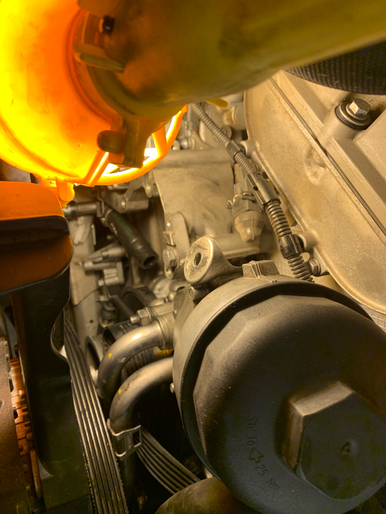

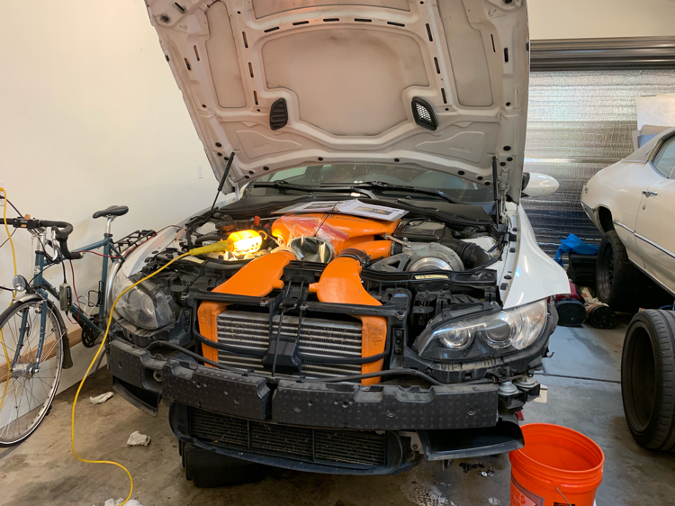

Wow you did it without removing the fan!? Props. I did this a few months ago and there is no way I could've without removing the fan.
Bartledoo wroteWhy would you want to? The fan is a plug and one screw to slide out. I'm down for a challenge but why shoot my self in the foot:confused:Wow you did it without removing the fan!? Props. I did this a few months ago and there is no way I could've without removing the fan.
Bartledoo wroteOh, I would have taken the fan out if could have!Wow you did it without removing the fan!? Props. I did this a few months ago and there is no way I could've without removing the fan.
That is some sharp plastic to be dragging arms and hands across!
I pulled the nose off the car to see what it would take to remove the intercooler.
Once I saw what I was in for, I decided I better try it with the fan in place first.

Remove the three Torx fasteners that retain the PS pump mounting bracket to the pump.

14) Remove the HHCS (8).
Remove the banjo bolt (10) and the two crush washers (11) from the pressure port of the PS pump.
Remove the three HHCS that retain the PS pump mounting bracket to the engine.
Remove the PS pump/Suction hose assembly.
(It was necessary for me to remove the mounting bracket from the pump in order to wiggle the pump out past the fan assembly)
15) Note the orientation of the suction hose assembly relative to the orientation of the pump.
Remove the clamp (6) that retains the suction hose to the pump and remove the pump from the suction hose.
16) Remove PS pump reservoir (if replacing or cleaning).
Reassembly:
1) Slip the clamp (6) (I used an 24.1mm Oetiker clamp) onto the suction hose and install the suction hose onto the new pump.
Correctly orient the suction hose assembly relative to the pump, prior to tightening the clamp.
2) Loosely install the PS pump/Suction hose assembly past the radiator fan and back into its approximate place.
Loosely install the PS pump mounting bracket onto the pump using the three Torx fasteners.
Loosely install the PS pump mounting bracket onto the engine using three HHCS.
Tighten the three Torx fasteners and the three HHCS.
Install the banjo bolt (10) and the two crush washers (11) onto the pump.
Attach the steel elbow (5) of the suction hose assembly to the chassis using the HHCS (8).
3) Install new (or cleaned) PS pump reservoir.
Route the PS pump suction hose toward the reservoir.
Slip the clamp (I used a 24.1 mm Oetiker) over the hose and attach the hose to its nipple on the reservoir and tighten the clamp.
Cap the return nipple on the reservoir.
4) I followed the process in the thread below with the exception that the reservoir end of my return hose was already detached and laying in my oil catch can. I put a clear plastic lid underneath the hose end so that I could see when clean green fluid stated coming out.
https://www.m3post.com/forums/showthread.php?t=1162286&page=1&pp=22
5) Route the PS pump return hose back toward the reservoir. Slip the clamp over the hose, attach the hose to the reservoir and tighten the clamp.
Fill the reservoir.
Snap the suction and return hoses back into their respective clips.
6) Install the water pump pulley using the four HHCS. Using the tensioner, reroute and install the WP and alternator belt.
7) Install the A/C and PS pump tensioner using the two HHCS.
Tighten the fastener that retains the fixed idler for the A/C and PS pump belt.
Install the PS pump pulley onto the pump using the three HHCS.
Using the tensioner, reroute and install the A/C and PS pump belt. (I found it easiest to have the last loop be over the A/C pulley).
Tighten the three HHCS that retain the PS pump pulley to the pump.
8) Reattach the radiator hose clip to the oil filter housing.
Reattach the radiator hose end to the water pump housing and clip into place.
Reattached water hose end to the expansion tank and clip into place.
Reinstall the blue radiator drain plug.
Refill cooling system.
Install the intercooler/intake boot.
9) Test: Even though I went thru the PS flushing process and topped off the PS pump reservoir, I wanted to fire the engine and cycle the steering hard stop to hard stop to work out any air that might still be in the system. The level didn't noticeably drop, so 2 thumbs up on the flushing process by Bushum.
I also wanted to run the car to check for any PS fluid or coolant leaks.
10) Reinstall the aluminum skid plate, the nose, fender liners and front wheels. Remove from jack stands, torque the lug bolts, and test drive.
Recheck fluid levels after test drive.

New pump is on but om still getting a leak I believe its from (10) in the picture above. Does anyone know the torque spec for 10?
