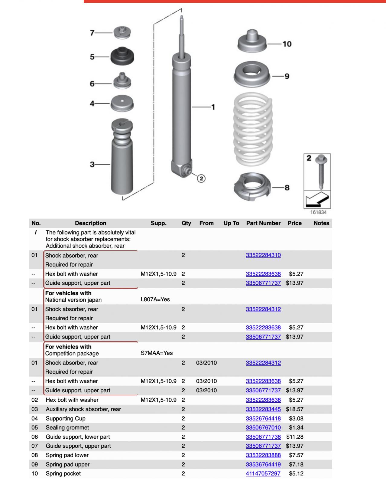

Pourtant, RealOEM n'affiche qu'un seul numéro de pièce.

My previous Ohlins I used the Powerflex Yellow rear strut mount PFR-416 which was 10mm. So I bought the 10mm PF Black for the Tractive and it's too small and the mech bored it out to 12mm. So I am 100% sure TracTive requires 12mm.
I am really interested to see how these hold up. I haven't found any issues or concerns with longevity across the Porsche and F80 forums, but they also don't have the cumulative miles/age that other offerings do. The Porsche guys are especially in love with these, went down the rabbit hole last night on Rennlist.

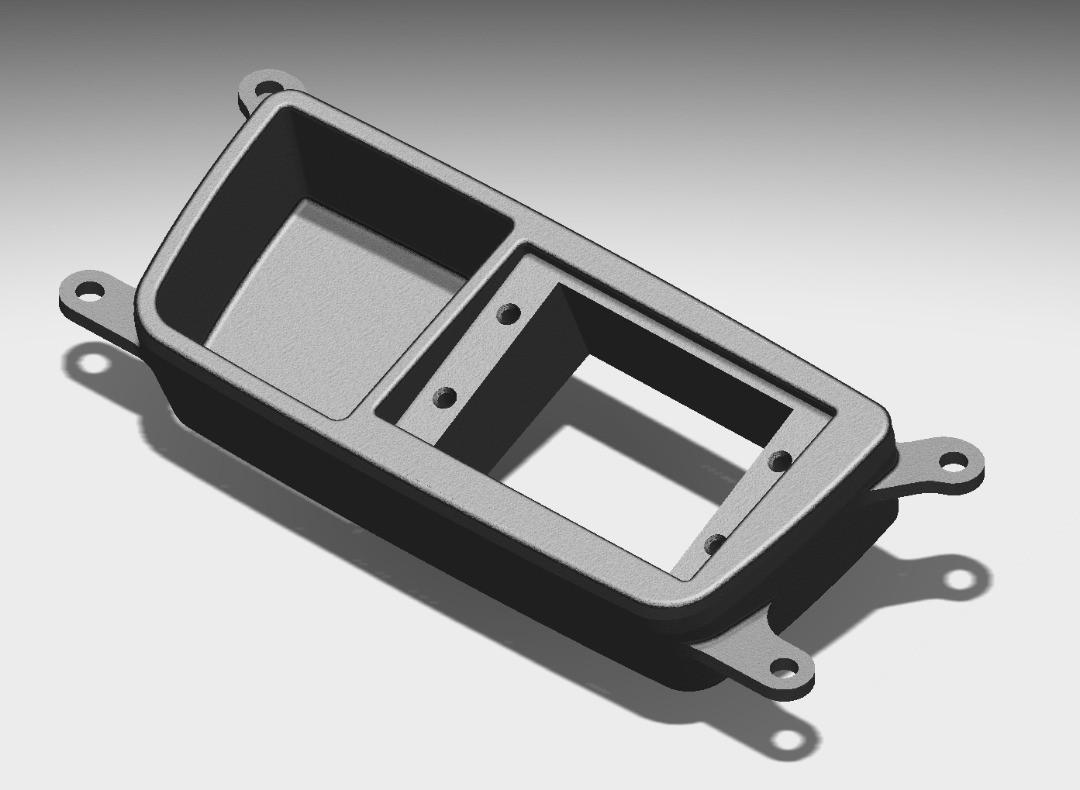

I am quite happy with how the display mounting turned out inside the ashtray. The door closes and it looks completely clean and stock with the door closed.
I am also talking to Rendition to create a custom ashtray that will hold the display.
https://renditioncustom.com/collections/e9x
There are 3 different pages on the display. By the way, the display is orange. It just looks two tone due to the lighting.

Very interesting and great initial impressions/feedback. Eager for you to dial in the settings to your likings and get a few more miles on them. Thanks for the update.
Teaser of the custom display holder from Rendition...
