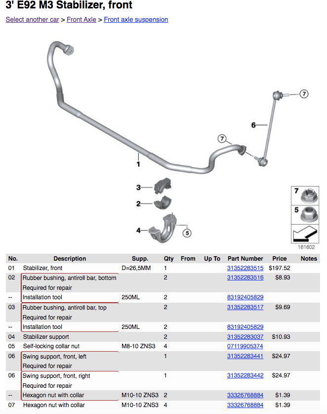

Here's a list of things to consider:
1) A broken front spring
2) Broken front anti-roll bar or strut connection (Swing Support)
3) Loose rack mounting bolt(s)
4) Broken shock

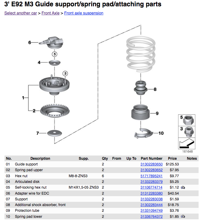

5) Broken strut top Guide Support

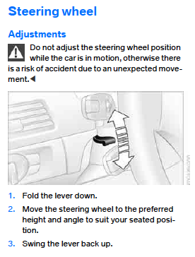

6) Loose steering wheel height adjuster clamp
See images with part names below
