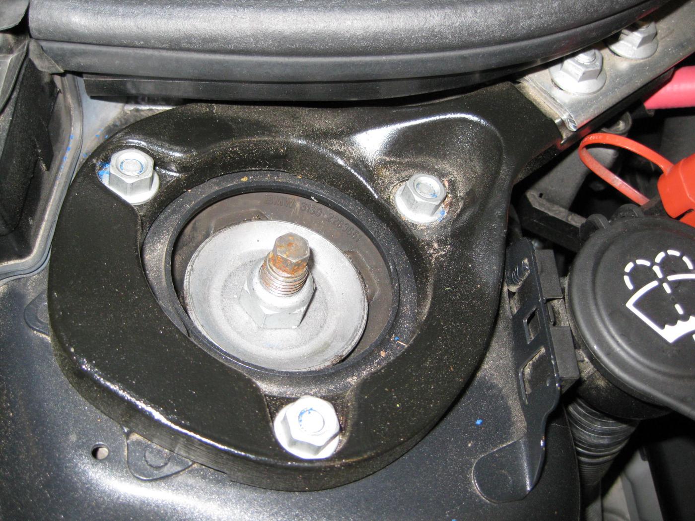

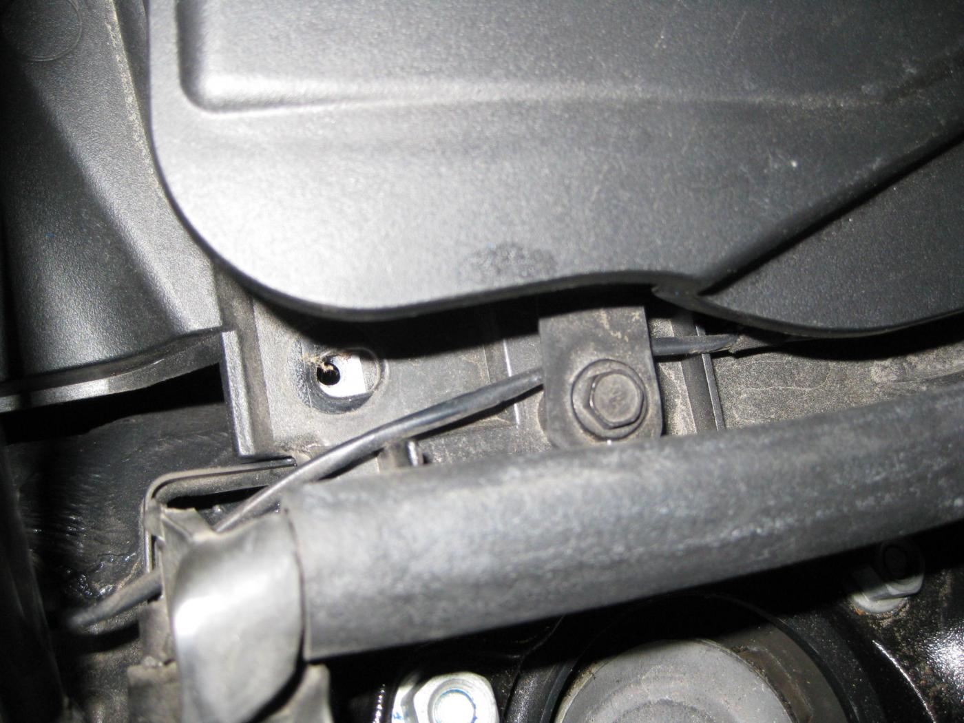

Pop off the ///Marketing plastic shock tower cover with the flathead screwdriver and start loosening the 13mm nuts. Let the weight of the car hold everything in place. Remove the 8mm bolt holding the plastic cowl in place to give you enough wiggle room to remove the tower brace.

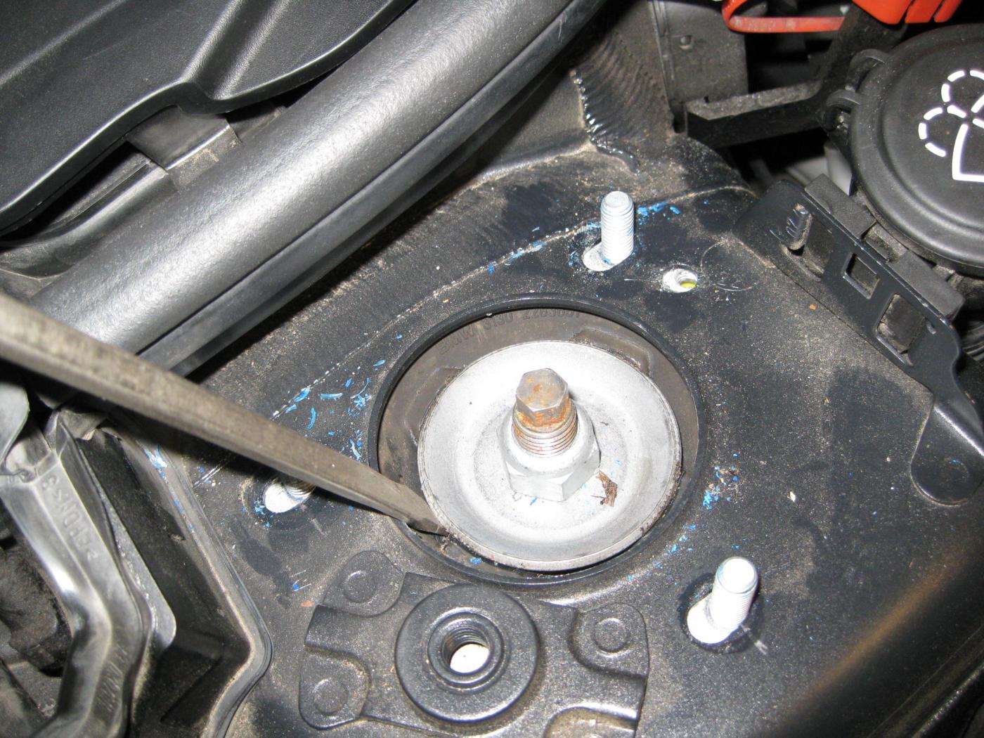

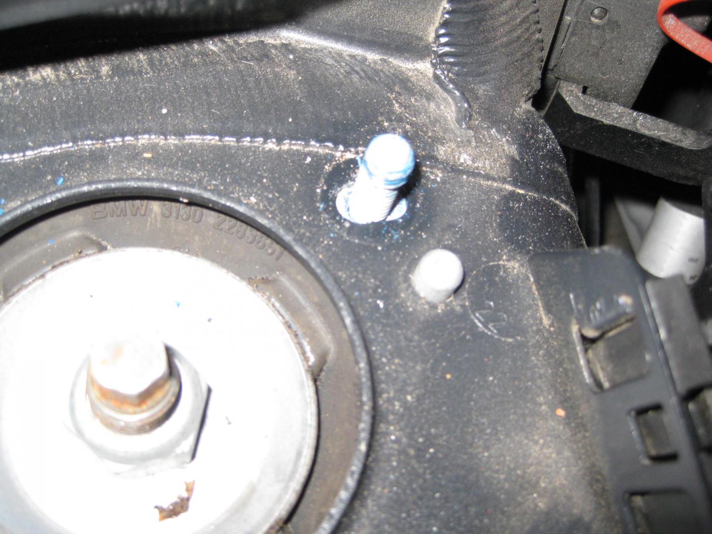

Jack up the side you're working on to take weight off that corner. Jacking up both sides just allows the suspension to droop, which isn't ideal, so I let the swaybar keep tension on everything. Remove the pin. The aluminum pin shown is the passenger side, it may come out easily with the 3mm allen key like my driver's side pin did, or it may be a bastard and strip immediately with a small amount of force (not even enough to deflect the 3mm allen key which isn't exactly stout) in which case you'll need to use channel locks or vise-grips to turn it.
Now comes the fun part. Take the flathead screwdriver and pry *lightly* against the metal strut hat top with one hand to move the strut into position while your other hand is on the jack handle. Check that all three strut mount studs are bottomed out against the inboard side of the slotted strut tower stud holes. Maintain pressure on the screwdriver while slowly, gently lowering the car, loading up the suspension until the weight of the car is holding everything in place again.

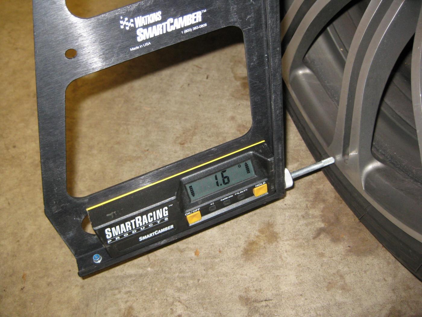

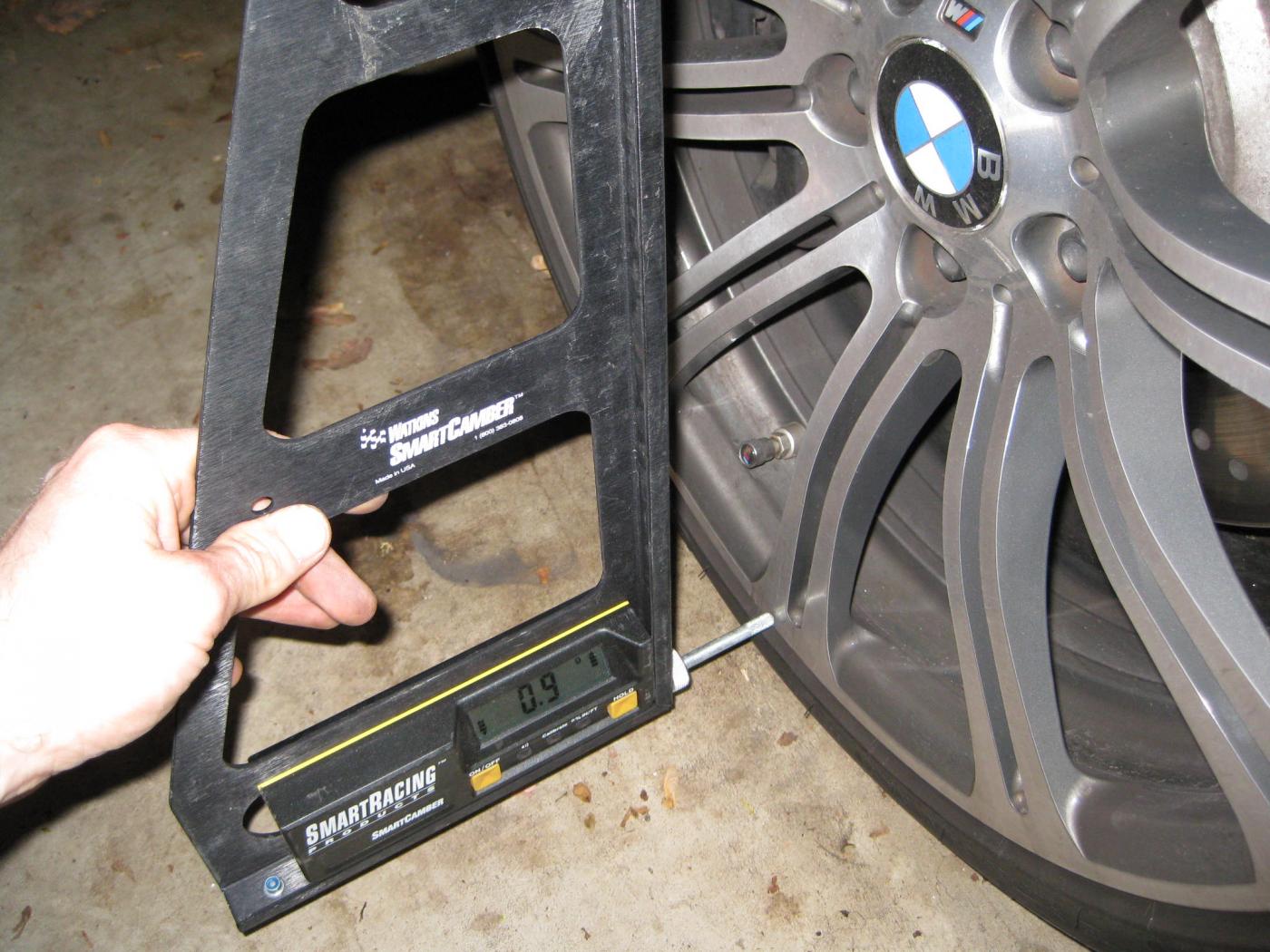

In my case I ended up with 1.4 and 1.6 degrees of camber, with no change in toe. This puts the front about 0.2 degrees less negative than the rear as opposed to nearly an entire degree.

As a side note, the OEM 220M 19's are nice as OEM wheels go for checking alignment with a Smart Camber gauge with that nice flat outer bead seat surface. The 18's are curved so it's tough to put it back in the same place twice.

Nice, thanks for posting. Can you clarify what is picture #4? It looks like you've removed a bolt from near the brake fluid reservoir cover but what for?
Yup

Just to clarify one item, you need to remove the screws (8 mm nut driver) from both sides of the car to loosen the plastic cowl / rear weather-stip channel so that you can remove the black strut tower braces. It's easiest to just go ahead and remove the cover for the brake fluid reservoir on the driver's side and the cover for the DME on the passenger side so you can get at those two screws closest to the front of the channel.
