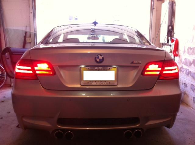

To activate the rear fog, simply turn on your car and press the lower right button on the light control switch.
Working dash light - check!
Image hosted on: www.fastm.com
Working rear fog lights - check!

and now only use the fog lights if the visibility is less than 50 meter due to fog!
I see too many idiots all over the world driving with the fog lights on at night when there is no fog at all. Heavy rain does not count!

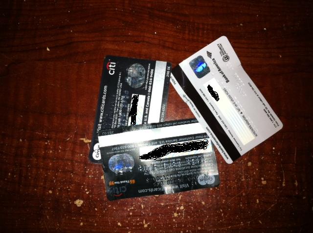

went to a local Autozone for the trim remover. they didn't carry one nor did they care. so, i used old credit cards to remove the trim. took a little more than 10 mins just to take it apart. damn. everything else was smooth sailing using the good 'ol swiss army knife. thanks OP!
