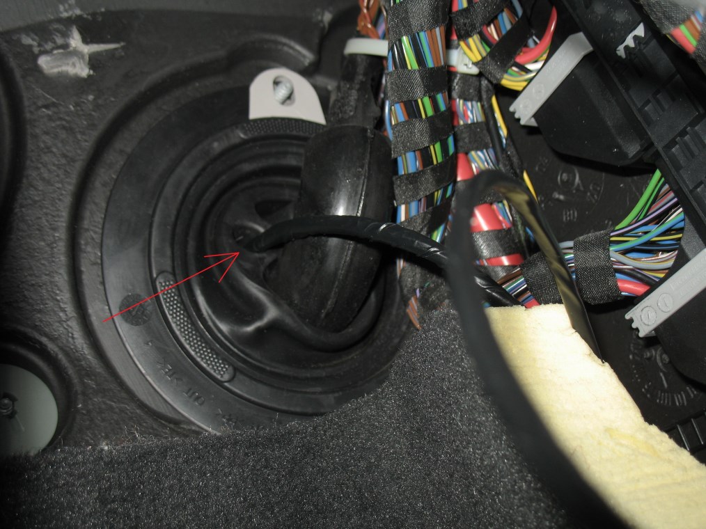

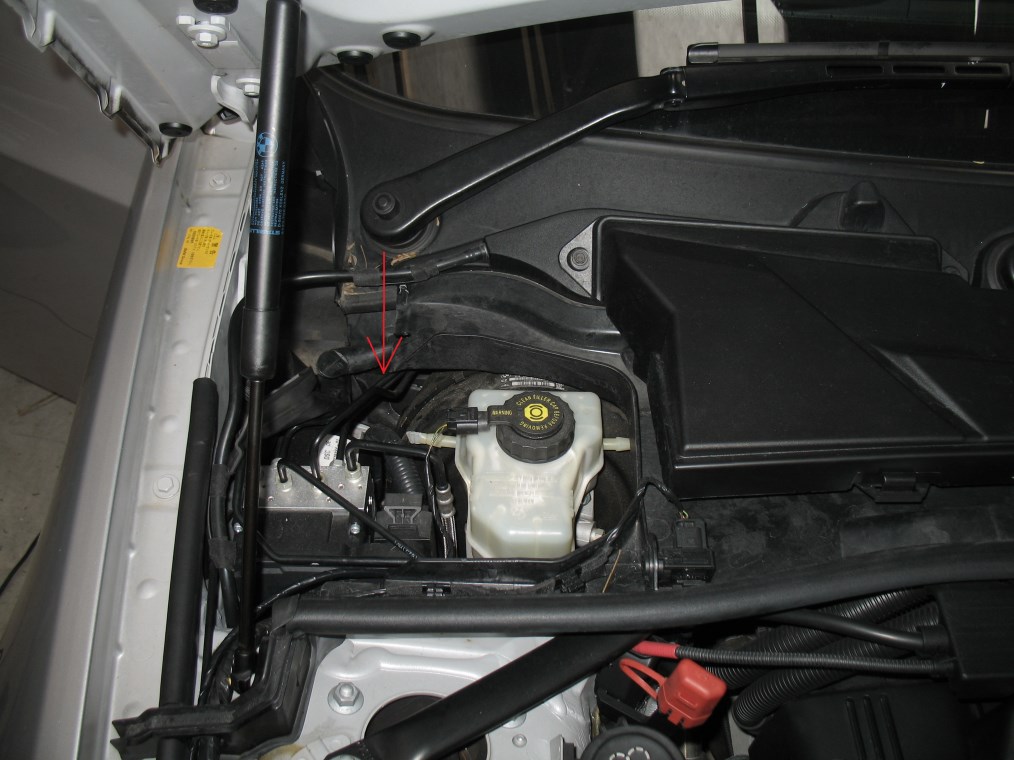

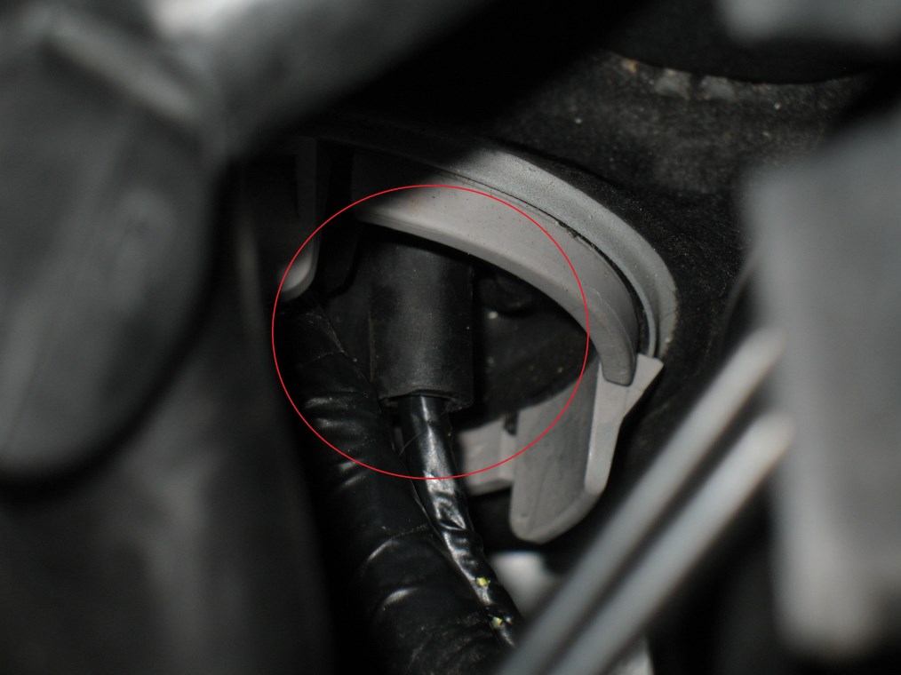

On a RHD car, the cable for the front PDC passes through the firewall on the right side below the brake fluid reservoir. There is a cable grommet there with spare nipples. Cut the end of one of the spare nipples to provide a cable route. Access is very very tight.
After routing the cables, fill the nipple with sealant. There are two reasons for doing this. It will stop water getting in. Small holes can let a lot of noise pass through so plugging the nipple will help keep engine noise out.
For cars built after 09/2007 the rear PDC loom includes two wires that are not used. (Blue and Blue/Brown). The instructions say to tie these back. One of these unused wires is quite long and would need to be hidden somewhere.
I cut the unused wires off where they met the rest of the loom and put heat shrink over the ends. Much tidier and easier to install.
Here are some photos of the firewall cable grommet inside and out.

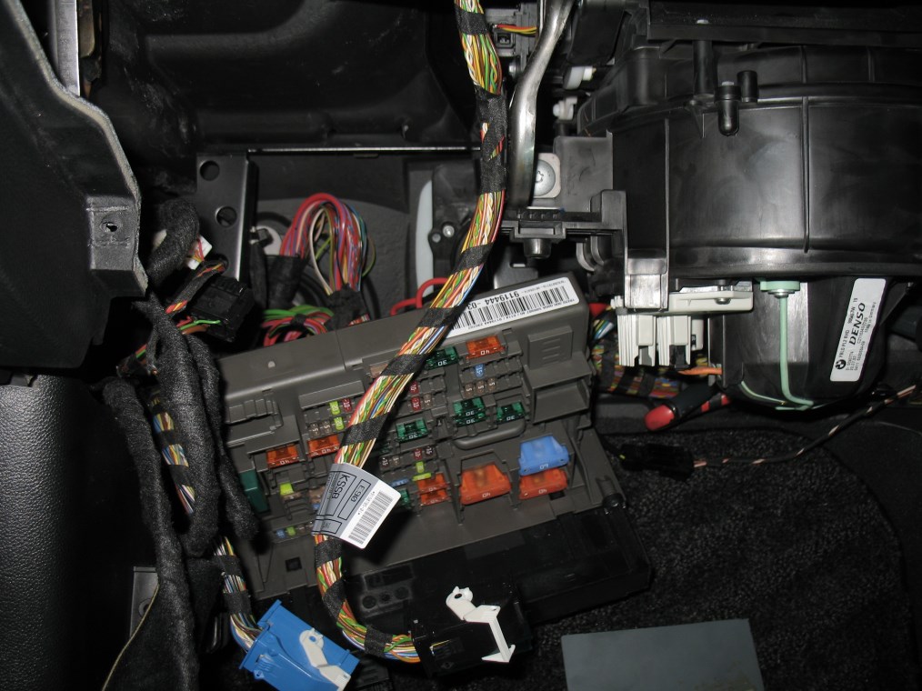

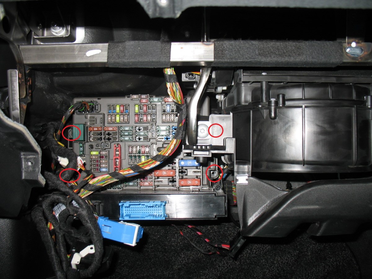

For the rear PDC, it is necessary to release the fuse panel located behind the glove box, left hand side. There are four screws to remove (circled).
The upper right one is almost inaccessible. I will need to make a tool to remove it.

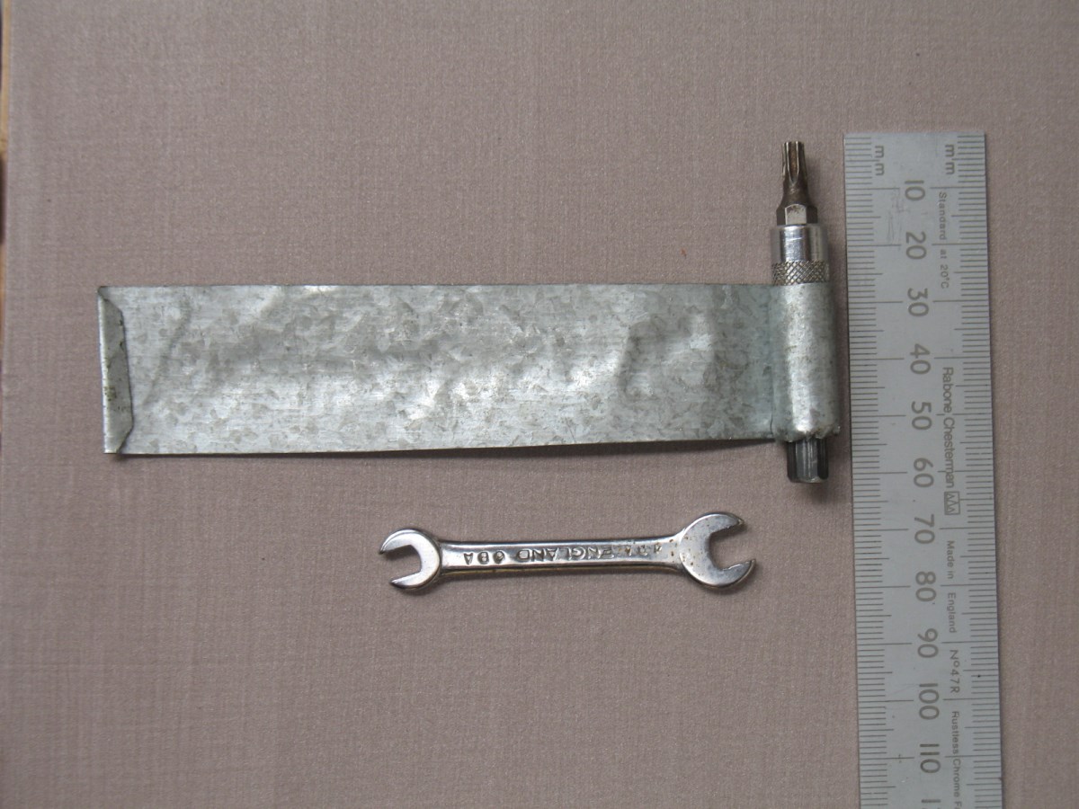

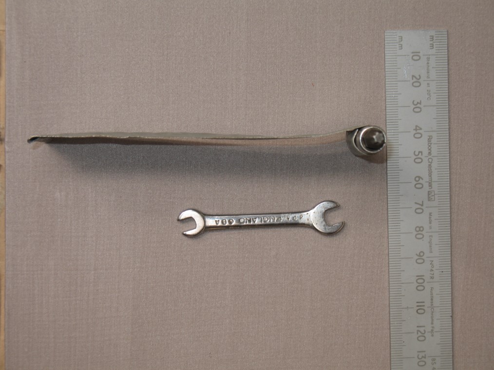

I managed to get the last screw out from the fuse panel.
I had to make a special tool to do the job. It was crude, difficult to use and easy to make.
There is absolutely no room to use any sort of ratchet driver so I happened to have a 6BA spanner that is just the right size to fit a 1/4" hex bit holder.
The hex bit holder had to be shortened to fit. The metal strip is a slip fit around the bit holder.
If you make one of these, you need to follow the dimensions. It can't be too long or too short. The bent metal is very specifically shaped to fit around the obstacles and hold the torx bit in the right place.
Once the screws are out, then a wire needs to be plugged into the blue fuse holder in accordance with the BMW instructions. It is necessary to remove the fuses from the holder before it can be removed. There is a tab on the top that needs to be pressed to release the holder.

There are four wires that need to be connected in the fuse panel area.
The instructions say to insert the Green/White wire into pin 7 of the blue socket X11001. I expected to find an unused pin that the socket on the end of the wire would just slip into. In my case there was already a Green/White wire in that slot so I looked at my options. In the end I chose to splice the Green/White wires. This is what the fuse card in the glove box says is how it should be. It means that the PDC is wired the same as if it was factory fitted.
The instructions also say to connect a brown wire to a grounding point X10012. This is supposed to be located in the passengers foot well (for both LHD and RHD). If it is there, it is somewhere behind the carpet and impossible to access.
I connected the ground connection to the stud that holds the fuse frame to the firewall.
It is located below the fuse panel, in the centre of the foot well, about 25mm below the top edge of the carpet. The top edge of the carpet has to be pulled down to access the 10mm nut.
