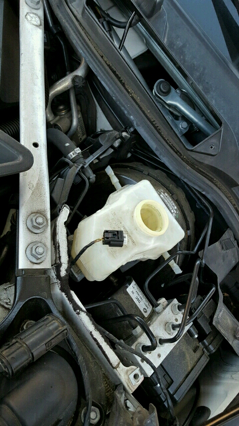

Which one is the ABS unit? The thing on the right in my attached picture?

Yes the silver block with the hard lines going into it. Its teh ABS module and used for the stability control. Its two or three small nuts (10mm I think) on studs that hold it down. If you are careful you can move it up and over a bit to make a little more room.

This is the best I can do with what I have lol. Doing all this will give you a bit more room. Then you just prepare to have your hand/arm mildly wounded by your own car and attempt to reach the sensor.
