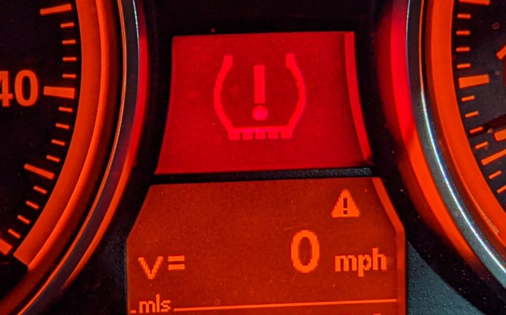

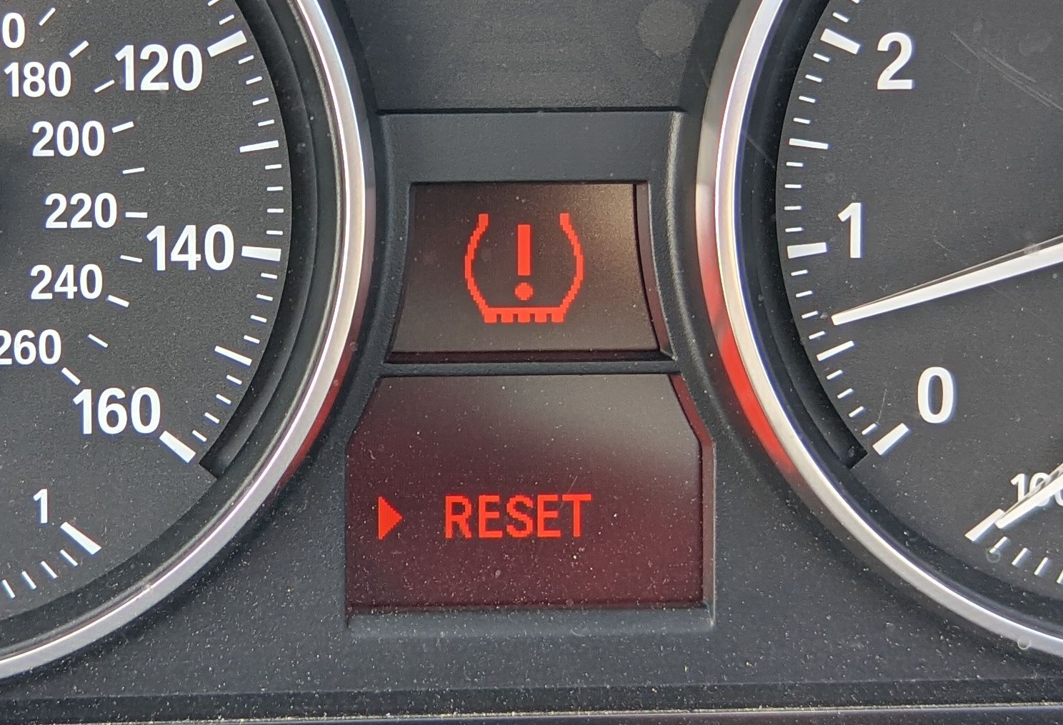

It should say FTM (flat tire monitor if that is enabled instead of TPMS).
In fact it doesn't say either TPMS or FTM on reset screen. I should be able to test soon.

I forgot to have my idrive coded to make ftm available in the menu but holding the the tire monitor reset button until it chimes forces the reset as it should.

So tpms to ftm worked! But it took a while, 10-15 min of driving up to ~50mph (not highway) to trigger.

I switched to new "track" square wheel and tire setup and went from stock 829F/832R rotations per mile to square 822 rotations per mile.
I think this is why FTM stopped working, have permanent low tire pressure warning and reset does not work any more no matter how much I drive after reset.
Any idea if square or slightly different diameter matters for FTM, any way to adjust or "hard" reset it ?
Edit: I was able to remove tpms warning (and I assume re-enable FTM) by performing reset in DSC module via INPA
