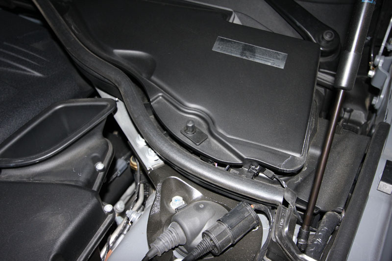

I'm uploading a pic of the hood switch for Thinker23 who wanted to see where it's supposed to go ...
MDCTFTW wroteDidn't your car come with the hood switch already installed? Mine did.I'm uploading a pic of the hood switch for Thinker23 who wanted to see where it's supposed to go ...
GregW / Oregon wroteOh mine did come with it installed, but Thinker has an 09 build that doesn't come pre-wired for the oem alarm. He was wondering where it's supposed to go so he could check.Didn't your car come with the hood switch already installed? Mine did.
