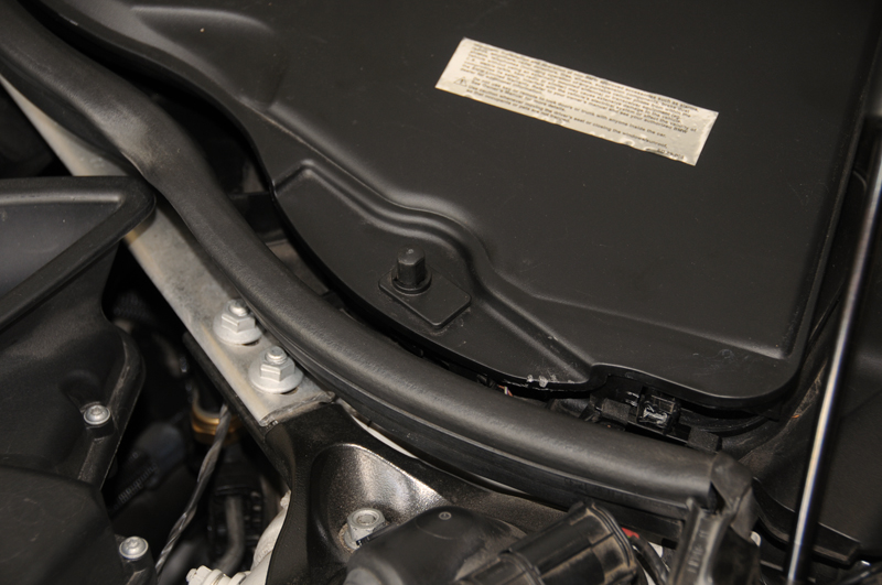

I had heard the same. I really want an alarm but with my '09 don't think I'm prewired. Anyone know if I am? I'm gonna go look for the hood switch...
You should be pre-wired in an M3 regardless of year. If it were an '08 I'd say maybe not. Any ideas if I just install the alarm and motion sensor, it will work without errors? Don't care about the hood sensor.

Here is the hood switch, at the front corner of the driver's side cabin air intake housing...

If not prewired, evidenced by the hood switch pictured above, you're out of luck. The cut-off date was somewhere in '09, I believe, so some '09s were still prewired. The only option after that was to get the factory alarm, which was a stand alone option, until it became part of a package in '11 models, I think. Do a search for more precise information.
And a side comment, the hood switch is monitored even when alarm is not installed. Disconnected it on my car, and got an error; had to reconnect it again, but I rerouted the wire a different (and much better) way, without the clip that attaches it to the cover, so now I can just remove the cover when bleeding brake fluid, etc., rather than having to flip it due to that stupid wire. Good day.
sorry, what are we looking at? The black things sticking out in the center of the pic?
Yes, I should have marked it - the black button to the right of the strut bolts.
