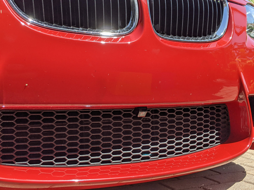

Front:
Image hosted on: i.postimg.cc

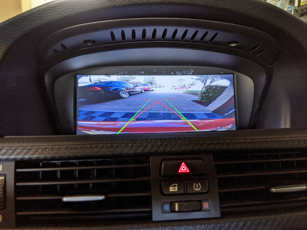

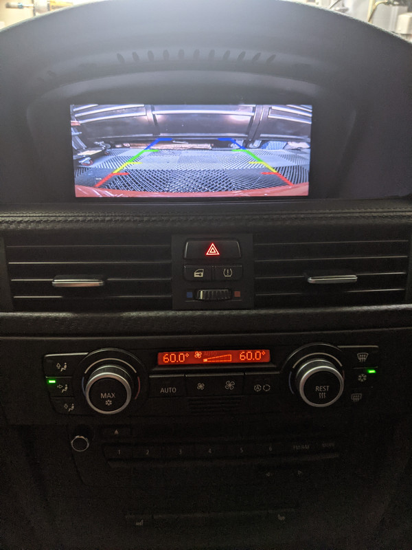

Rear:

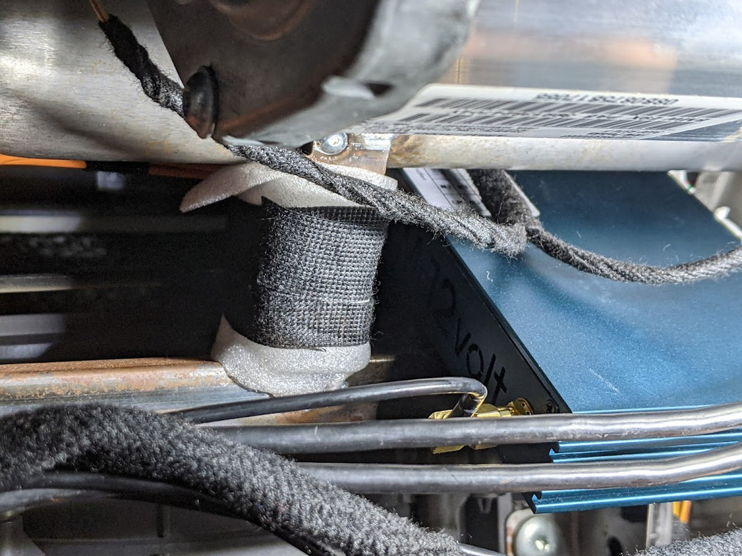

Now I will get into a little more about how I mounted mine which is probably more involved that some would want. I choose to mount mine above the glove box. 12Volt just tucked it to the right side of the cic and left it there. I prefer above the glovebox because I can remove it fairly easy if I need access it. I also think there is more room and can be mounted better.
This is the spot I choose:
I wrapped metal dash frame with some foam packing material and put some oem like Tesa electrical harness tape around it, then zip tied the unit to securely mount it and stop it from rattling around in the dash. Wrapped up the wires to keep things neat.

Edit: I completed my front camera install and just wanted to add this here:
Honestly the resolution/picture quality isn't great, I don't know if it's the shitty fisheye amazon cameras or if it's because the video is stretched vs the smaller OEM like view I've seen other units use. It's not like I am recording motion pictures here, I just need to see where the curb is, so it's good enough for that.
This is the Front Camera I used: https://amzn.to/46r7wtO
This is the rear camera I used: https://amzn.to/3kuFuIl
Front:
Rear:
How the front camera looks mounted:

Oh, and as far as mounting the box goes, I mounted mine on top of the cup holder housing. There’s a large void in between the airbag and the dash. At first I was a little bit concerned about it possibly interfering with the airbag in the event of a crash, but the airbag deploys from the top of the dash vertically, so this area should be just fine. I used the supplied 3M mounting tape to secure it. There may be better options for you E9x owners, but this worked great for me, and it’s right next to the CIC head unit and display. The cup holder mounting brackets also make for a great place to mount your antennas! I mounted those on the passenger side cup holder bracket.
