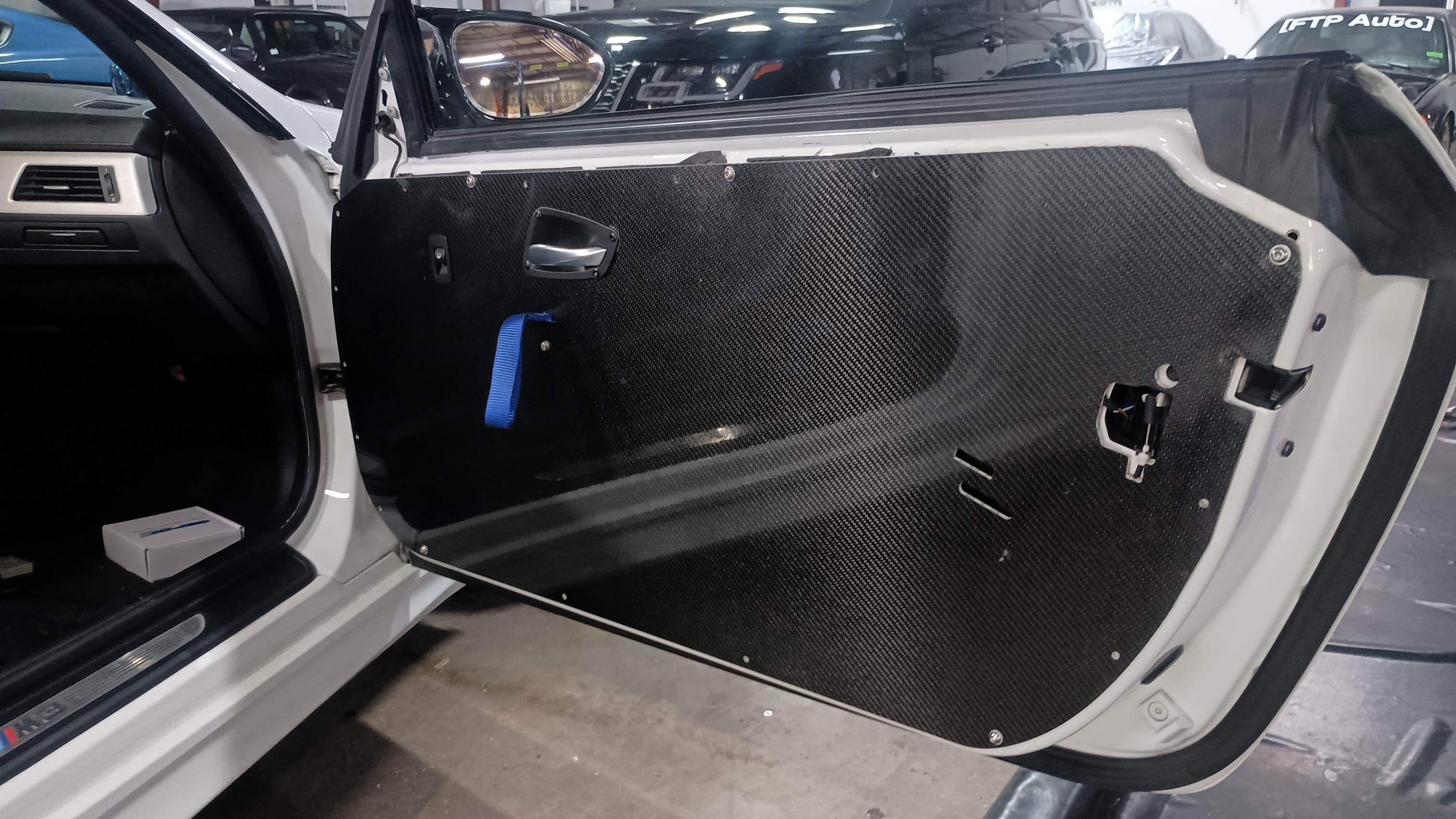

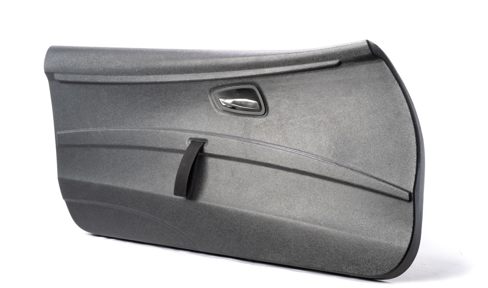

former 240 s14 wroteNot sure what you cards look like but I’d done this on the version I had. Mounted to the door itself.Ah, I think I mislabeled the door pull strap. I want to retain OEM door handles but would love a pull to help shut the door when I am in my containment seat. If you look at what track day does, look at the pull in the center of the door.
https://www.trackcardoorcards.co.uk/product/bmw-e92-e93?srsltid=AfmBOoqw3KmDbawTqrlqQHEgN7zozVOBRMYN6TxHaxBFaiyeKe9K23Z2
Trying to recreate this for the OCT kit.

Never mind. I see the door cards now on OCT site. They have the slots precut for pull straps, no? You just need the strap and bolt?

DRLane wroteThey do have the cut out, I just worry about the card flexing, but I could put an aluminum strap on the back to balance out the load I guess, shouldn't be an issue.Never mind. I see the door cards now on OCT site. They have the slots precut for pull straps, no? You just need the strap and bolt?

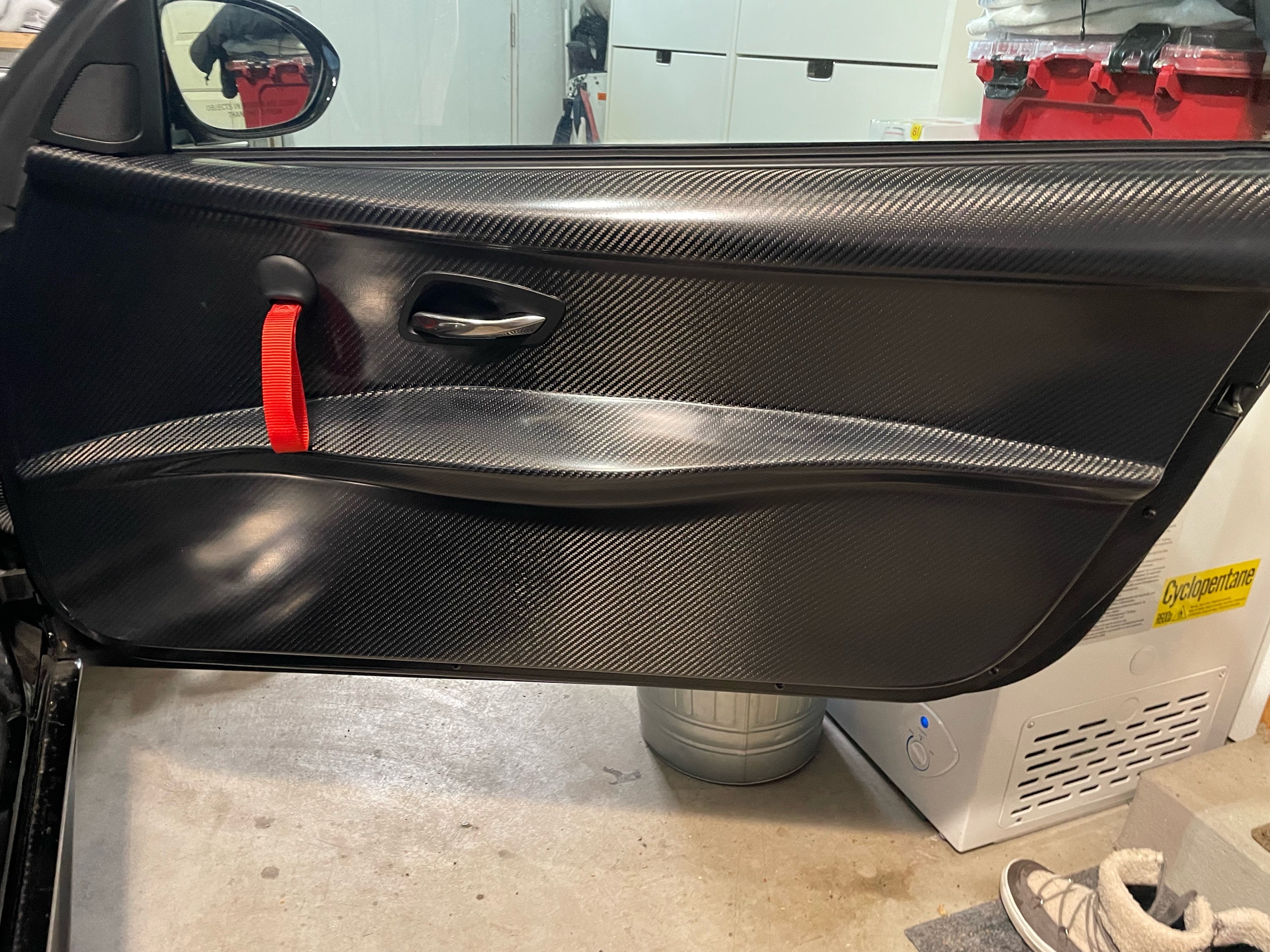

DRLane wroteSorry to threadjack, but who made these? I LOVE that they have an integrated arm rest.Not sure what you cards look like but I’d done this on the version I had. Mounted to the door itself.

former 240 s14 wroteThey sell just the replacement strap too. I’m sure you can finagle something. ActuallyAh, I think I mislabeled the door pull strap. I want to retain OEM door handles but would love a pull to help shut the door when I am in my containment seat. If you look at what track day does, look at the pull in the center of the door.

former 240 s14 wroteYeah definitely mount to the door itself vs door card. There is so much available criss crossing steel back there, but I found moving them forward preferred to rearward if you want to be able to close the door from containment seat.They do have the cut out, I just worry about the card flexing, but I could put an aluminum strap on the back to balance out the load I guess, shouldn't be an issue.

BigTee wroteI think it was fiberlabs another Lithuanian company.Sorry to threadjack, but who made these? I LOVE that they have an integrated arm rest.
Note the arm rest looks cool but impacts fitting wheels/tires relative to the flat panels.
former 240 s14 wroteAh a pull strap, I'm not sure on that one mate... I like how hardmotorsport has theirs located on their door panel, just sort of in the middle.Ah, I think I mislabeled the door pull strap. I want to retain OEM door handles but would love a pull to help shut the door when I am in my containment seat. If you look at what track day does, look at the pull in the center of the door.

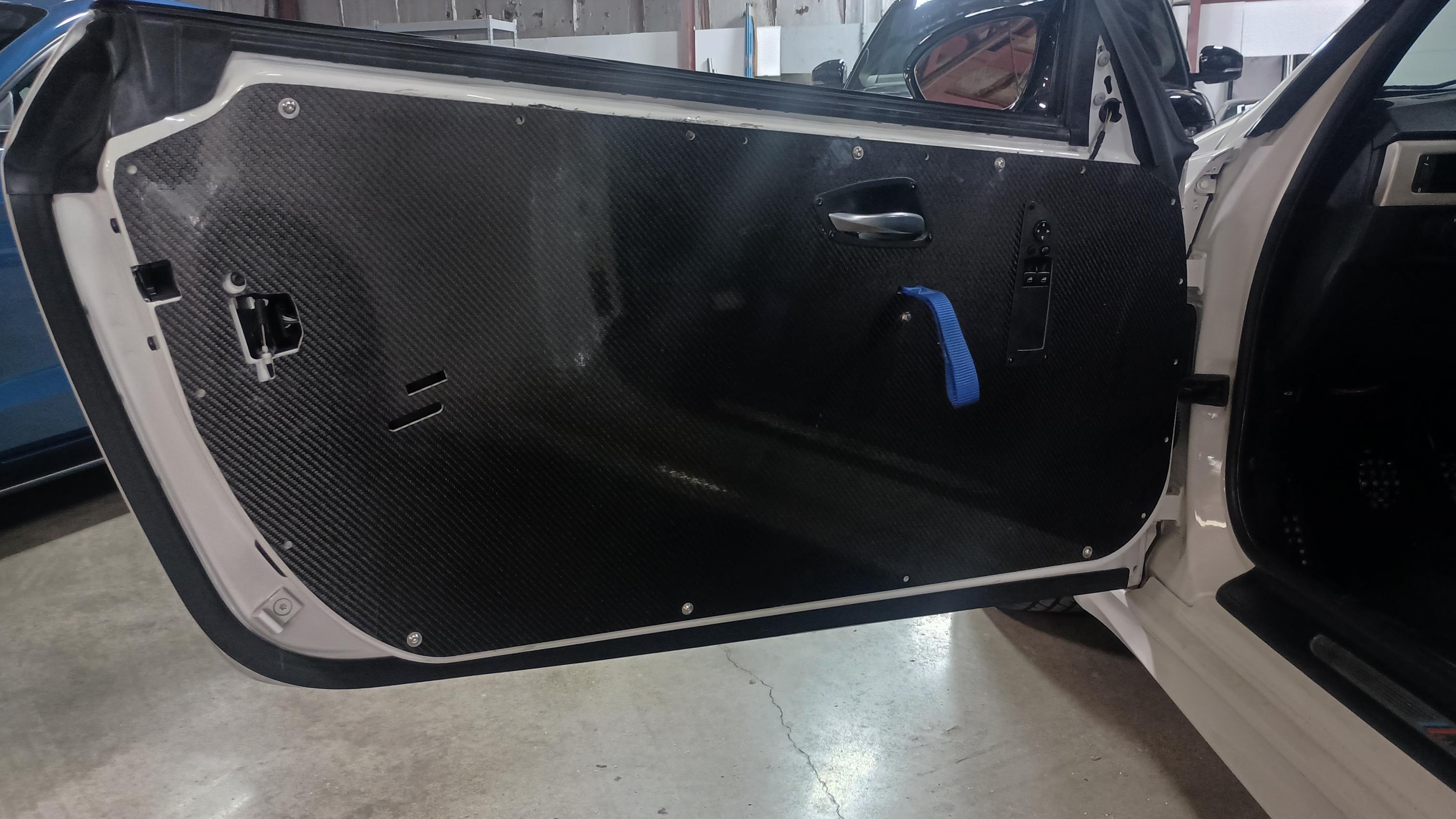

Door cards are 90% in and functional. Need to finish the fine tuning as the doors don't shut as easily as they did before the cards were in.
Very happy with how they turned out.

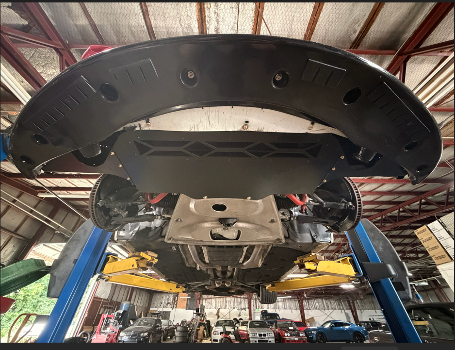

Also, got an EPM undertray and new front liners installed, so that's now out of the way.
