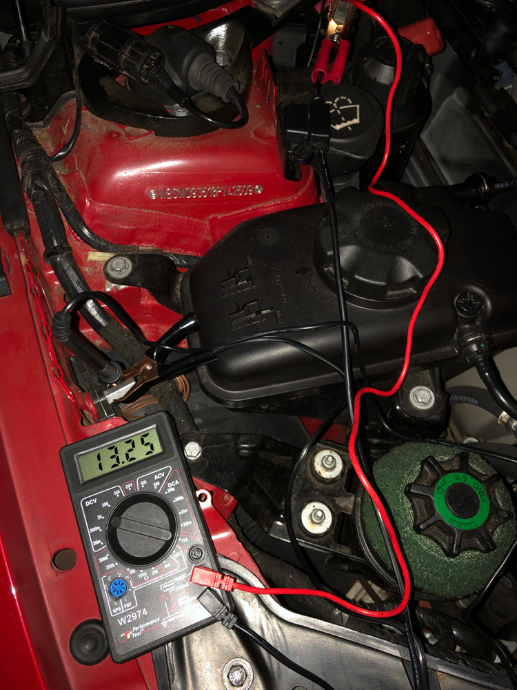

You have posted in the "General M3 Forum" but your profile shows 335xi: It is very likely you need to replace the AGM battery in your car. How old is the battery? All sorts of gremlins come out to play when the battery is no longer accepting charge. The alternator typically starts to fail around the 120K mile mark and you're pretty close. Does the car have the "start - stop" system which turns off the engine when stopped and idling for example at a red light? That system puts stress on the starter motor, and battery. When the car is parked use a multi-meter to check the voltage between the terminals under the hood. See photo of my battery voltage surface charge reading. This forum has a plethora of battery threads with examples of all sorts of codes and weird happenings as the battery begins failing - as well as the alternator. You can check the alternator output by measuring the voltage across the same terminals under hood when the engine is running.
"Weird"...based on OP pic, VIN decoding shows a 2008 e92 M3 yet post indicates related to e90 M3 :confused2
that's not OPs car, just an example of voltage.
i believe they do have a SS E90 M3 though.
