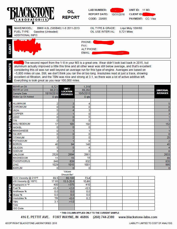

Just did my oil change a few weeks ago and got the report in today.
This is my first "real" analysis. The reason I say real is because the last oil change only had 1,319 miles on it. I did an oil change and did a rod bearing replacement shortly thereafter so I wouldn't read into the previous oil report.
I did rod bearings at 89,292miles. I switched to VAC/Calico rod bearings and ARP2000 bolts. Also switched to Liqui-Moly 10W-60 at the bearing change. The last year I've been commuting a short distance of 3miles each way so for the most part, the engine doesn't get to optimal temperature by the time I get to work/home. Oil sample also has 3 autocross events (12 laps per event).
Here is my bearing post: http://www.m3post.com/forums/showpost.php?p=18815872&postcount=173
Does the TBN mean I can use this oil a little longer? I don't really plan on it as switching every 7.5k miles isn't too bad.
Nice report!
3.1 TBN means few thousand miles left in the oil, I'd go 10,000mi-12,000mi or change once a year, whichever comes first...

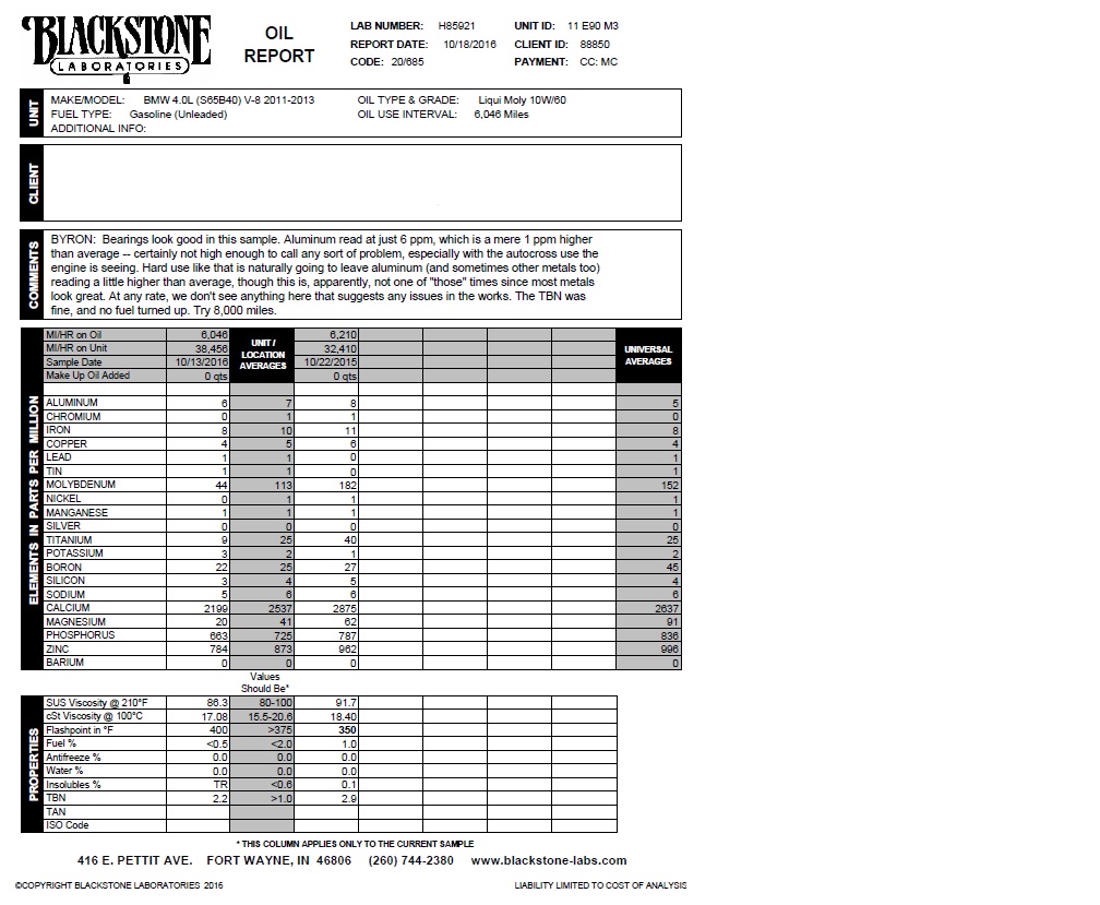

byroncheung wroteMy aluminum number right before my bearing change was 7ppm and my bearings looked like shiite considering 35k miles of use... iron was also 7ppm.I'm jealous about you guys getting lower than average aluminum count. Mine are above average for 2 consecutive runs... Although looks like not high enough to call for action though... Will probably continue to wait and see...
NFW I'd go 8k miles next oil change if I were you.
admranger wrotenah i won't go 8k, still stick to around 5k.My aluminum number right before my bearing change was 7ppm and my bearings looked like shiite considering 35k miles of use... iron was also 7ppm.
your comment on your bearings condition with aluminum and iron at 7ppm worries me... do you have pictures of your bearing when you change them curious to take a look how bad are they.
also with old bearing you can see copper color when they're worn, what is it like with the new bearing when they're worn? haven't seen pictures on them as i recall...
byroncheung wroteMy 2011 vintage bearings are in this thread: Rod Bearing Replacement, 2011 E90M3, 35k milesyou have pictures of your bearing when you change them curious to take a look how bad are they.

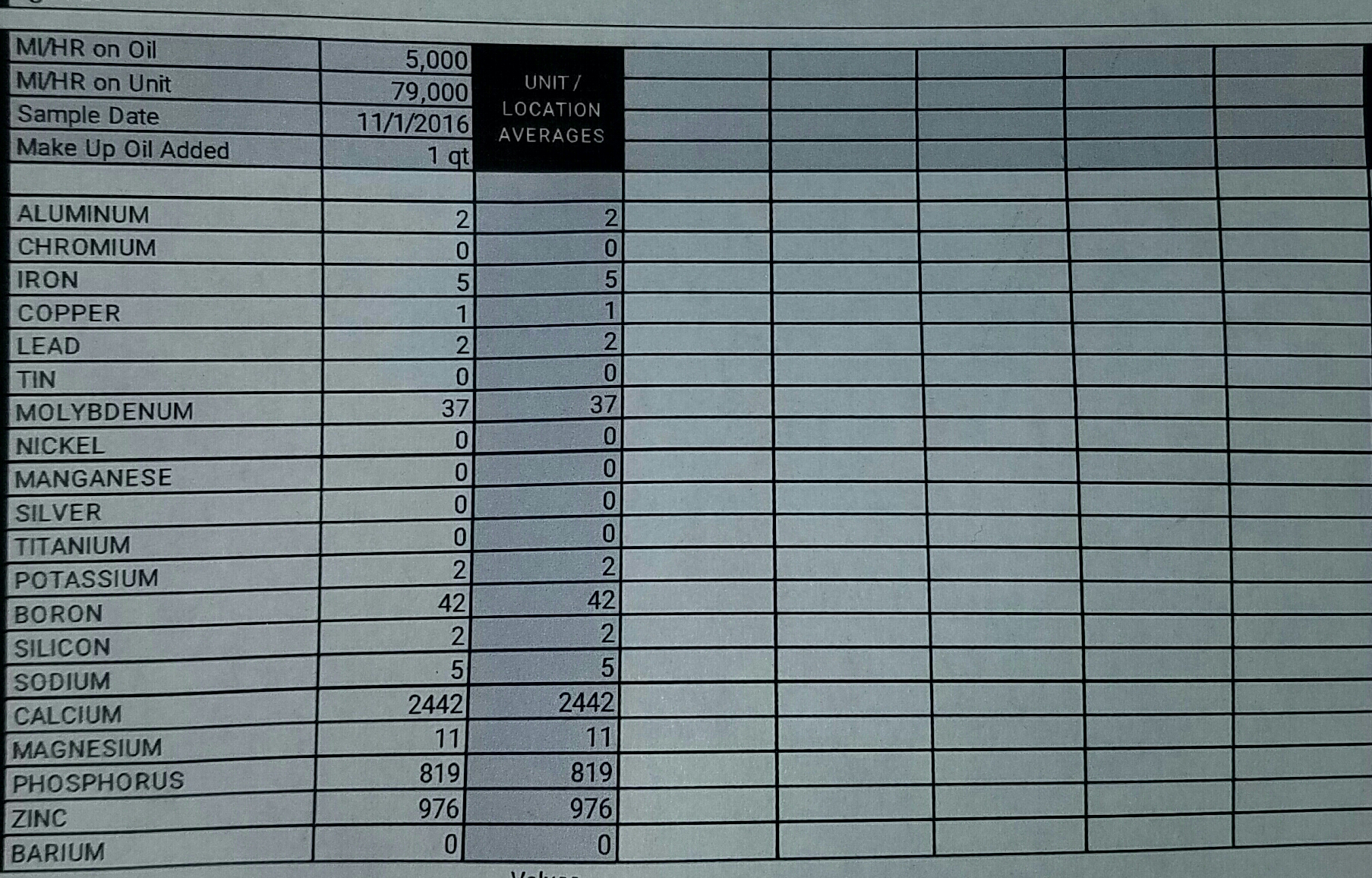

hi all i have a blackstone report for my oil at 5000 mile change interval. I have 2010 m3 with 79,xxx miles with extremly low lead and copper.
i have 2010 m3 with 79,000 miles. My blackstone report showed extremely low levels of copper and lead. I use liqui moly 10w60. I change every 5000 miles. My car is a daily driver.

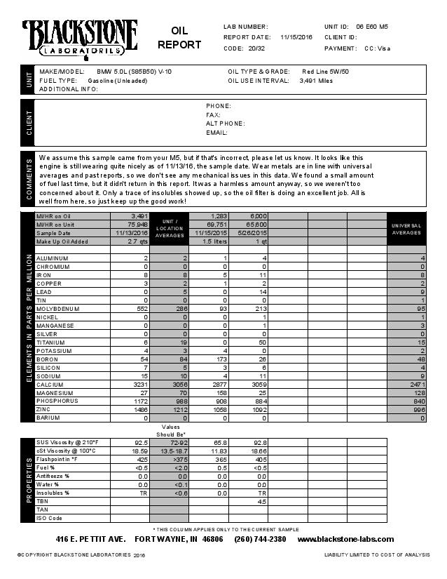

Hi, I just got my 1st report after rod bearing replaced with BE bearing and OEM bolts at 70210 mileage. I hope can get some thoughts from expert here. I very confuse with the lead and copper ppm reading. Doesn't it at least 1 or 2ppm lead make sense? Why the copper ppm reading higher than lead? Any inputs I'm very appreciated. Thanks for advance. Attached is the Redline 5w50 last summer.
ASW338 wroteNo worries bro , it looks goodHi, I just got my 1st report after rod bearing replaced with BE bearing and OEM bolts at 70210 mileage. I hope can get some thoughts from expert here. I very confuse with the lead and copper ppm reading. Doesn't it at least 1 or 2ppm lead make sense? Why the copper ppm reading higher than lead? Any inputs I'm very appreciated. Thanks for advance. Attached is the Redline 5w50 last summer.
///M Power-Belgium wroteThank you very much, BRO ! I can sleep well tonight.No worries bro , it looks good
