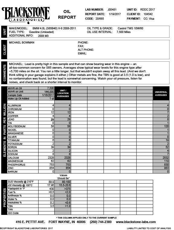

What do you guys think? Gonna get the bearings done after this business trip. 08 147k miles. DD no track days.
Those numbers aren't super terrible for such a long run, but the fact that the car has 145k miles and is still throwing that much lead is worrisome. If it were me I'd do the bearings asap.
Approx 4k miles on fresh bearings. Still some solids floating around since this was the first oil change. These readings are better than brand new. You cant see that data, but even in 2012 readings were worse. Heres to a clean motor!
Magnetic Fusion wroteThe high lead is concerning, but you have no history to go against. A single oil analysis in isolation is of limited use.What do you guys think? Gonna get the bearings done after this business trip. 08 147k miles. DD no track days.

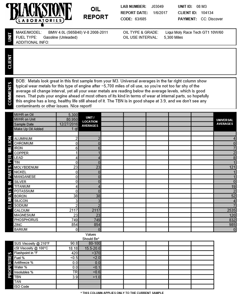

GRM Scott wroteLooks fine, but you need to get multiple reports under your belt to establish trends, as Blackstone said.Another data point for science! 2011 BMW E90 M3, about 42k miles as sampled, oil about 7500 miles old.
I would also pay for TBN and TAN next time so you can start establishing a good change interval.
