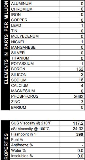

Here's a VOA of the recommended rear end oil for our machines. Search dparm's UOA from a couple years back on BITOG and note nearly identical results when excluding wear metals.

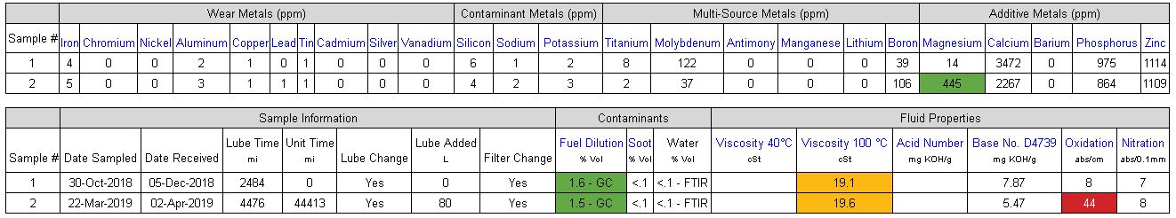

This is some older TWS I came into and ran over the winter. Sealed bottles and stored in a relatively climate controlled environment I'm told. I will investigate the oxidation and advise if I learn anything. Off the top of my head this could be from more ester basestock such as castor oil, but seems a bit high even for that. No extended idling, maybe 800 miles track use or 8 hours. Oil pan heater used below 20 degress F. Lab typos 80L should be .8 top up and you can probably back into the unit mileage from the prior sample.

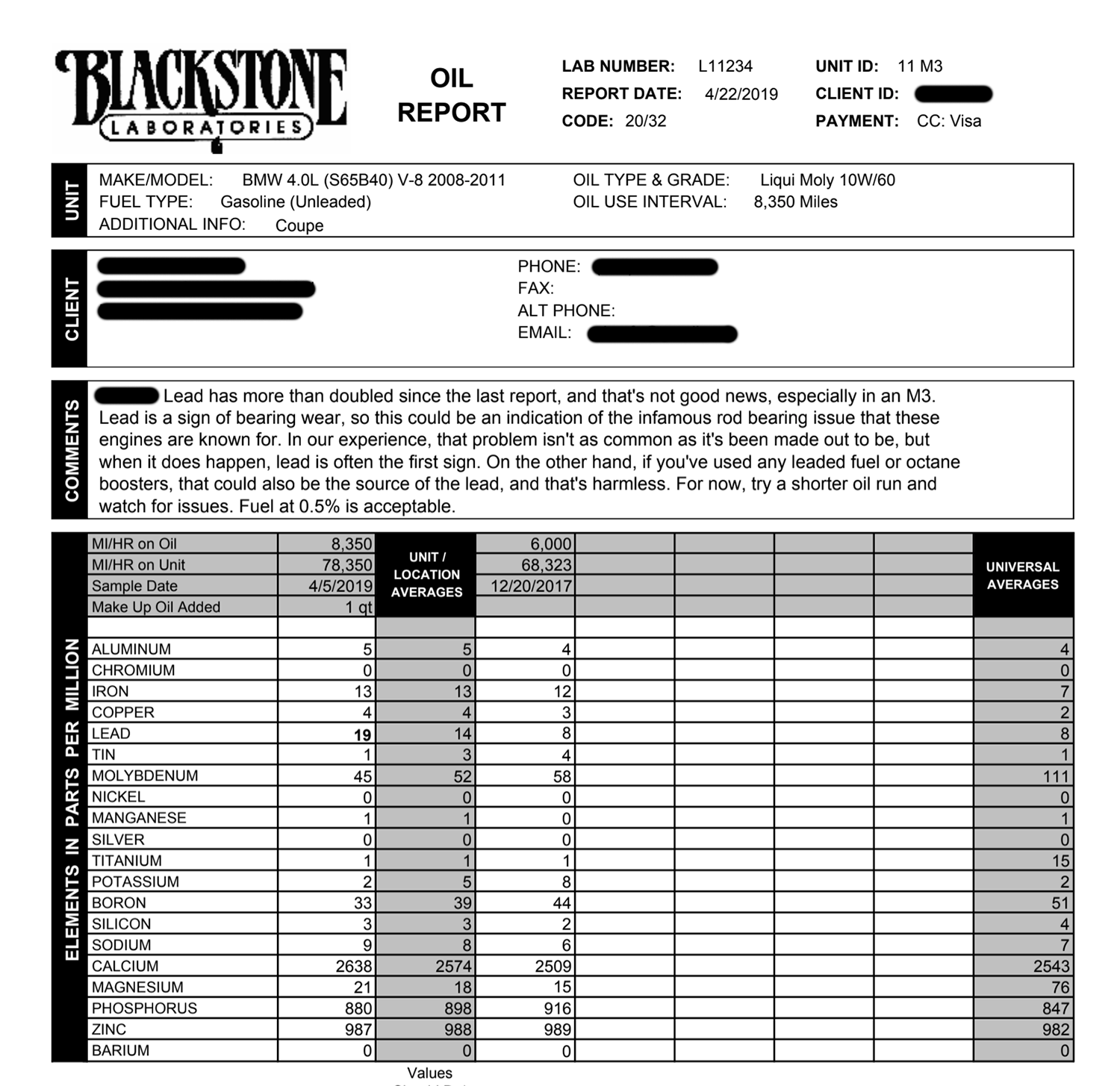

Well, this is hardly the report you want to see. The last test was done early last year (sample was taken in Dec 2017). So basically in ONE year the lead more than doubled.
At this point it's pretty evident something is out of tolerance, obvious guess is rod bearings. The dilemma I have is to get it done ASAP or run another 3k and take a 3rd reading. Car is a daily but I don't commute for work, only fun/task driving.
Update: No fuel additives or leaded gas has been used.
Get it done IMO. The sooner you do, the better your odds of avoiding crank damage.

Prices on that service have come way down and there are a lot of shops who can get it done. I wouldn't wait much longer.
