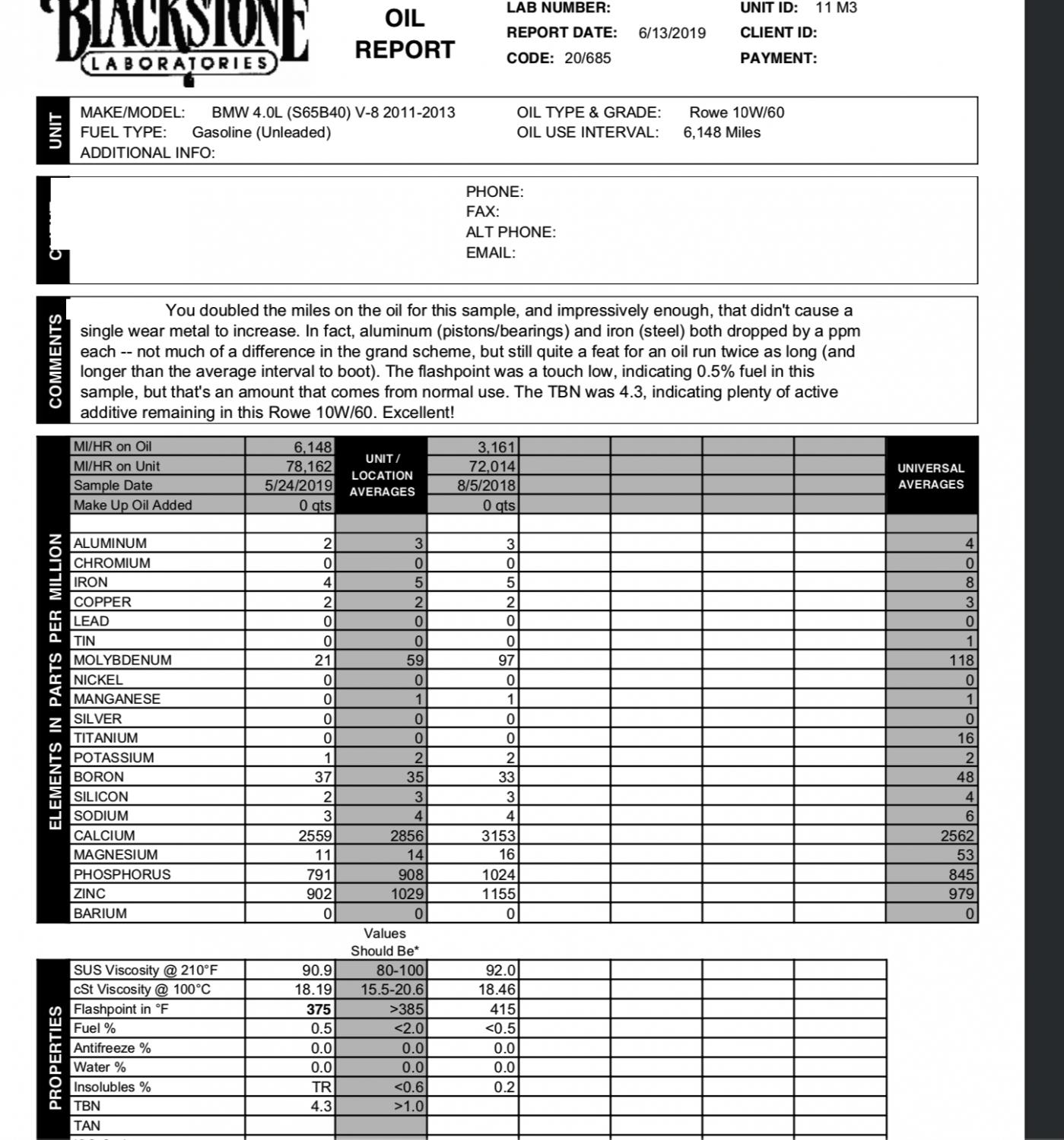

dparm wrote4 months, I'm sending another in as I just registered another 4,000. Thank you for the feedback!It's one report in isolation, but it is the first step in establishing a baseline. Next time, pay for TBN and TAN. Nothing looks out of line: wear metals are low, oil is still in grade, no dilution from fuel/coolant/water, no air filtration contaminants, add pack not totally gone.
2,500 miles isn't much. How long was this in the car for?
If one changed with extra clearance rod bearings (assuming there’s no wear now)..is there way to track metal wear from main bearings?
Factory bearings. Plan on getting them done soon

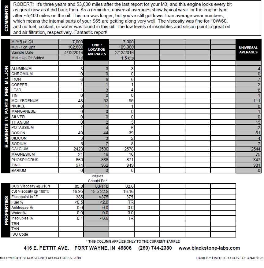

Shiza wroteWow, impressive -- no change in wear metals over 3 years and over 50k miles.Factory bearings. Plan on getting them done soon

Two track days, daily driving, winter storage, then daily driving duties again followed by two days of driving about 1000 miles per before the oil change. Not bad overall for the Rowe.
Previous oil analysis was on the Liqui Moly 10W60. Next one will be on the BMW-Shell oil with BE bearings.

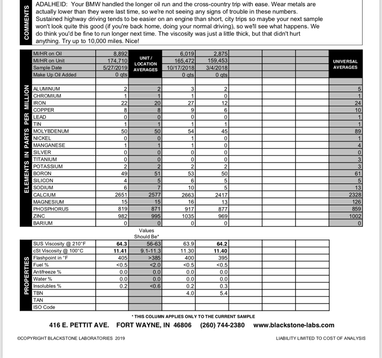

Didn't intend to run my oil this long but was at an academy down in GA where they couldn't get my car on a lift and no place had pits! Car drove from NY to GA then GA to AZ.

What's the feeling on 10,000 miles!? That's insane I'm trying to keep my car past 500,000 idk if that would be smart...

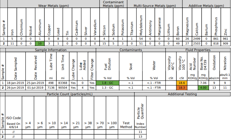

2008 6MT
7136 miles on the oil
90504 miles on the engine
Follow-up from this.
Did valve cover gaskets shortly before this drain, so that's probably where the Si is coming from.
Pb is down as expected for the second oil change after the rod bearing job. Hoping that copper number is just a blip or something...
Copying the numbers here because Polaris's reports are kind of annoying to read:
Iron - 11
Chromium - 0
Nickel - 0
Aluminum - 10
Copper - 3
Lead - 1
Tin - 0
Cadmium - 0
Silver - 0
Vanadium - 0
Silicon - 15
Sodium - 5
Potassium - 3
Titanium - 0
Molybdenum - 51
Antimony - 0
Manganese - 0
Lithium - 0
Boron - 49
Magnesium - 27
Calcium - 2503
Barium - 0
Phosphorus - 818
Zinc - 909
Fuel Dilution - 1.3% (GC)
Soot - <0.1% by vol.
Water - <0.1% by vol. (FTIR)
Viscosity @ 100º C - 18.3 cSt
TBN - 4.00
Oxidation - 13
Nitration - 11
Particle Quantifier (PQ) Index - 13
Iron - 11
Chromium - 0
Nickel - 0
Aluminum - 10
Copper - 3
Lead - 1
Tin - 0
Cadmium - 0
Silver - 0
Vanadium - 0
Silicon - 15
Sodium - 5
Potassium - 3
Titanium - 0
Molybdenum - 51
Antimony - 0
Manganese - 0
Lithium - 0
Boron - 49
Magnesium - 27
Calcium - 2503
Barium - 0
Phosphorus - 818
Zinc - 909
TBN - 4.00
Oxidation - 13
Nitration - 11

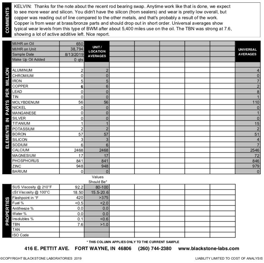

Oil change after 650 miles on new BE bearings. Oil is BMW OE 10W-60.
