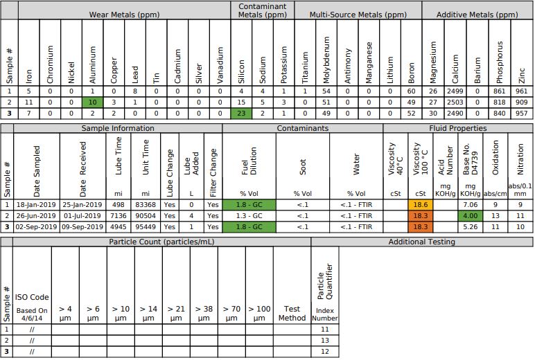

Follow-up from this.
Two road trips, a few blasts at the Tail of the Dragon, one tank of no-name non-ethanol gas, and one Techron treatment on this run. Also caught and fixed a pre-cat exhaust leak on one bank near the end, so there's probably some sub-optimal running as well (might explain the fuel dilution).
No idea where the silicon has come from. Maybe the VC gasket change I did just before this oil went in?
Copying the numbers here because Polaris's reports are kind of annoying to read:
Iron - 7
Chromium - 0
Nickel - 0
Aluminum - 2
Copper - 2
Lead - 0
Tin - 0
Cadmium - 0
Silver - 0
Vanadium - 0
Silicon - 23
Sodium - 2
Potassium - 1
Titanium - 0
Molybdenum - 49
Antimony - 0
Manganese - 0
Lithium - 0
Boron - 52
Magnesium - 30
Calcium - 2490
Barium - 0
Phosphorus - 840
Zinc - 957
Fuel Dilution - 1.8% (GC)
Soot - <0.1% by vol.
Water - <0.1% by vol. (FTIR)
Viscosity @ 100º C - 18.3 cSt
TBN - 5.26
Oxidation - 11
Nitration - 10
Particle Quantifier (PQ) Index - 12

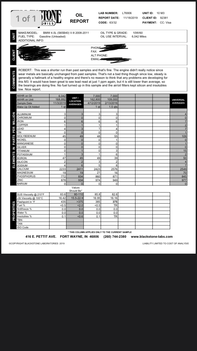

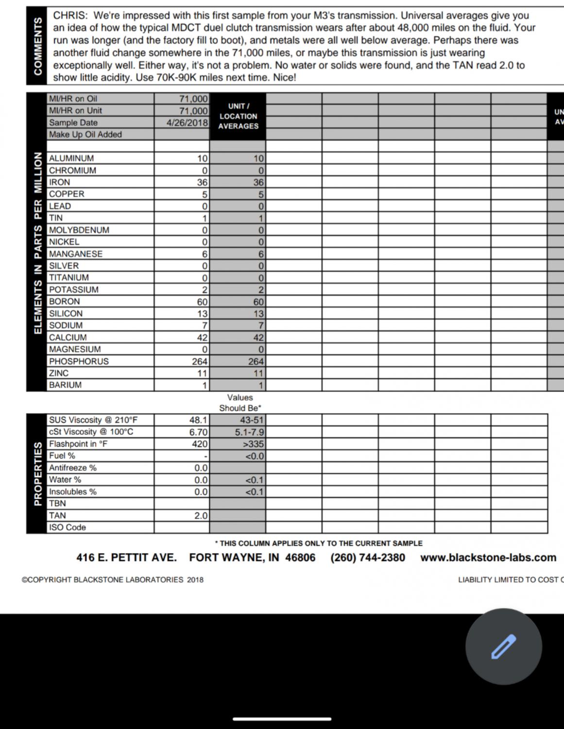

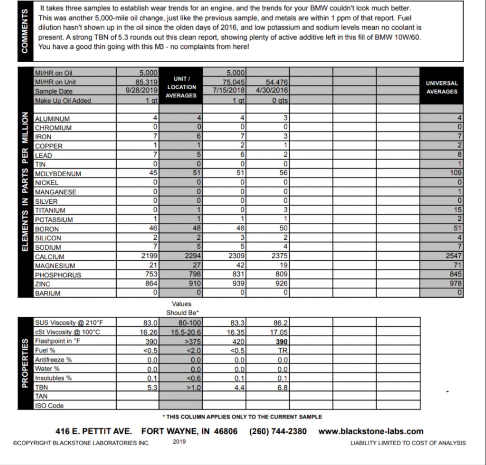

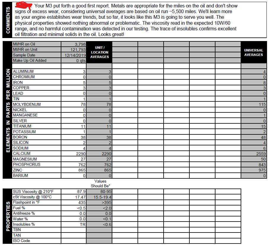

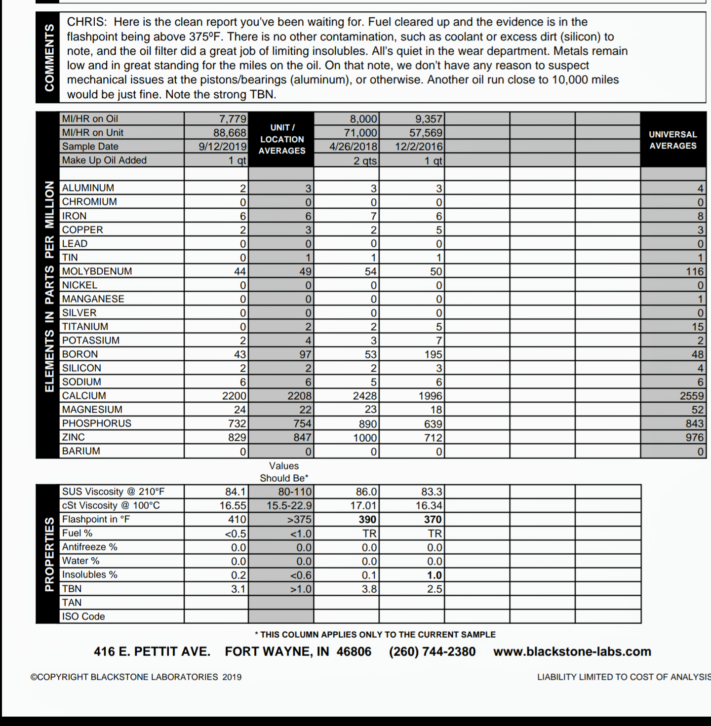

I just got the latest analysis for my 08 on original bearings. BMW 10w60
Uploading my most recent Blackstone analysis (~88.5k, original owner) for anyone who wants to take a look.
Also, adding a DCT fluid analysis at 71k I never got around to uploading.
The PDFs have your personal information in them. You should remove them and take a screenshot instead so you can edit it easier.
Trending well. Keep doing what you're doing.
Looks pretty good. I think your change interval is spot-on.

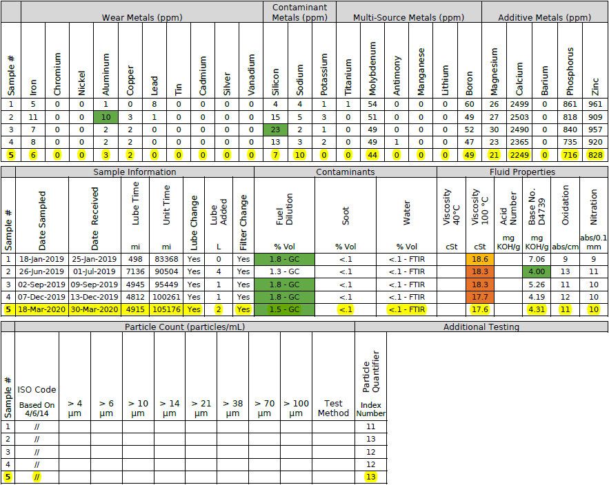

2008 6MT (702/703 rod bearings)
4915 miles on the oil (BMW TwinPower Turbo 10W-60)
105,176 miles on the engine/car
In the 20k miles prior to this OCI, I caught and fixed at least 3 possible causes of fuel dilution: failed coolant thermostat, a precat exhaust leak, and a precat O2 sensor failure. Each time I hoped the fuel dilution would come down. Maybe it finally happened, if only slightly.
Nothing else of note in this OCI.
Copying the numbers here because I don't like how Polaris's reports are formatted:
Wear Metals
Iron - 6
Chromium - 0
Nickel - 0
Aluminum - 3
Copper - 2
Lead - 0
Tin - 0
Cadmium - 0
Silver - 0
Vanadium - 0
Particle Quantifier (PQ) Index - 13
Contaminant Metals
Silicon - 7
Sodium - 10
Potassium - 0
Multi-Source Metals
Titanium - 0
Molybdenum - 44
Antimony - 0
Manganese - 0
Lithium - 0
Boron - 49
Additive Metals
Magnesium - 21
Calcium - 2249
Barium - 0
Phosphorus - 716
Zinc - 828
Other Contaminants
Fuel Dilution - 1.5% (GC)
Fluid Properties
Viscosity @ 100º C - 17.6 cSt
TBN - 4.31
Oxidation - 11
Nitration - 10
