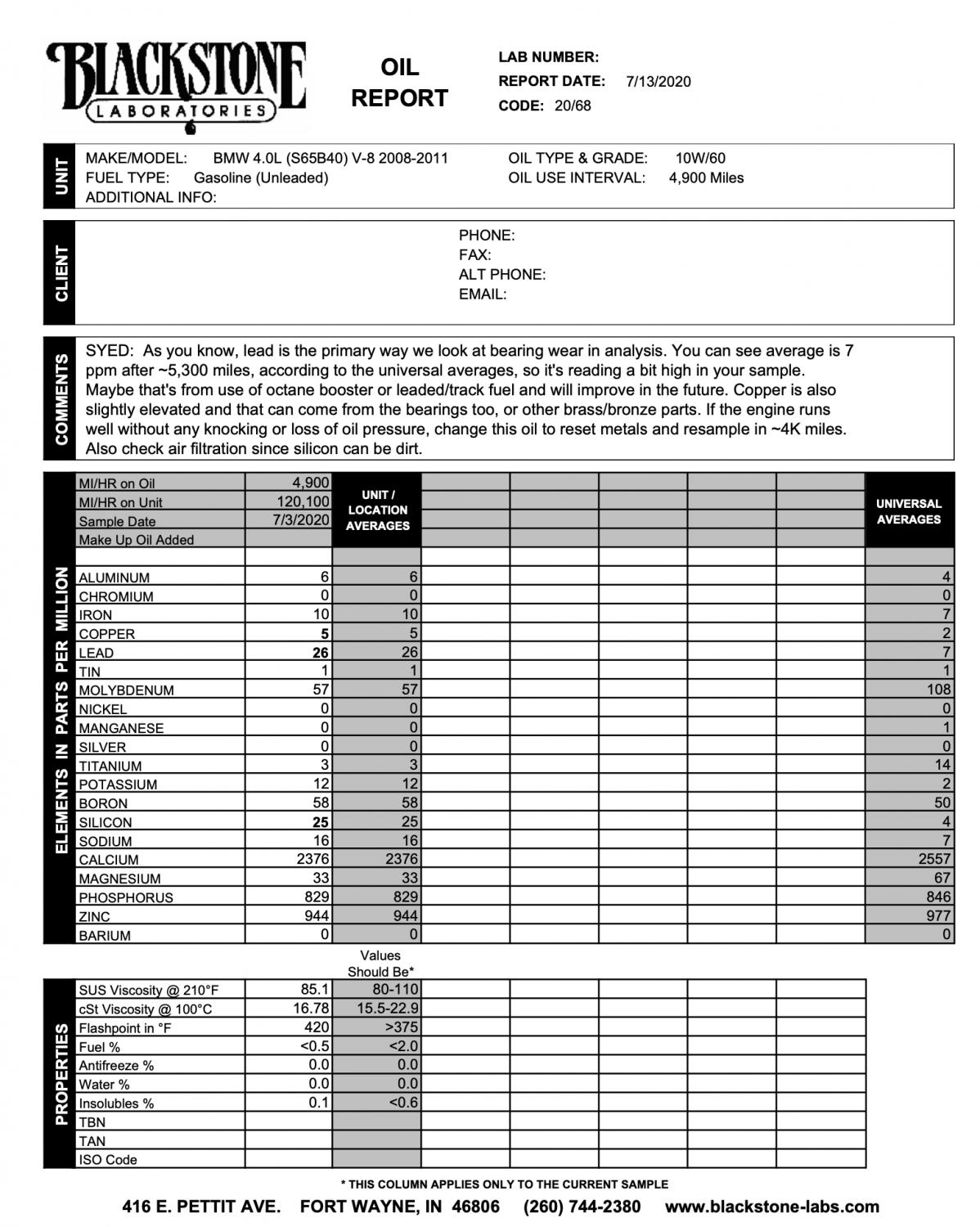

Just got oil analysis back for my new-to-me 2008 M3. AFAIK, these are original bearings. Given the engine has 120k miles on it, an oil analysis is the first thing I did. Lead looks especially high and Silicon reads high as well. Only put ~600 miles on the car before oil analysis, only 93 octane and PO did not track car so no leaded fuel likely on this oil. Looks like I may start looking for a reputable shop to replace bearings... Thoughts?
scherlock wroteYep, get it done ASAP. That’d be a good call even if the report came back clean.Just got oil analysis back for my new-to-me 2008 M3. AFAIK, these are original bearings. Given the engine has 120k miles on it, an oil analysis is the first thing I did. Lead looks especially high and Silicon reads high as well. Only put ~600 miles on the car before oil analysis, only 93 octane and PO did not track car so no leaded fuel likely on this oil. Looks like I may start looking for a reputable shop to replace bearings... Thoughts?
Also, have the intake and vacuum system checked for leaks, and make sure there’s a decent air filter in there.
Yea, I hope both you guys have done your bearings by now?
That pb level is likely trouble!

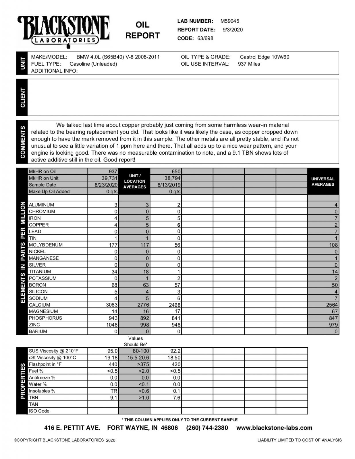

kcdedric wroteFollow-up report after 937 miles.Oil change after 650 miles on new BE bearings. Oil is Castrol 10W-60.
kcdedric wroteinteresting. Mine report is similar to yours.. some copper but no lead. I am very curious as wellFollow-up report after 937 miles.

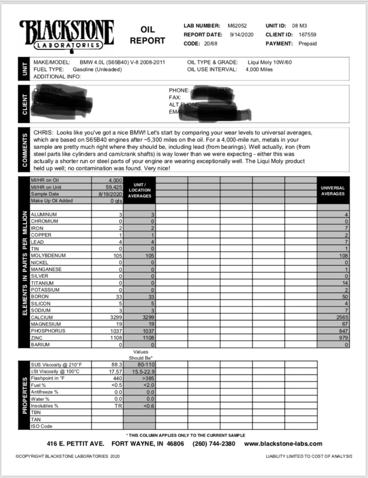

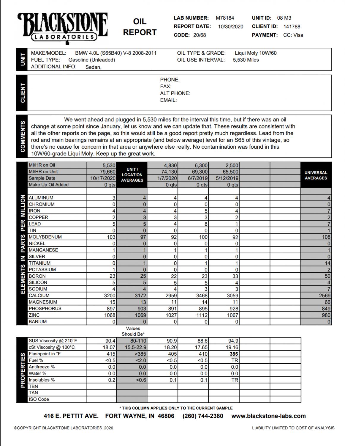

Here's my first Blackstone Report.
2008 with just over 60,000 miles now.
Original rod bearings.
The car was parked for 4 years before I bought it in August of 2018, but didn't get it drivable until the following November.
Bought it from a friend who is the original owner.
It had just over 42,000 miles when I bought it.
Original owner never tracked, always warmed up, but not babied.
Has had a G-Power blower since the 6000 mile mark, so that's 54,000 miles with the blower.
The car was well maintained and was on a yearly oil change schedule at the local BMW dealership.
When I bought it, I switched it from the oil (TWS 10w60) that the dealership was using, to LiquiMoly 10w60 on a recommendation from a local BMW specialty shop.
I change the oil myself at 5000ish miles, but more often if there are track days involved.
I always let the idle calm down after starting it, usually sit in the driveway for a few minutes, never over 3000rpm until fully warm, always drive in M mode (Power/EDC comfort/DSC off).
California car, so 91 octane Chevron, sometimes Shell.

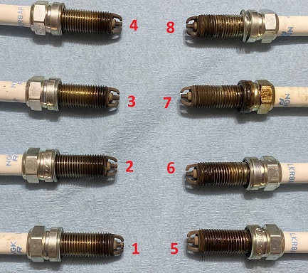

IamFODI wrotePlug tips look good to me, brownish colour, although the photo is a little distant.Previous report here. Now at 110107 miles on the engine. 4931 miles on the oil in this sample.
Consumption has jumped to ~1 L / 1500 mi, which is roughly where it was when I bought the car with leaking valve cover gaskets. I fixed those (which cut consumption in half) and haven't noticed other leaks, though I have noticed what look like traces of oil on some of my spark plugs (pic attached). Wouldn't mind some feedback on that.
I replaced the oil separators preventatively when I changed the oil. Was going to do the PCV valve as well but chickened out. Had a BMW crankcase pressure test done recently and was right in the middle of the normal range, though that was only at idle.
Fuel dilution was originally reported at 2.1%. Seemed high, so I asked them to re-run that test to verify. New number is 1.6%. Hoping that's the real one.

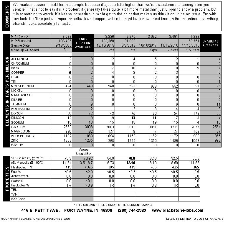

Hi, I got my oil report showing increasing copper in ppm every test. Rod bearings was replaced with BE bearings and OEM bolts at 70,000 mileage on motor and now is 106,000. Just only 35,000 on BE Bearings. I hope to get some thoughts from expert here. To my understanding, that BE Bearings are made by multiple layers, Clevite TriArmor Coating (outer), Babbitt Alloy (center) and the last layer Lead-Copper Alloy. Is it showing the rod bearings already worn to copper layer and should I worry about it? What other parts in the motor would cause this increasing copper? Any inputs and advice will be much appreciated. Thanks in advance.
It would have to wear through the lead layer 1st to get to the copper in the rod bearings. [edit] Unless the lead had been worn through prior to the oil reports.
Your lead readings are zero so it can't be from them. Not sure where the copper is coming from really, maybe a bronze bush(es) wearing somewhere? Can't think off hand what would have them....
Ask them where they think it could come from.
ASW338 wroteLikely your main bearings which were already worn outHi, I got my oil report showing increasing copper in ppm every test. Rod bearings was replaced with BE bearings and OEM bolts at 70,000 mileage on motor and now is 106,000. Just only 35,000 on BE Bearings. I hope to get some thoughts from expert here. To my understanding, that BE Bearings are made by multiple layers, Clevite TriArmor Coating (outer), Babbitt Alloy (center) and the last layer Lead-Copper Alloy. Is it showing the rod bearings already worn to copper layer and should I worry about it? What other parts in the motor would cause this increasing copper? Any inputs and advice will be much appreciated. Thanks in advance.

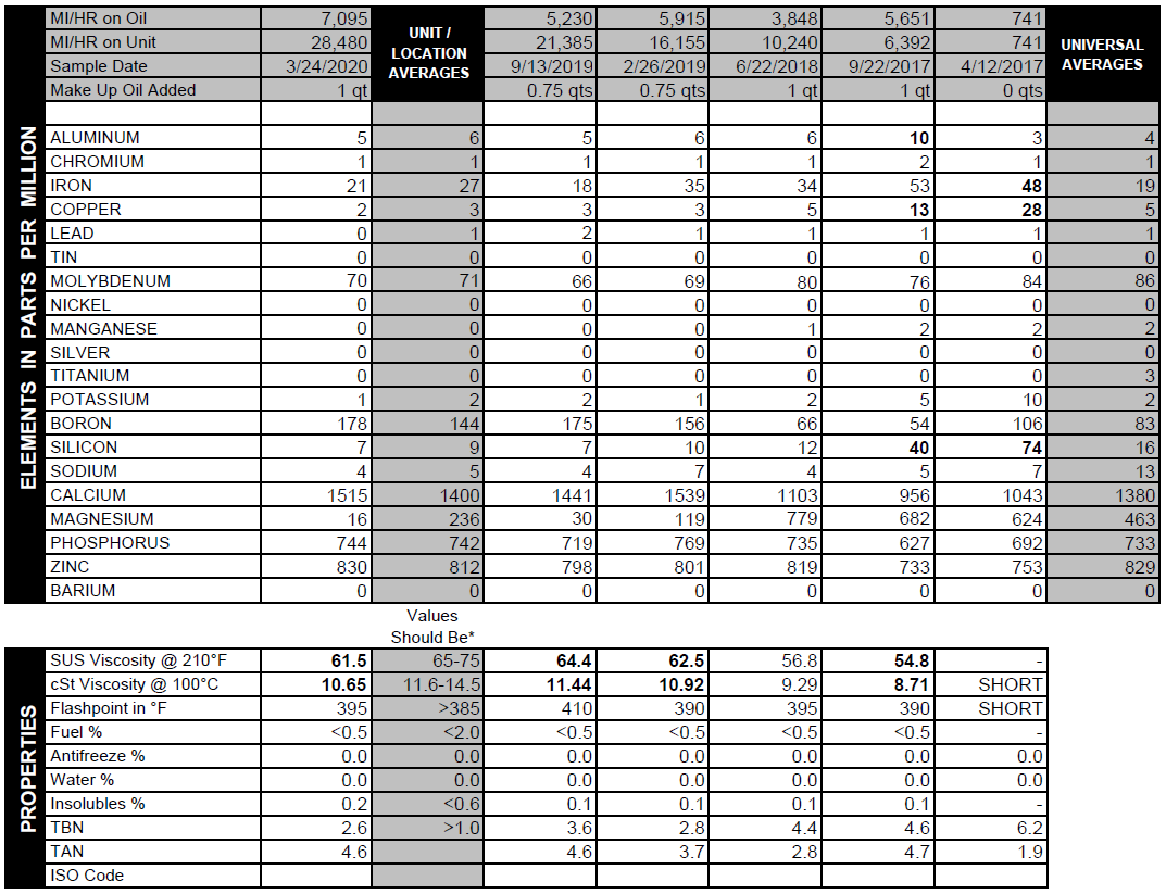

Thoughts? Aluminum/Tin bearings. 1000km, all track usage, from the latest sample. Car is only track driven. ~45k KM on the motor.
Blackstone suggested to continue oil sample intervals of 1000km to track potential bearing wear. As it stands now I think the bearings are holding up good based on the report and how the samples have been trending.
Opinions??
Opinions??
