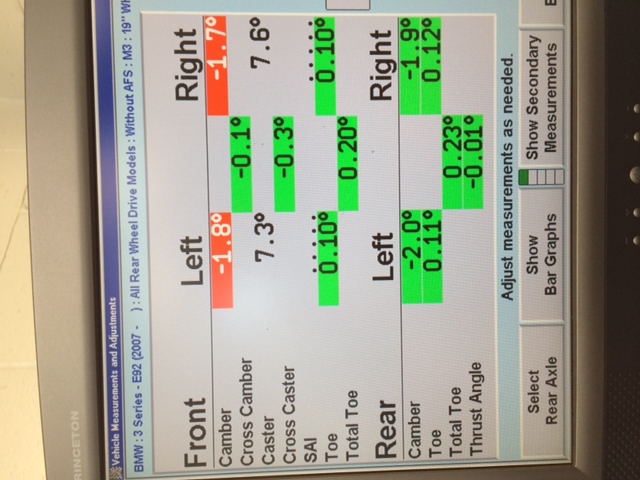

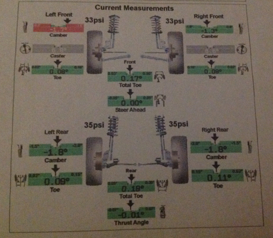

My only issue is that they could get 1.9 camber in the front right but only 1.3 on the left side. Without camber plates and since it's lowered on swifts they said it's impossible to get it to match. Can someone confirm this is infact the case.

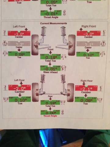

Alignment tech said he couldn't get the front driver side camber to match the pass side. Suspension mods are Bilstein/Eibach B12 kit, Rogue tension rod bushings, DEFIV brace and TMS solid sub mounts. Can anyone tell just by looking at the current sheet what might be the issue?
So I recently had my alignment done and my camber seems real high to me. The tech suggested these settings. I am running KW V3 and the rear is pretty much all the way down. Car sits just off the tires front and rear.
Front is 2.0 on both sides
Rear is 2.4 on both sides. He said he was having problems getting the driver side any more positive but he couldn't see anything physically damaged.
Any ideas or comments?
dmk08 wroteis there a reason he has the back that negative?So I recently had my alignment done and my camber seems real high to me. The tech suggested these settings. I am running KW V3 and the rear is pretty much all the way down. Car sits just off the tires front and rear.
