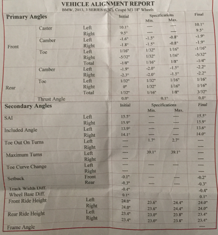

Anyone to comment on my current geometry:
'13 E92 ZCP
Stock EDC suspension with pins pulled
ZCP wheels
PS2 tires
aligned with ballast in driver seat
Car is used for Track, AutoX and as a DD. I asked for max camber at the front, but was already there. Asked for 0" toe at the front and 1/16" toe in at the back but seems like they didn't really hit it.
'13 E92 ZCP
ZCP wheels
PS2 tires

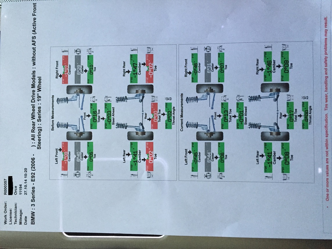

Hi, this is my first post, so sorry if this is in the wrong place. I'll be honest I'm confused .... I have a standard e92 m3 2013 19 inch optional alloys. The car was pulling to the left when at speed approx 80 mph so got a shop to align the wheels, they gave me a printout but I have no idea if it's good or bad? The fact that the print out is all green once they are done must be a good thing ?
They can set machine to whatever specs they want so showing green doesn't mean much. Looks like they took away some front camber which isn't a good thing I would want more even on street car. Also took your rear toe from - to positive number. Can't remember how that works but should have slight toe in on rear.
Thanks for your comments, they loaded up the specs for e92 2006 - 19" wheel, I'm now thinking there must be a m3 version they should have loaded.
I usually go in knowing what specs I want and have them do it, but mine has been track car. Did same on my x5d though also.
