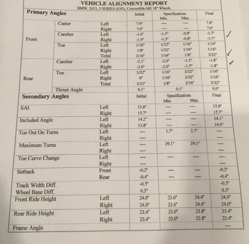

-2 F, 0 toe
-1.5 R, light bit of toe in
Nice compromise of street performance with light track use.

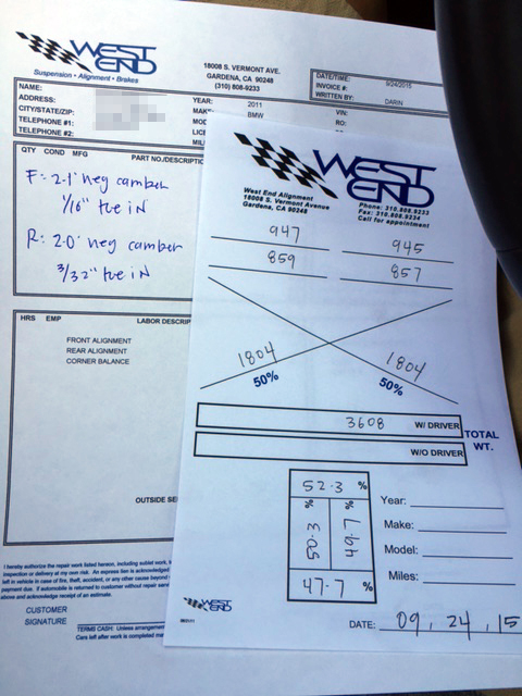

cenix wroteOh man, waiting in the car for the cornerbalance was excruciating but their workmanship is top notch. Chris did all the work and was just hustling everywhere to get me out ASAP haha^ Darin and Chris are the best.
