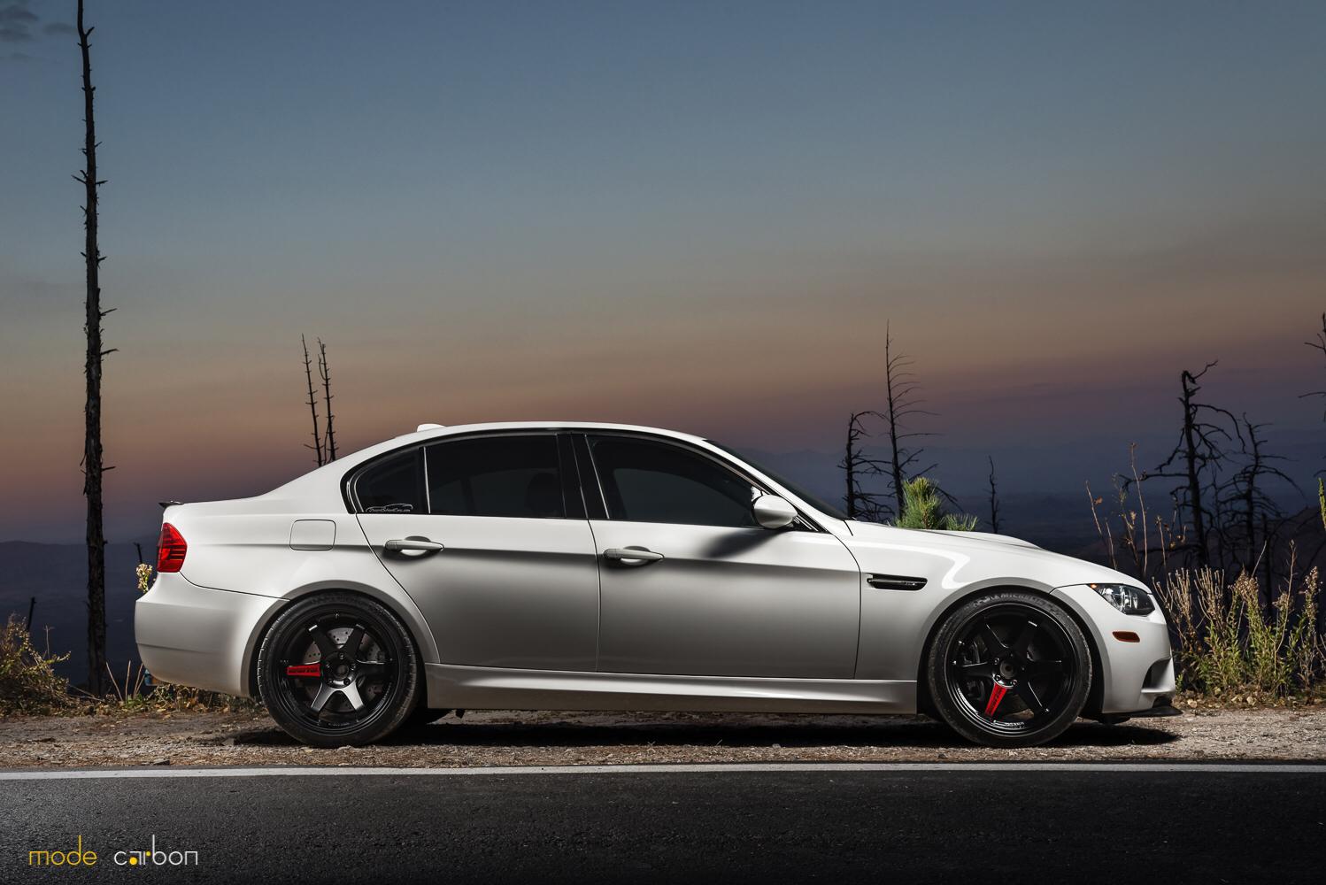

Here's mine on 19" TE 37sl

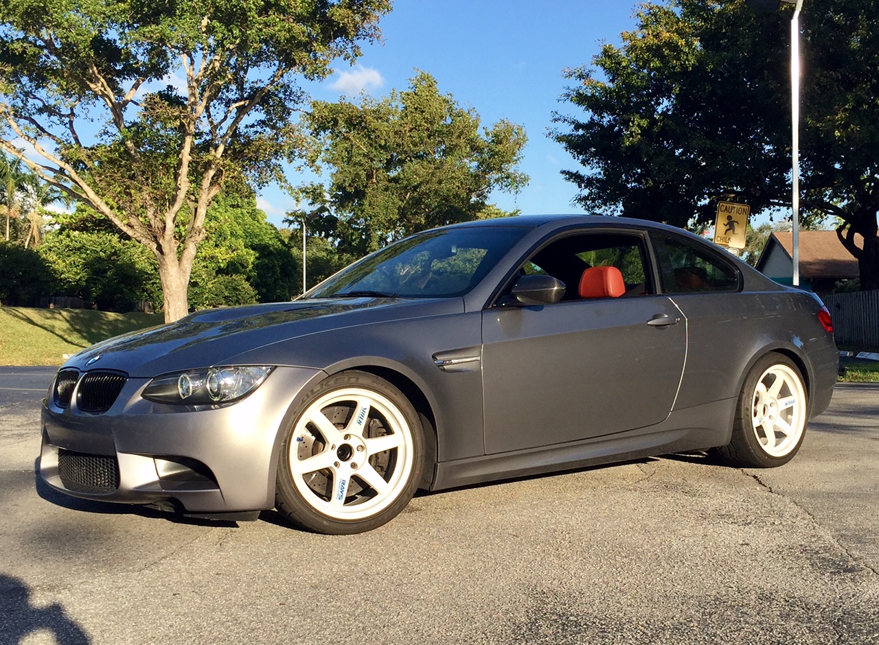

Image hosted on: i1210.photobucket.com
9.5, 10.5
Diamond Black SL's
Image hosted on: i65.tinypic.com
9.5, 10.5

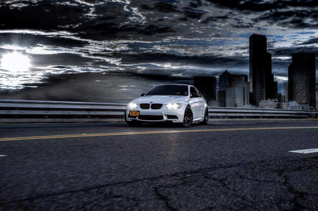

Nice rolling shot:thumbsup:
Excited to finally be able to contribute to this thread, been wanting to own TE37s since I put them on all my cars in Gran Turismo 2 back in middle school :cool:
Fresh off the track
Remote image:Image hosted on: c1.staticflickr.comUntitled by Chamba, on Flickr

Te37sl in action
