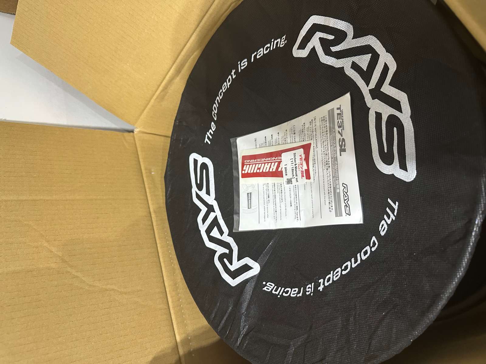

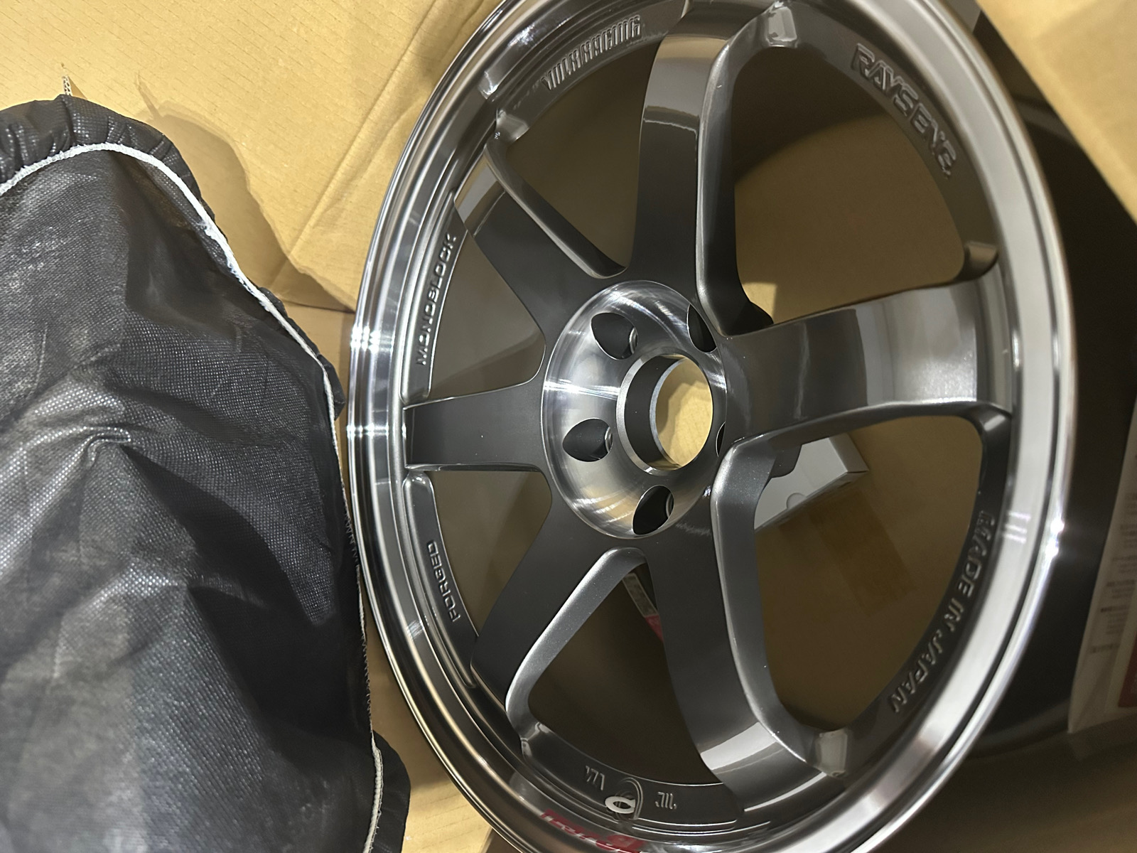

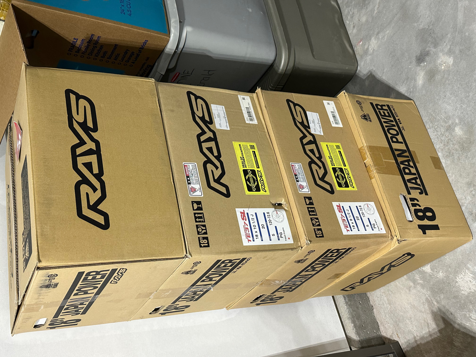

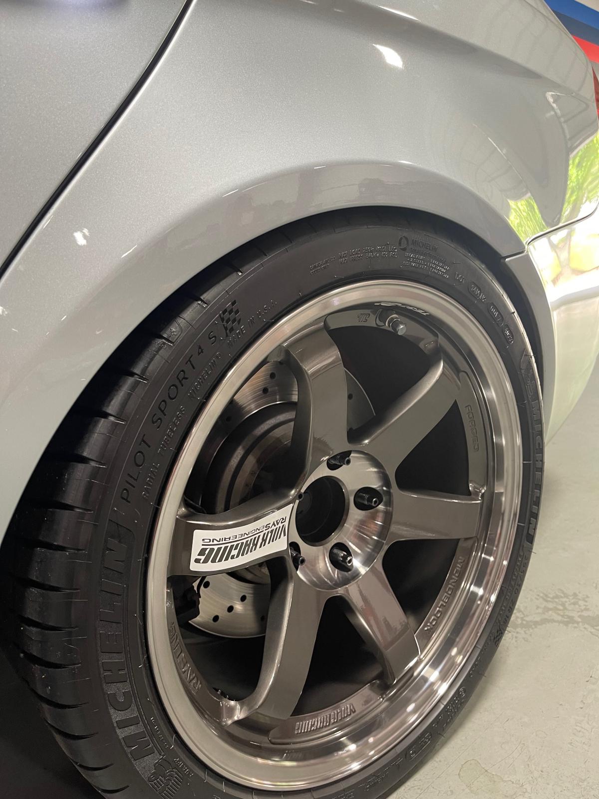

Thrilled to be joining the SL club.
Picked these up from a local seller brand new.
Any official spoke decal/sticker vendor? I want a metallic white and see a bunch of random colors available on sites like Etsy and Amazon.

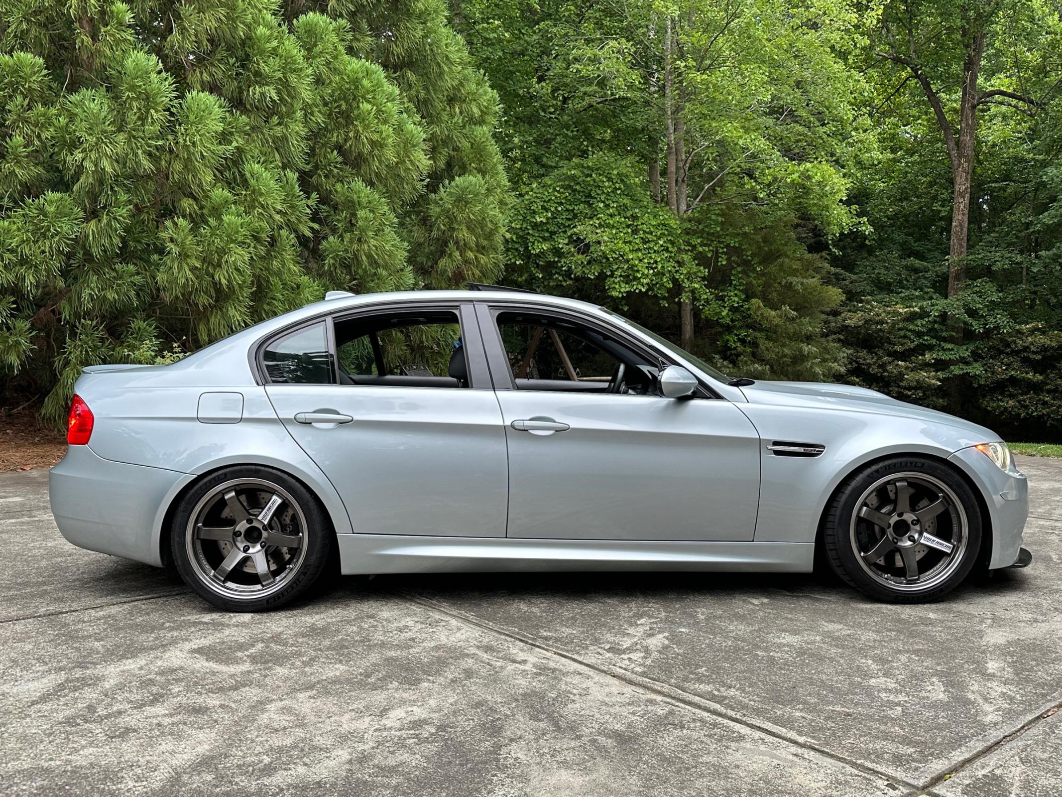

Mag blue

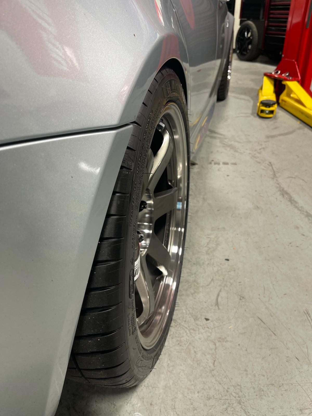

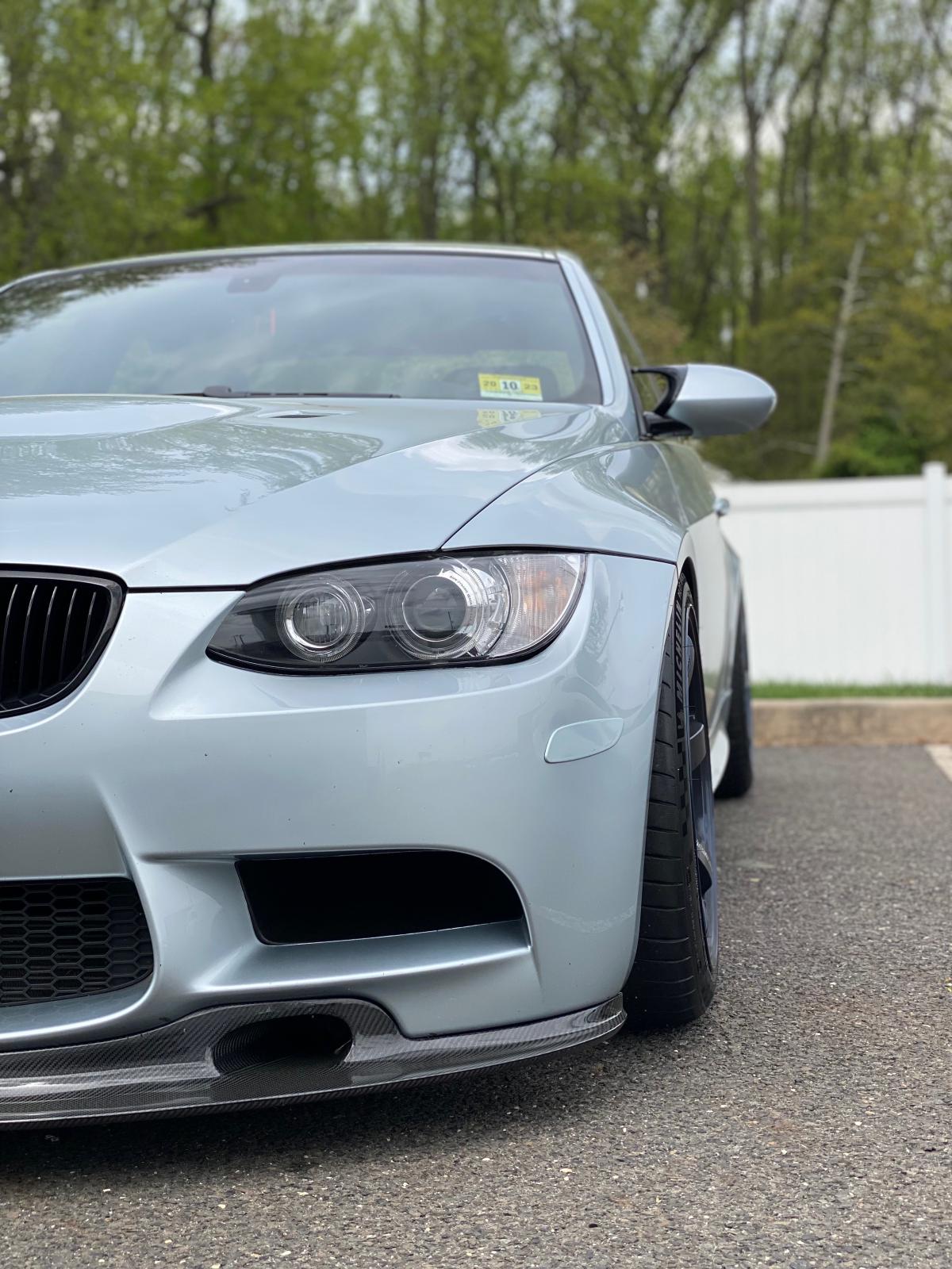

Finally got my pressed graphite Te37 sl’s from Evasive that I ordered a year ago and had tires installed at EAS.

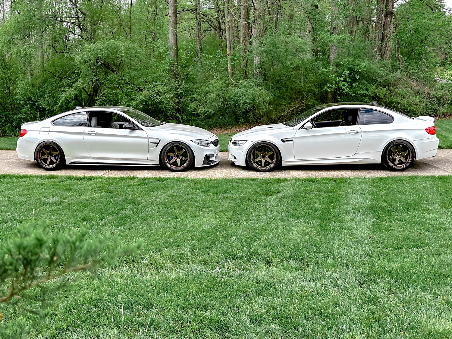

My M3 and M4:

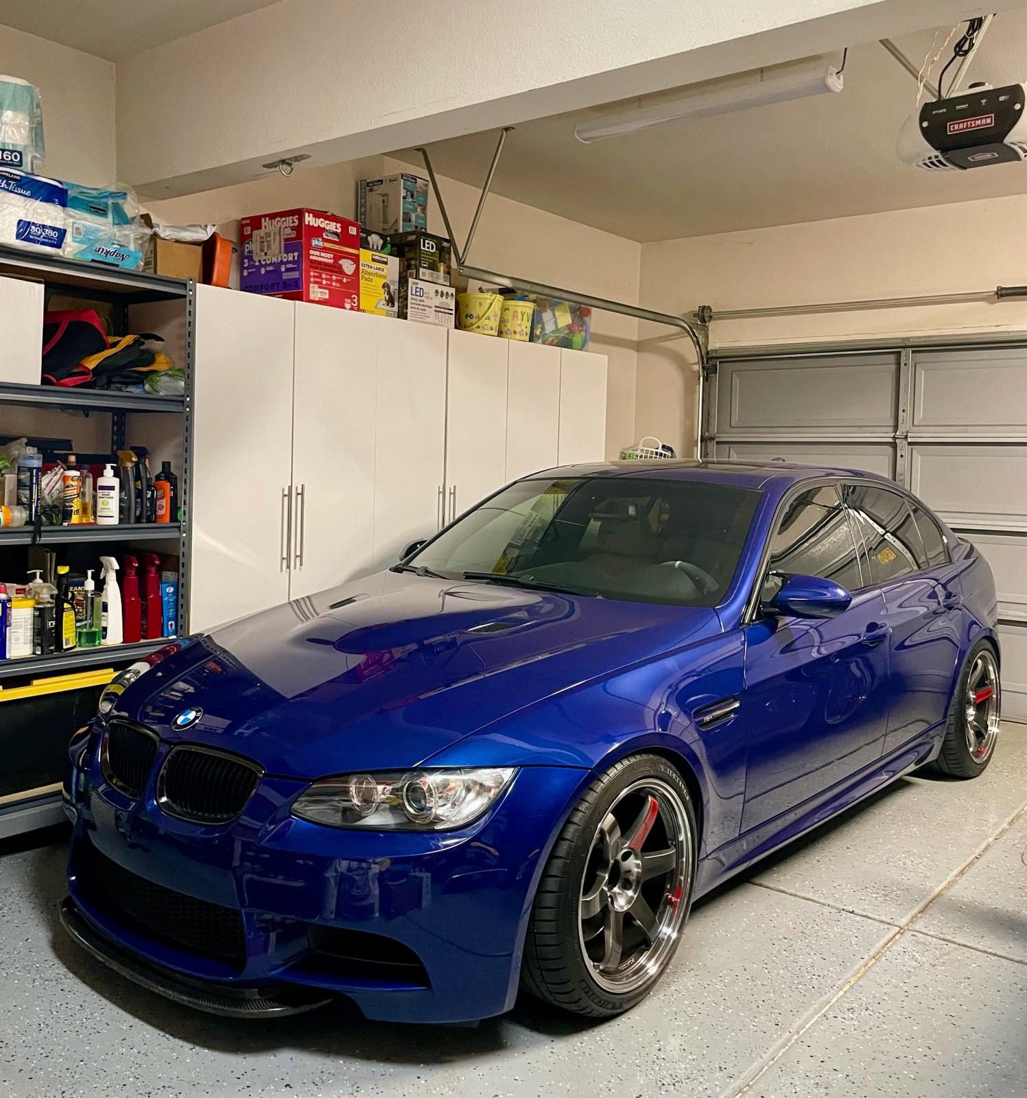

Sharing my set of 19x9.5 +21 and 19x10.5 +35 TEs. 265/285mm PS4S, 10mm spacer on rear of M4 and 15 mm spacer on rear of m3. 5mm front spacers on both cars.

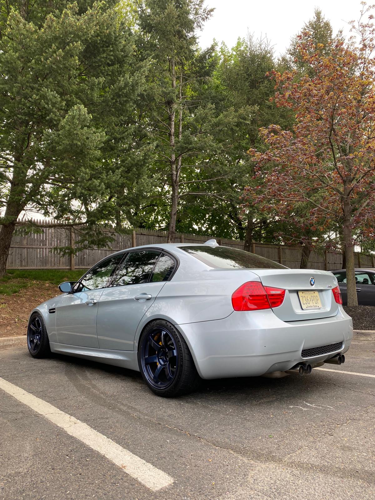

275/35/18 RT600 ON 18X10 SQ.. 5MM spacer upfront, 10MM out back

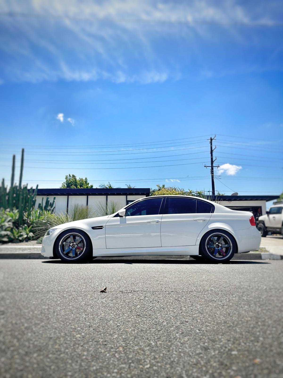

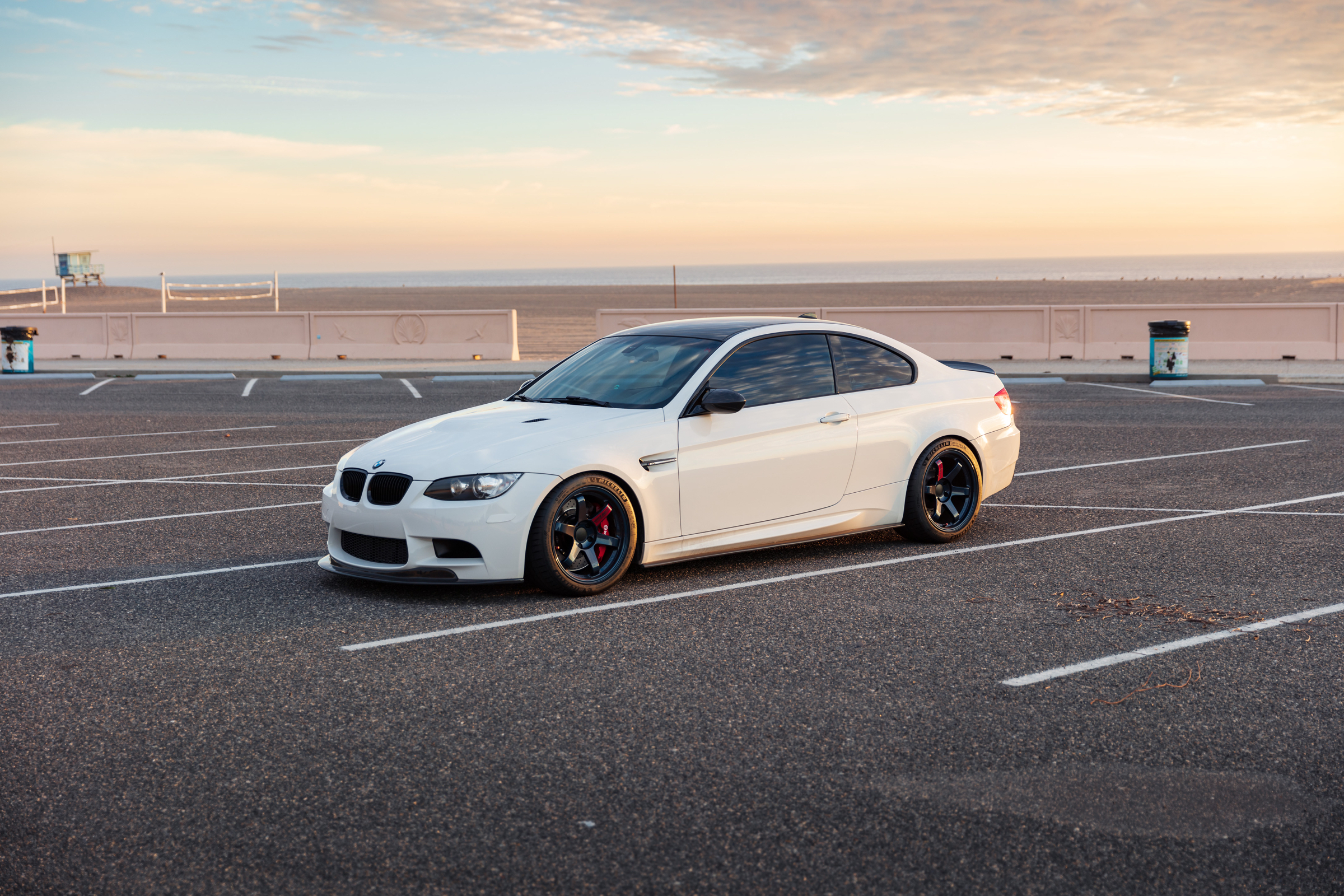

Back on TE's! The first picture is when my E92 was at its finest before I traded it in late 2017. I had put it back to stock and traded it in on an F80, however, I never grew to love the F80. Last year I was luckily able to find my exact car and buy it back. Unfortunately, It was in far rougher shape than when I owned it initially, but I've slowly been restoring it back to its former glory.
I could not for the life of me find 19" TE37SL's in pressed graphite so I decided to try them in blast bronze. Not sure how I feel about my sparkling graphite/bronze combo, but....it's a TE :)

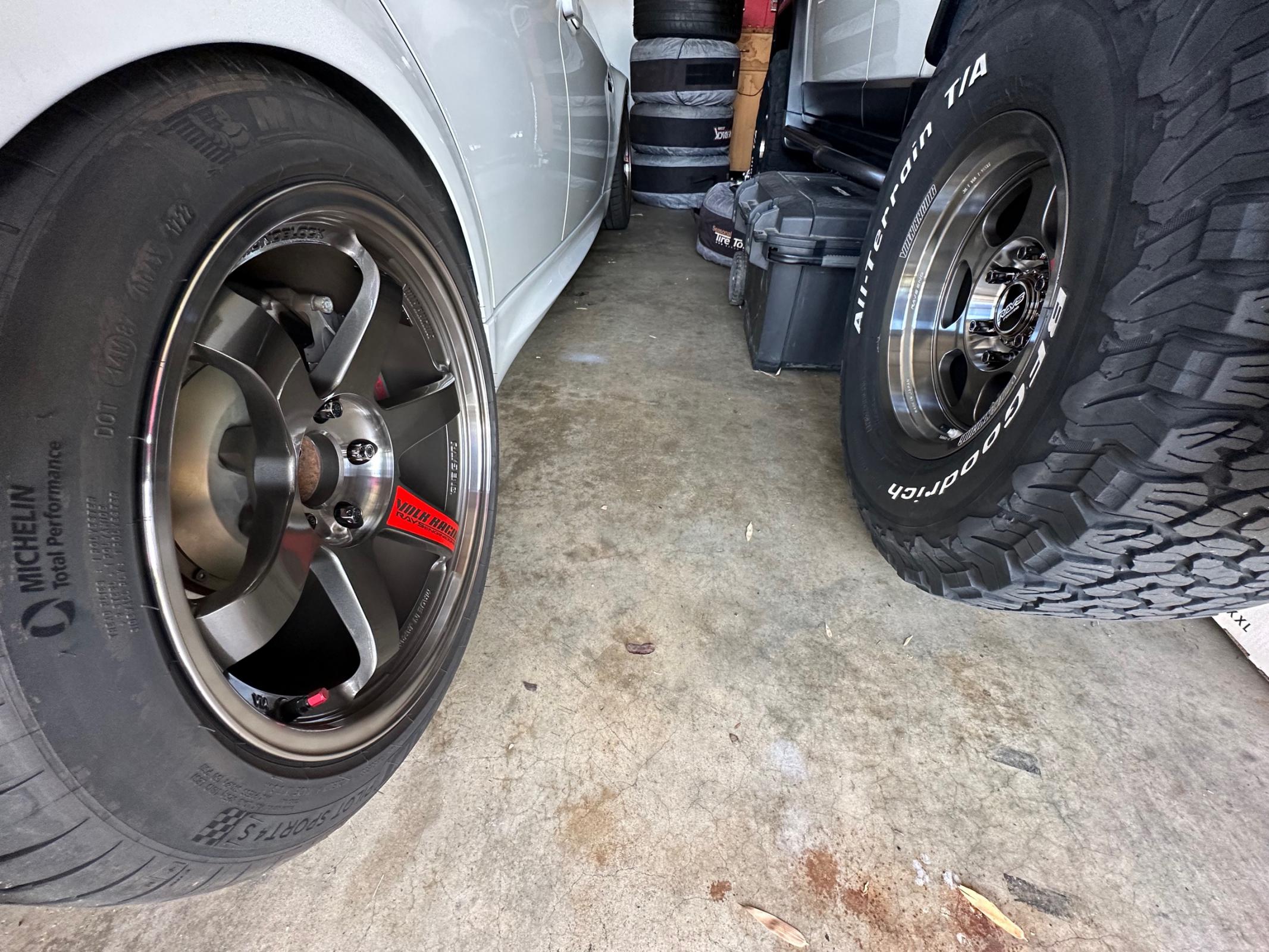

Finally TE’s on both my cars

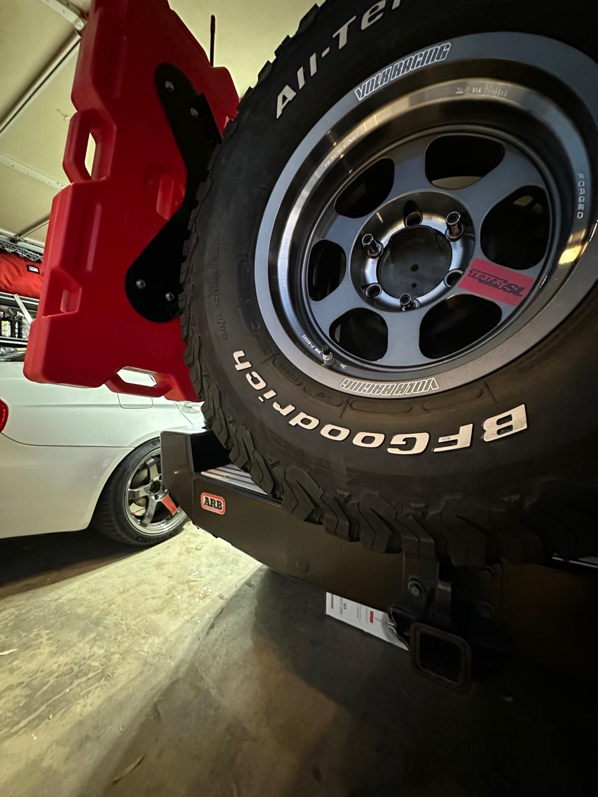

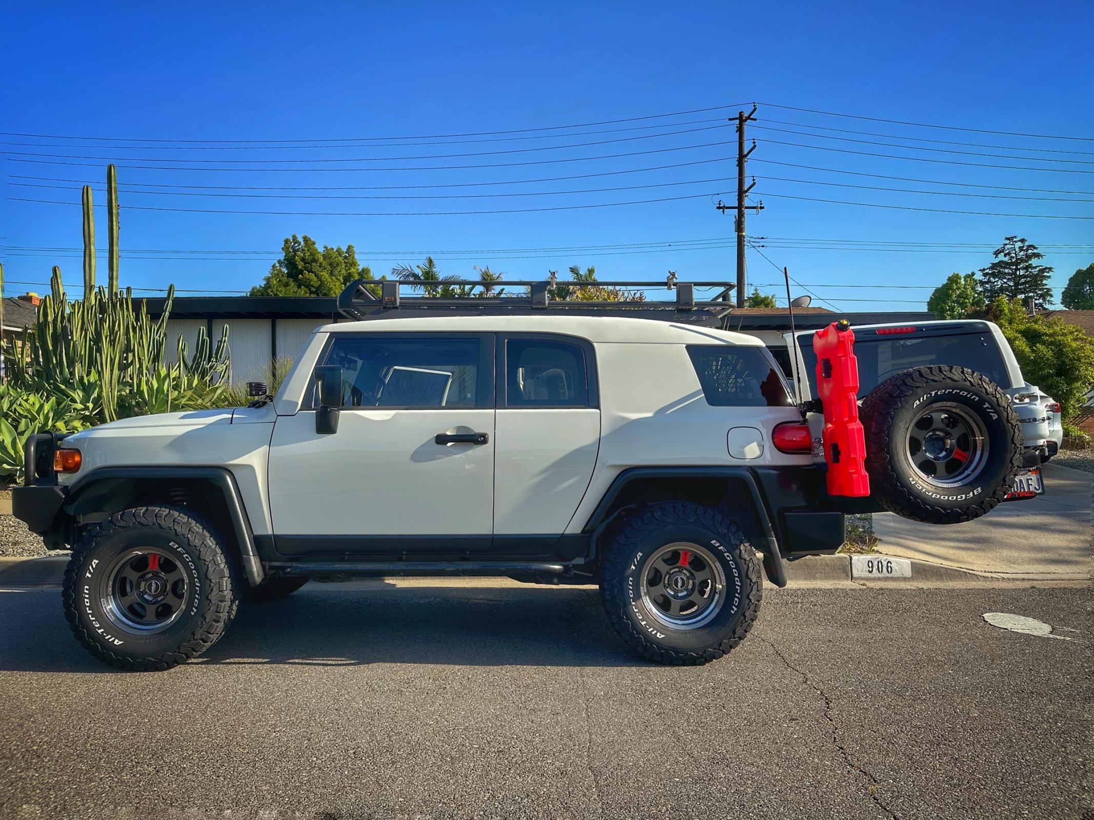

They both look great! I had an '08 TT FJ and to date, still one of the best vehicles I've ever owned. Would love to get matching TE's for my GX, but seeing how my current wheels look after a few trail days, there's no way

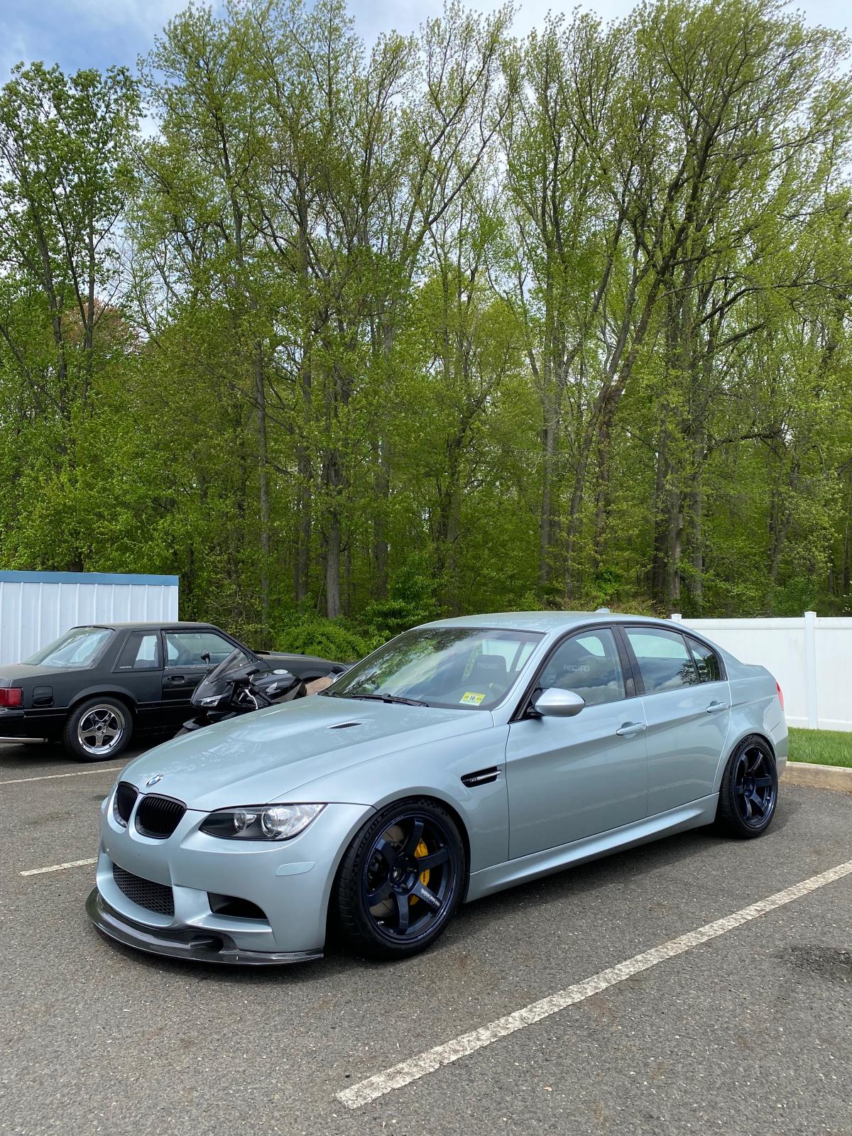

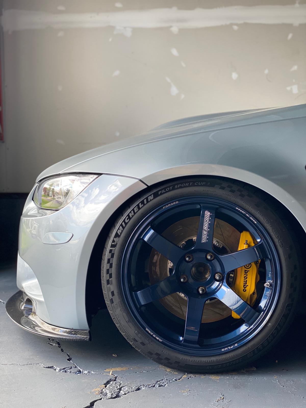

My contribution. Not sl but TE37 saga s-plus 18x10.5 et20 squared. Running Michelin Pilot Sport Cup 2 connect 265/35/18.

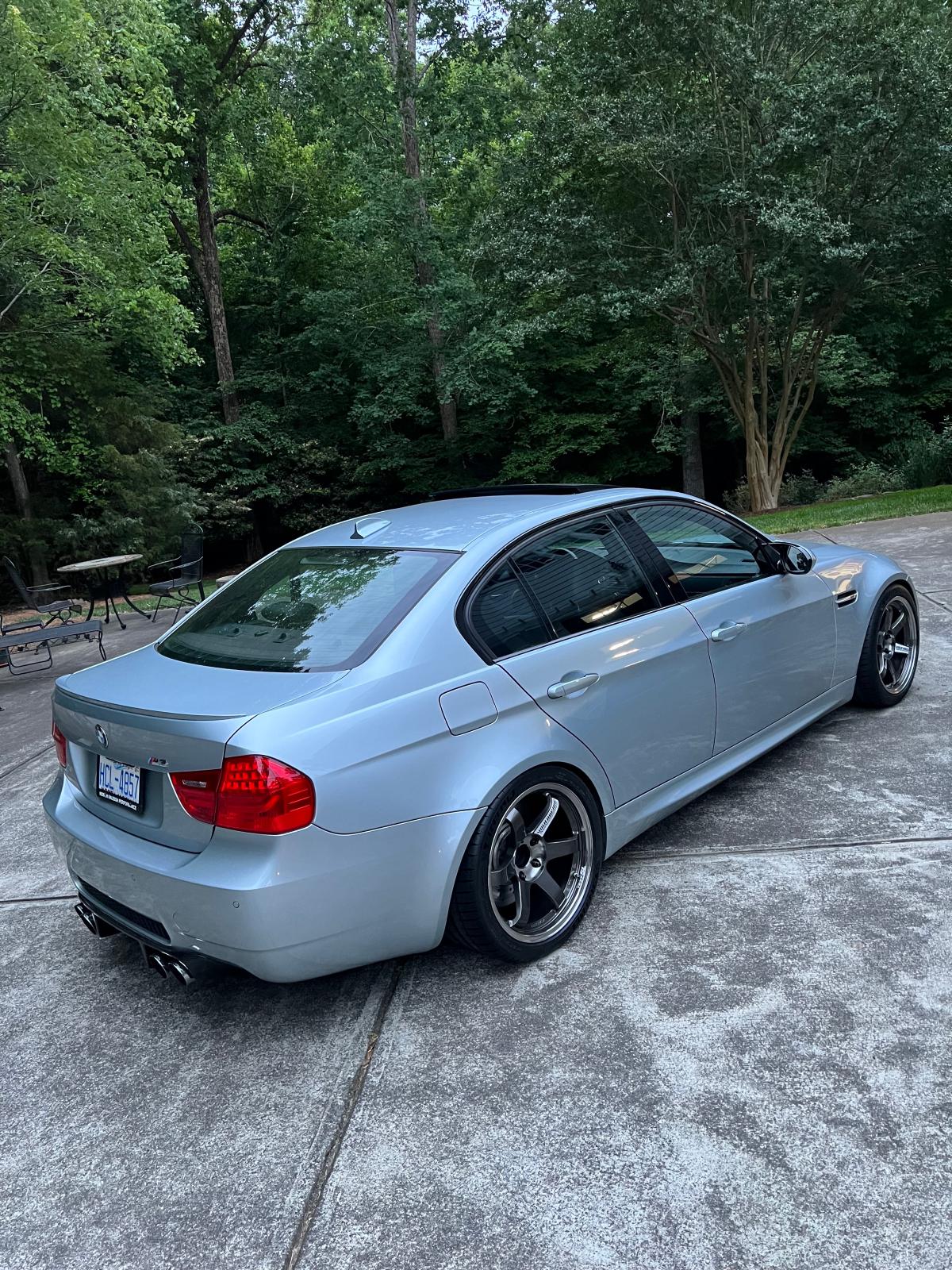

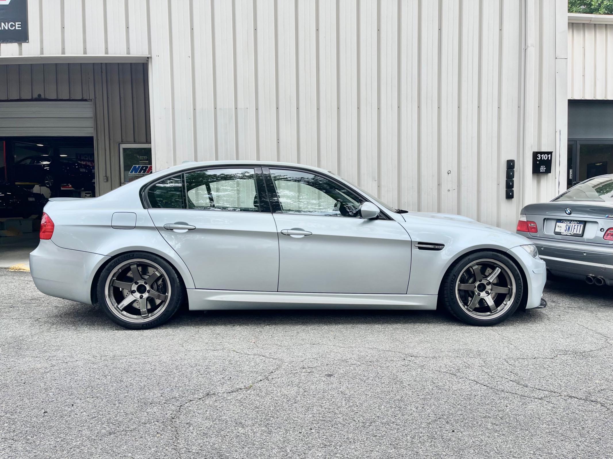

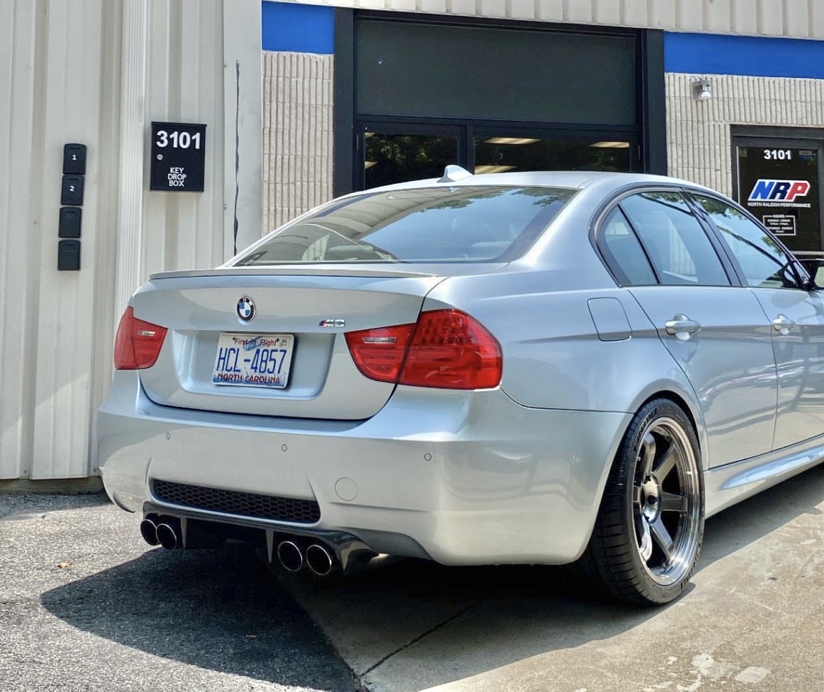

Will try to get some more pics but this is standard spec 18” SL’s, 18x9.5 ET 22 and 18x10.5 ET 20 in pressed graphite and ended up going 265/35 295/30 with ohlins. Conservative drop in the front for driveway clearance. Absolutely love the way the car drives with these over the 359’s. It’s as big of a difference as when I first went catless and tune.

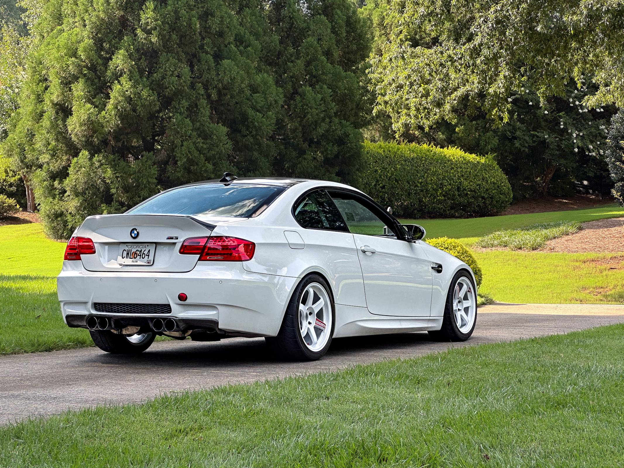

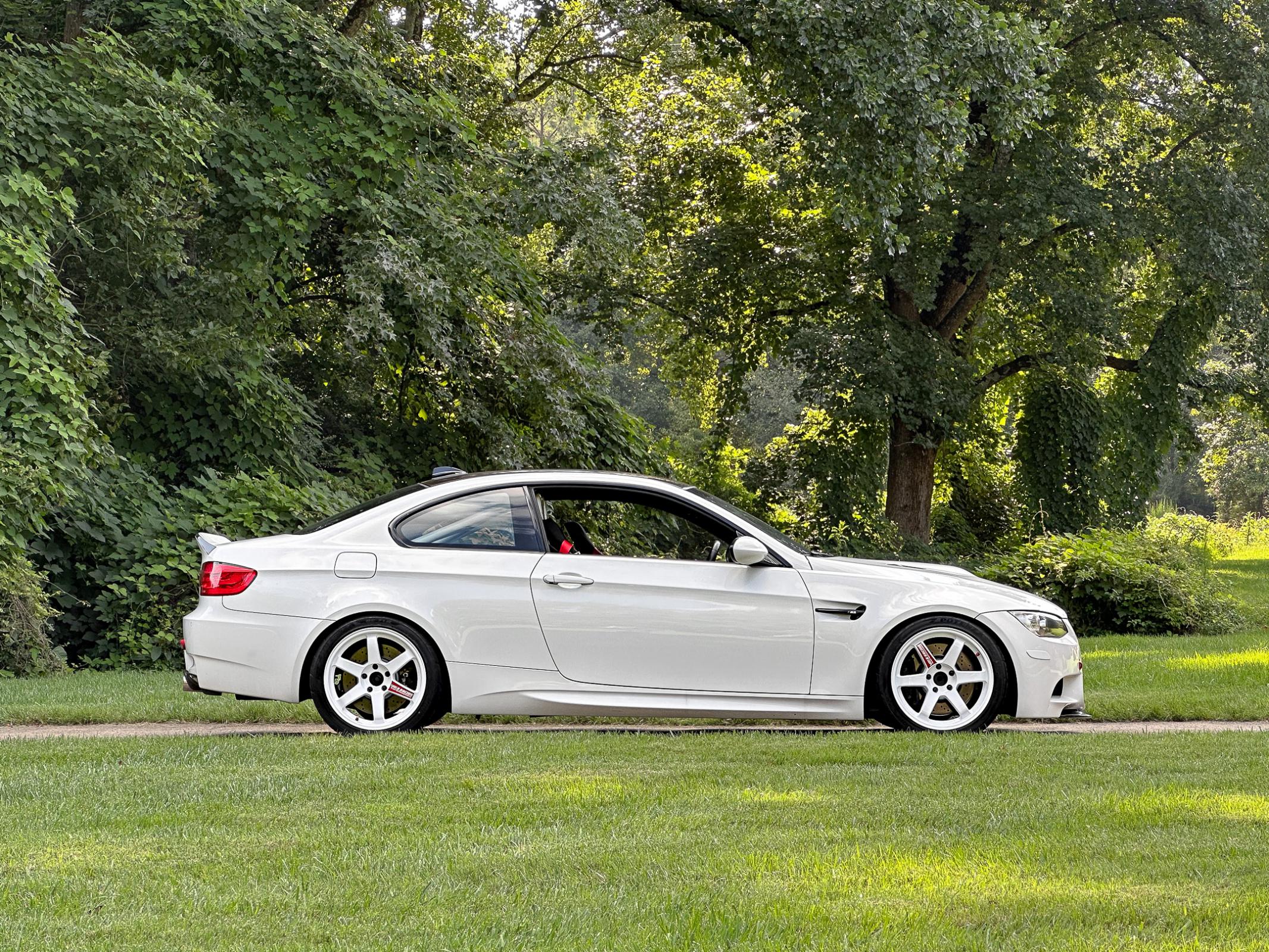

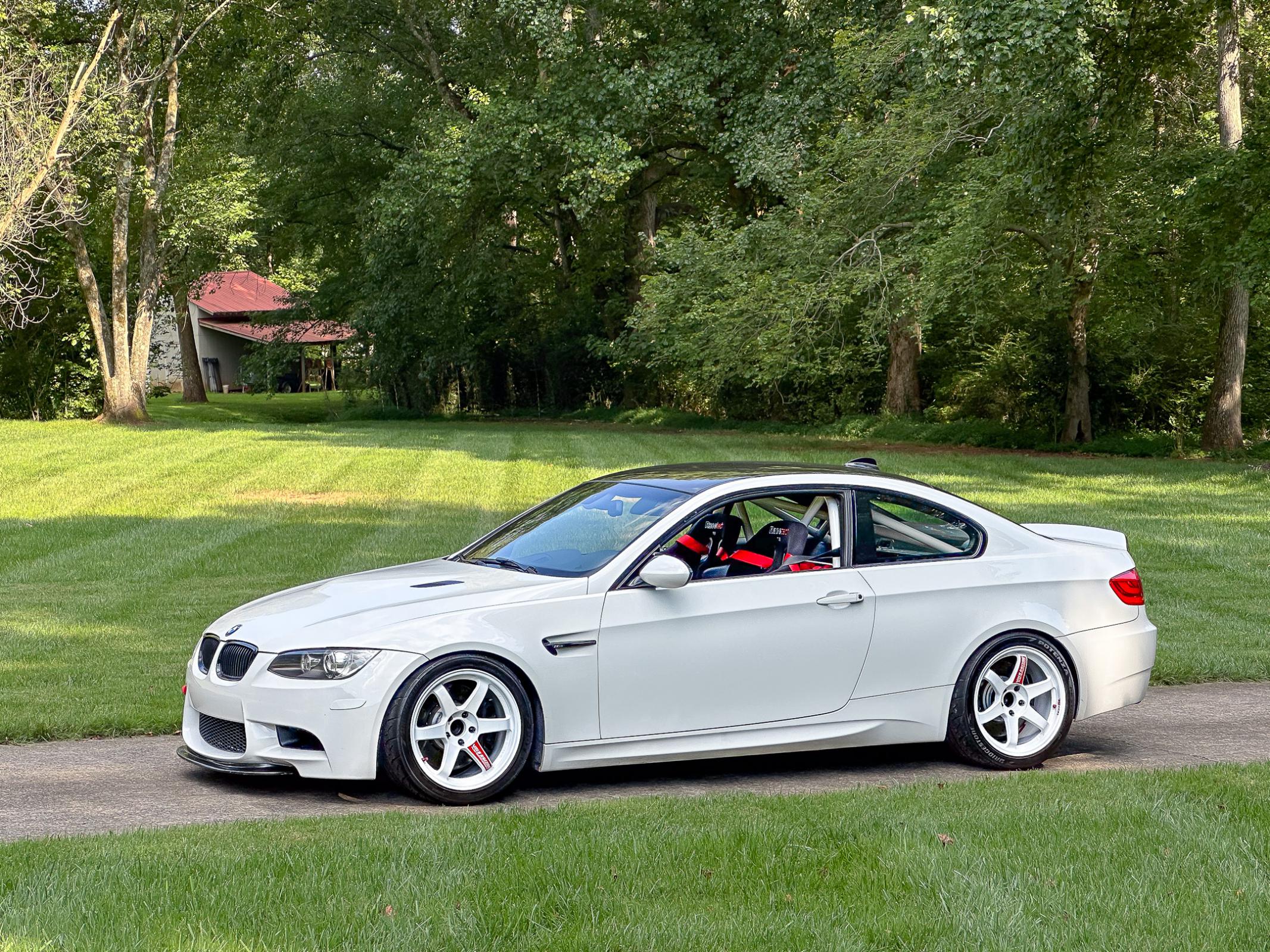

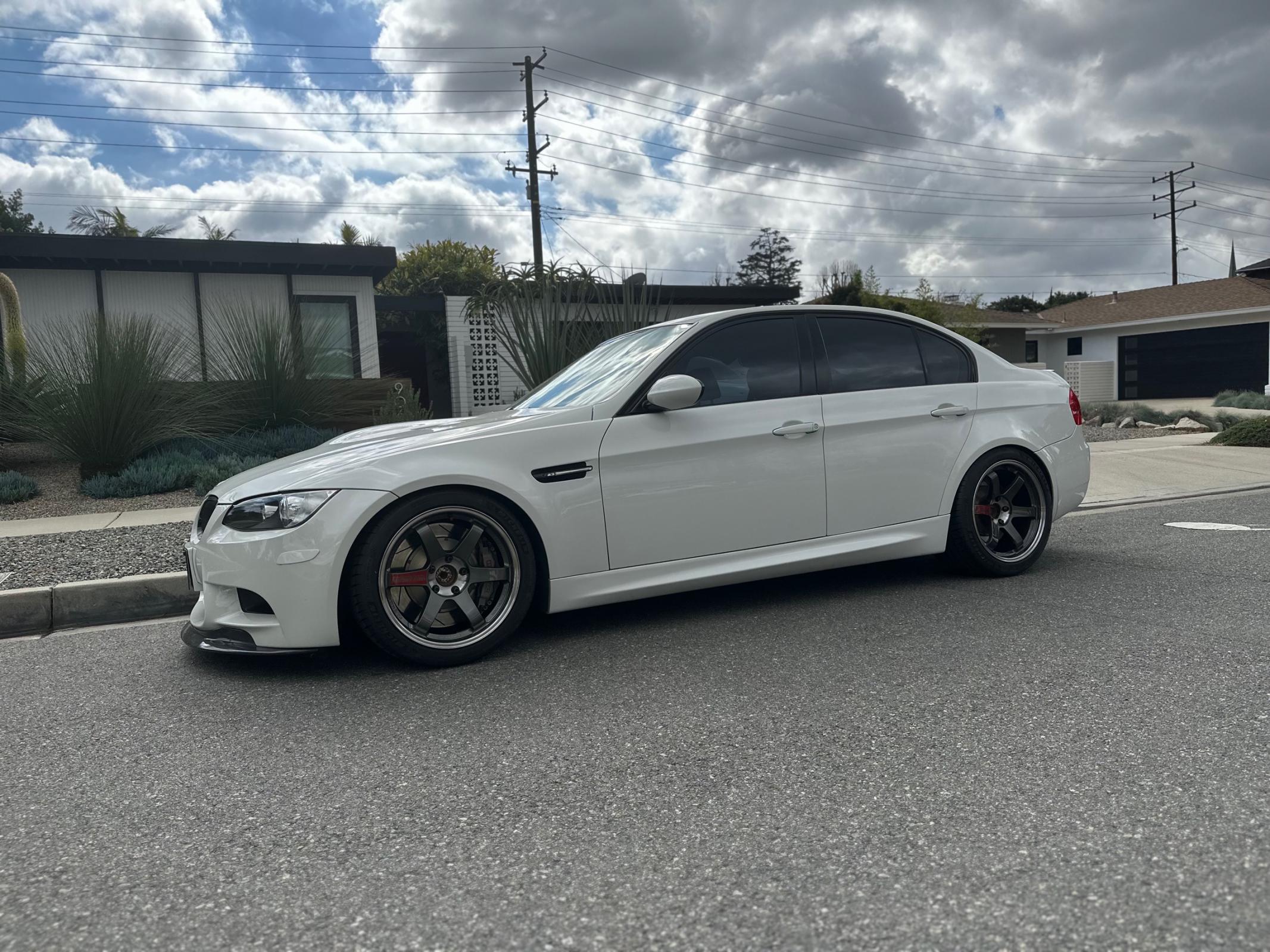

got some TEs for the E92 this weekend! It took me a long time to find 18x10 square in the Dash White color. Now both my M3 and M4 are looking proper!
M3 specs: TE37SL Dash White, 18x10" +25 offset with 5mm front spacer and 15 mm rear spacer, wrapped in 275/35-18 RE71R tires.
M4 specs TE37SL Blast Bronze, 19x9.5" +21 front, 19x10.5" +35 rear, 5mm front spacer, 12.5 mm rear spacer, 265/35-19, 285/35-19 PS4S tires
