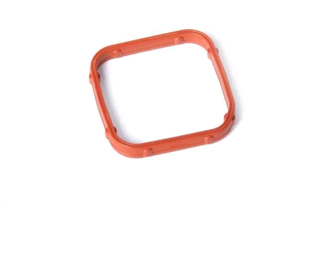

Found similar gasket
Originally Posted by feuer View Post
To my knowledge no.
Search on Google or eBay for...Thermostat Housing Seal - 2012-2018 Chevrolet Sonic - AC Delco
https://www.ebay.com/itm/For-2012-20...-127632-2357-0
feuer4319.50

Also found this
Going to try this one and see if it works

      02-09-2022, 01:48 PM   #60
Shanemac
11
Drives: E34 E83
Join Date: Jan 2022
Location: NY
Originally Posted by david in germany View Post
And? How are the measurements?
Jus tried it out and unfortunately it's too big and too thick by about 3mm. I had a spare round gasket like the picture above that I was able to make it work.
I just came to post the same result lol, rolled the dice. $9 on Amazon prime figured why not hah.
I’m ordering the other o ring others have been using. Crazy BMW don’t have this part.
