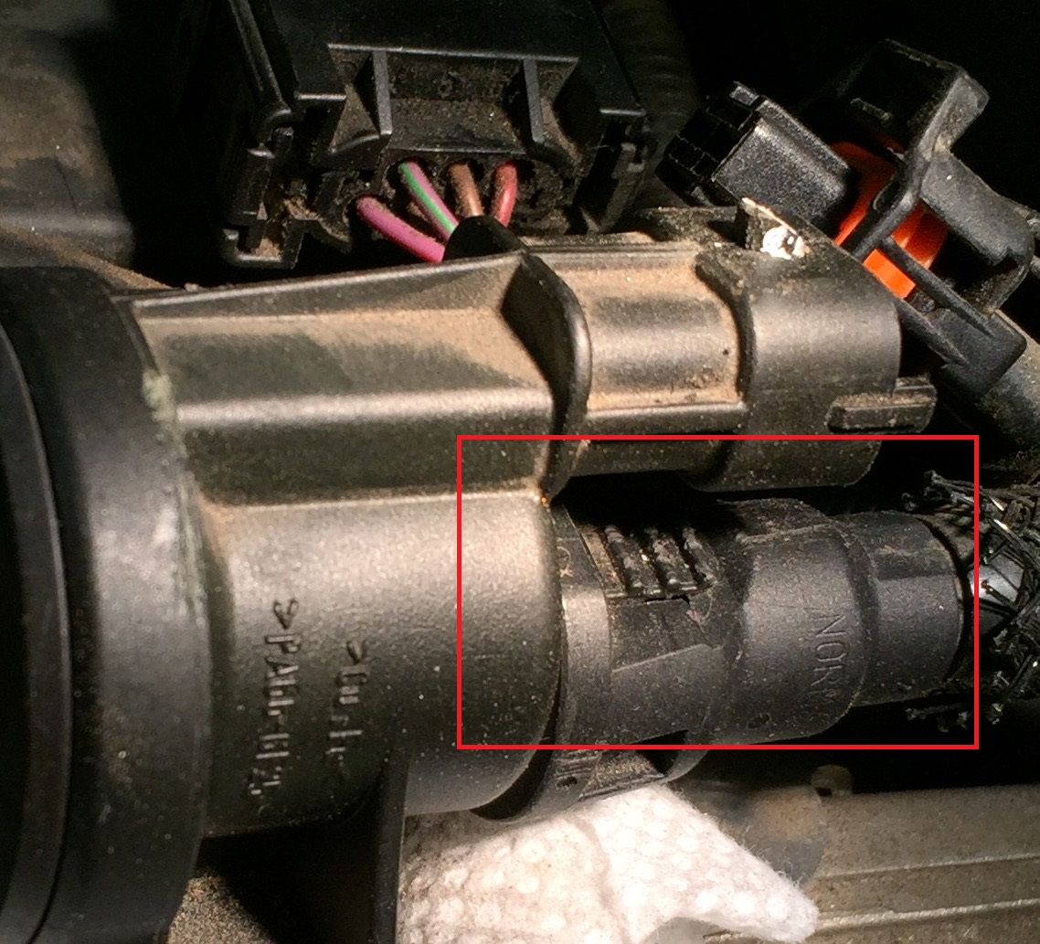

-Unplug the rear hose by pressing in on both sides of the quick connector and pulling back toward the rear of the car. This hose is difficult to remove, but pushing in toward the valve before you press the two sides and pull it off may help in the removal.
Image hosted on: i32.photobucket.com

How do unplug this one? -Unplug the rear hose by pressing in on both sides of the quick connector and pulling back toward the rear of the car
HELP!! I'm stuck with my manifold off. Can't get this fuel connector off. What's the secret to getting it off. Afraid to break it if I pull too hard
Thanks for the write up. Will have to give this a try once I have more time.
I replied to your pm this morning. sorry for the delay. did you ever get it off? when I pulled mine off it sort of popped off and I had to pull fairly hard while squeezing the two sides. I thought I broke it at first but all was well and it snapped right onto the new valve just fine.
maybe try twisting and pulling as you squeeze the two sides? it will come off and shouldnt break. let us know when you get it.
Thanks. I will try again this morning.
Alls well that ends well. So I got so frustrated at one point I broke off the the Valve nipple and was lodged in the connector. Called a mobile mechanic and he removed the pipe off the car so we could pull the stuck piece out. I held the two teeth up and he pulled on the stuck piece. Afters a couple tries it slid out. Was a huge relief when that happened. Put the pipe back on the car. Then the front rubber hose had to come off the valve. That he took care of for me but it wasn't easy. He did ask why I cut the clamp off because he said he had a tool to take it off and reuse it.
He helped me put everything back on and the car started like normal. Very happy with his work. Did not want to tow to my Indy and have them preach to me about why to leave it up to the experts. The mobile mechanic was very nice and said at least you tried and learned something.
Anyways bottom line, my opinion is to not underestimate the difficulty on removing the front and back fuel lines. They are hard to take off. Just be warned. Looking back on it, getting to the valve was standard wrenching. Trying to get the valve out was probably beyond my comfort/skill level. Hope this helps.
Sorry you had a bad experience but glad it all ended well. The lines were certainly difficult to remove but mine didnt give me even a fraction of the trouble yours did. Yours must have been stuck on extra tight.
thanks for sharing your experience. I still recommend people try this for themselves if they feel comfortable but you have to know your limits.
A couple suggestions for others that do this job. The tube that connects to the back of the valve can be lifted around the back of the valve cover to give some slack. The valve can be pulled off the bracket to get better access to the fitting. Alternatively the other end of the tube looked to have connectors similar to those on the plenum. If you disconnect that end one could remove the front hose and work on that connector outside the car.
I asked a BMW tech how they deal with these. He mentioned that pushing in on the whole fitting (towards the valve) prior to pushing in the tabs. He also called them 'difficult'.
Now that you mention it I vaguely remember having to push the hose in toward the valve and squeezing the tabs then pulling back. I only thought of it because you mentioned it. thanks for the input. that should help out a lot and I'll edit the main post.
Thanks!!!
