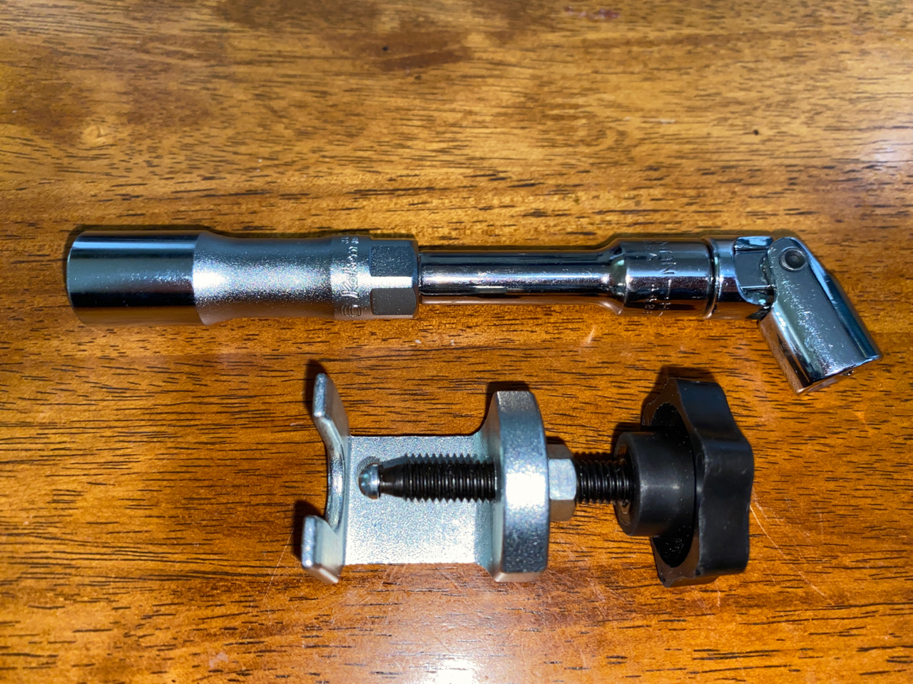

I bought a windshield wiper puller from Amazon as suggested and a couple minutes with a grinder gave me an adequate coil puller. Coupled with a KoKen spark plug socket and I managed to get the job done.

OTC 4676 Windshield Wiper Puller https://a.co/d/a2i7ocY
Keep in mind you will have to thin the arms down a little with a file or grinder. I think I took about a millimeter off
Keep in mind you will have to thin the arms down a little with a file or grinder. I think I took a out a millimeter off
Right on! Thanks.
