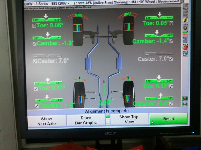

Just had my alignment done after installing Moton Street Sports. I had the care lowered roughly 1/2" all the way around, and corner balanced. I have to have the cross weights sent to me still.
Front Camber
Left -2.2 Right -2.3
Total toe in is 1.0mm(they gave me some toe in on the front)
Rear Camber
Left -2.1 Right -2.1
Total toe in is 3.0mm
Car turns in beautifully.

Camber:
Front: -3º left, -3.1º right
Rear: -1.9º left, -1.9º right
Toe:
Front: .12º left, .11º right
Rear: .11º left, .14º right
Stock ZCP suspension w Ground Control camber plates. Once I'm more accustomed to my setup, thinking of reducing the rear toe.
